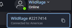

Administrators Netduma Fraser Posted December 20, 2025 Administrators Posted December 20, 2025 It looks like you're in the UK but trying to connect to the Americas on Battle.net, do you get the same issue when selecting EU?
18RayF Posted December 21, 2025 Author Posted December 21, 2025 So I’m always in EU but it shows that for some reason not sure why

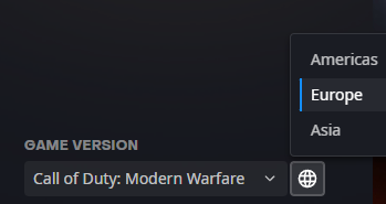

Administrators Netduma Fraser Posted December 21, 2025 Administrators Posted December 21, 2025 Okay so when you play a game and the little globe icon here, you have that set to Europe?
