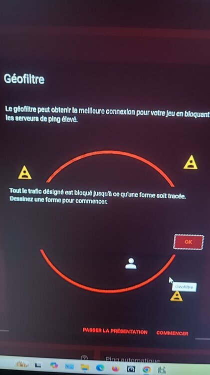

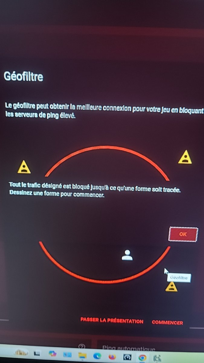

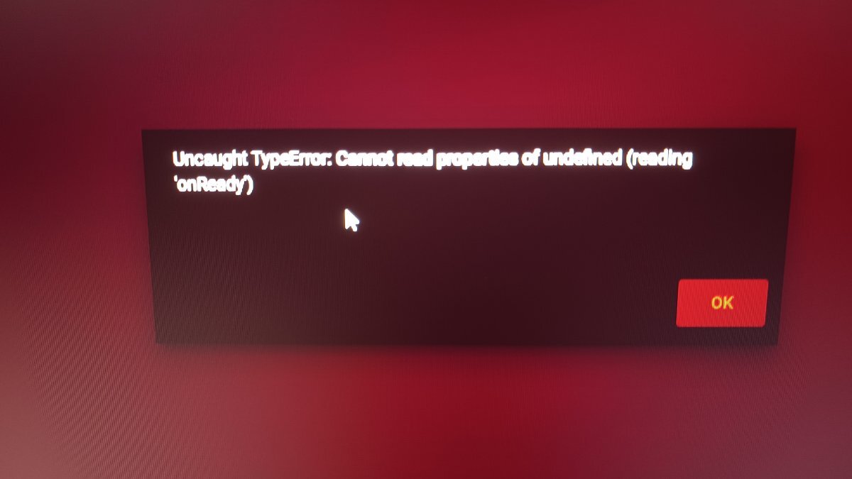

rash Posted November 24 Posted November 24 Hi, I have an issue with my XR1000 where the Geo-Filter is not showing any servers, and the Ping Heatmap is not working at all. I restarted the router, did a factory reset, changed browsers, and disabled Auto-Ping Assist, but the problem is still there. What is the solu tion?
