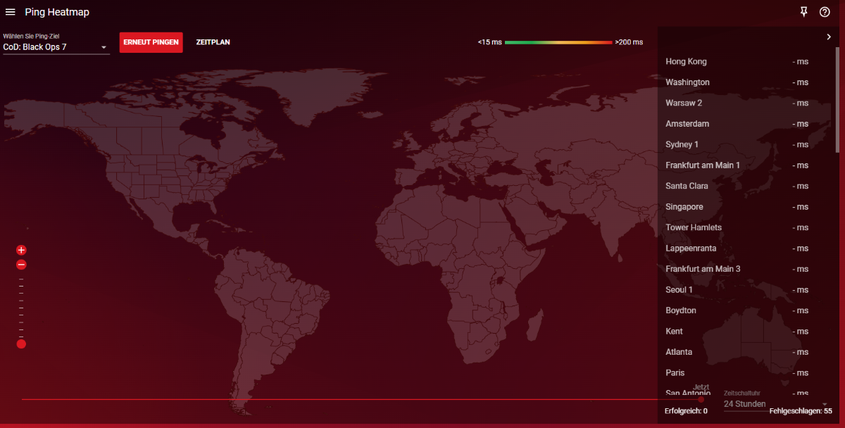

Cemo99 Posted November 20, 2025 Posted November 20, 2025 44 minutes ago, Netduma Fraser said: To force servers you need to do the following: It's essential the Geo-Filter is enabled before the game client (e.g. Steam etc) if on PC or platform (e.g. Xbox, PlayStation) or the game have been launched. If you change Geo-Filter settings when you're on the game then you will need to restart the game for those changes to take effect, otherwise it will use the previous Geo-Filter settings and appear not to be working. For settings ensure Ping Assist and Geo-Latency are disabled in the Geo-Filter menu that can be found by clicking ⋮ in the top right hand corner of the page and go to Settings. Strict Mode should also be enabled, it is enabled by default so if you haven't disabled it you can ignore it. If you have disabled it or want to check it can be found in the same Settings menu as above or in Settings > Troubleshooting > Advanced > Developer Options depending on your firmware version. Fast Search should also be disabled which it is by default so can be ignored if you haven't changed it, otherwise this can be found in the same place. Still not working also all ping are showing as -ms Regards

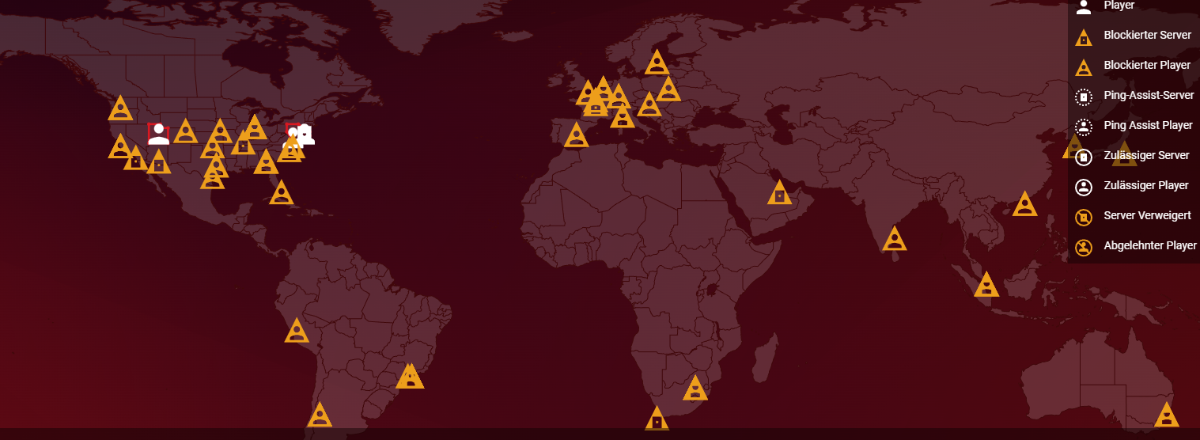

Administrators Netduma Fraser Posted November 20, 2025 Administrators Posted November 20, 2025 16 minutes ago, Cemo99 said: Still not working also all ping are showing as -ms Regards That's Ping Heatmap not the Geo-Filter, show a screenshot of what you see when getting a game outside your radius please
Administrators Netduma Fraser Posted November 20, 2025 Administrators Posted November 20, 2025 47 minutes ago, Cemo99 said: Made pictures of both That looks fine, that's when you load up the game but can you show what happens when you actually play and connect to one outside your radius please?
