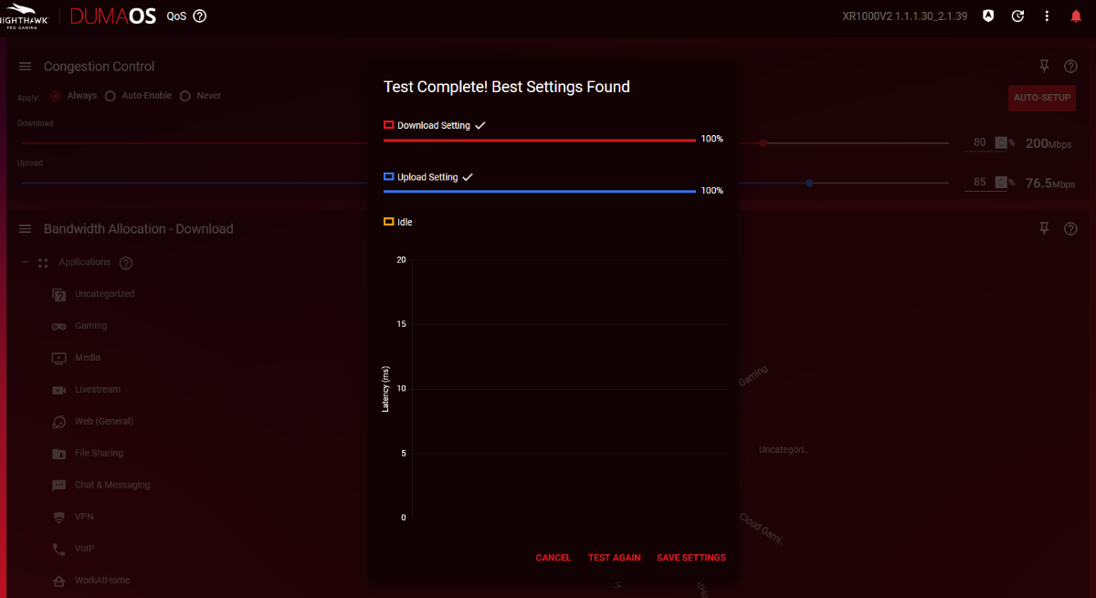

int1zando Posted November 17 Author Posted November 17 Hi Fraser, I just changed my ISP and already getting much better control and speed. However, I can not get the Congestion Control to run Auto-Set up (I can and have set it manually), but when I run the auto-set up, no matter which advanced controls I use (even the basic ones, even after rebooting the router) I just get "Test Complete! Best Settings Found" straight away and it leaves the Download/Upload at 100% saying its optimal (which its not). You can see my router version top right, and my own found optimal settings in the background. Even if I set the sliders to 100% and try run auto it gives same result. changing spikes to <10ms, <20ms, 5<ms yields the same result. minimum <50%, or <30%, or 80% yields the same result. ping target is left default at 5%. Looks like the test is not even running.
Administrators Netduma Fraser Posted November 17 Administrators Posted November 17 Good to hear! The test server it uses is hardcoded onto the router and so can't be updated via the cloud so unfortunately that server is not always available so I would recommend doing what you have been doing and setting manually
