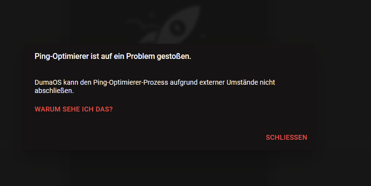

NetdumaR3help Posted Thursday at 01:51 PM Posted Thursday at 01:51 PM Habe seit Dienstag Glasfaser mit dem Selben Router wie auch davor ,fritzbox 7590 hab jetzt statt 100mbits 1gbit muss ich netduma r3 neu einrichten? Paing optimieren bekomme ich immer eine fehlermeldung
Administrators Netduma Fraser Posted Thursday at 03:13 PM Administrators Posted Thursday at 03:13 PM You don't need to set it up again, just enter your new speeds in manually. We're aware Ping Optimizer isn't 100% reliable currently and we're looking to fix that for the next version. In the meantime you can adjust Congestion Control manually to achieve the same effect which can be found in Ping Optimizer > Advanced.

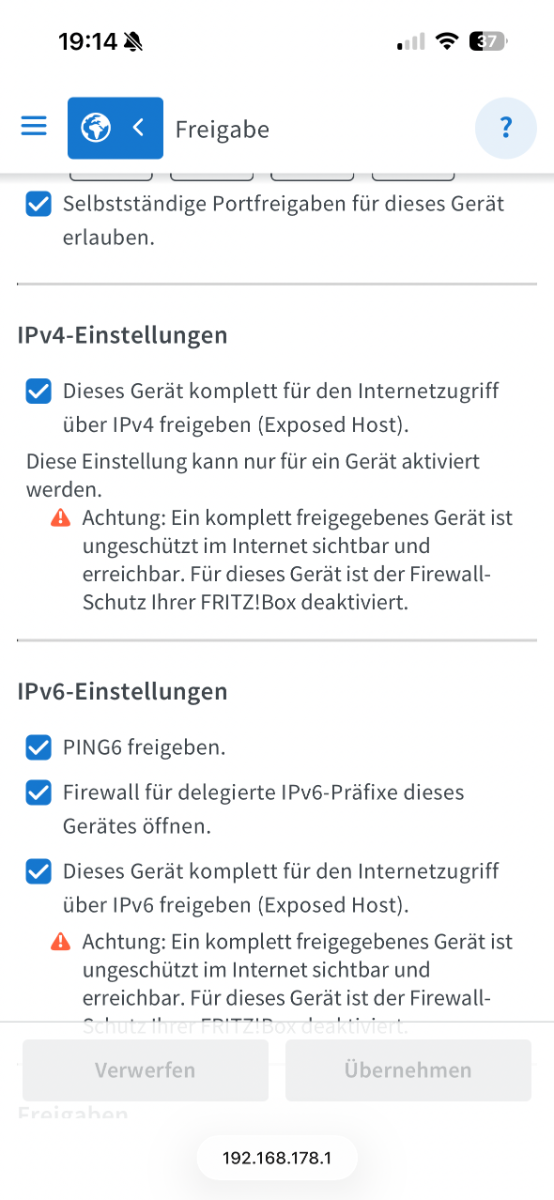

Administrators Netduma Fraser Posted Thursday at 03:52 PM Administrators Posted Thursday at 03:52 PM No, you can change your speeds at the bottom left of the interface - Speed Test > Advanced You don't need to port forward but if you can enable the exposed host option for the R3 on the fritz that would be best NetdumaR3help 1
NetdumaR3help Posted Thursday at 04:07 PM Author Posted Thursday at 04:07 PM Kannst du mir erklären wie ich das mache ? Exposed Host ?
Administrators Netduma Fraser Posted Thursday at 04:34 PM Administrators Posted Thursday at 04:34 PM This should explain it https://uk.fritz.com/service/knowledge-base/dok/FRITZ-Box-7490/131_Setting-up-an-exposed-host-in-the-FRITZ-Box

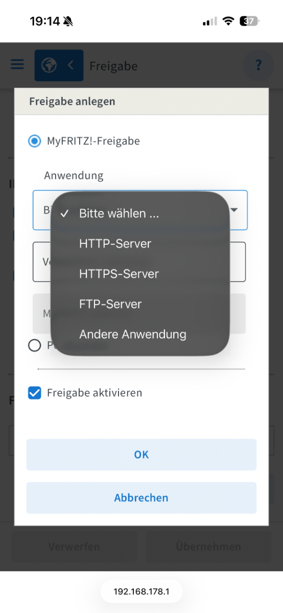

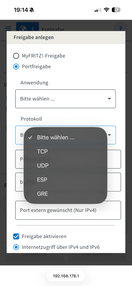

NetdumaR3help Posted Thursday at 06:16 PM Author Posted Thursday at 06:16 PM Ja es war sehr hilfreich aber hätte tatsächlich noch 2-3 offene Punkte muss bei Bild 1 alles angewählt sein ? und was soll ich bei 2-3 anwählen auf den link ist es nicht so genau erklärt .
Administrators Netduma Fraser Posted Thursday at 06:32 PM Administrators Posted Thursday at 06:32 PM The first screenshot that appears to be all correct, you don't need to change anything. I'm not sure what the others are for but you shouldn't need to change them, just what the article mentions that's all
