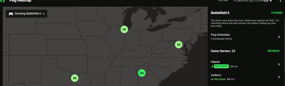

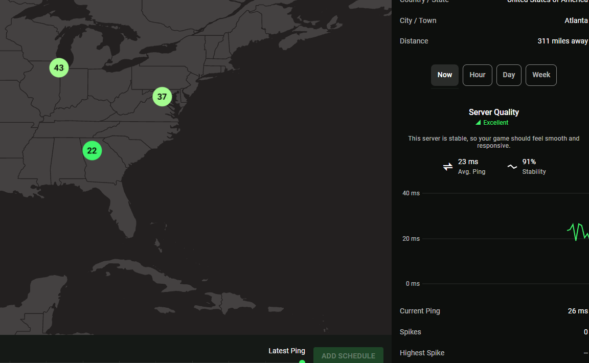

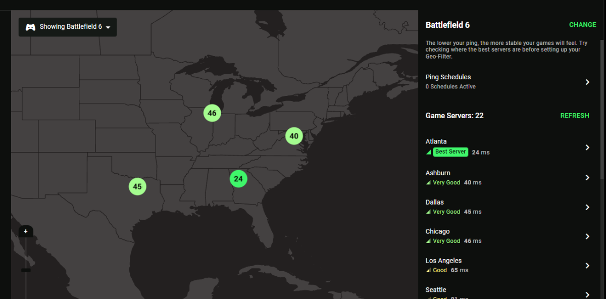

Tru ELiTE Posted October 22 Posted October 22 On my Ping Heat Map the router sees the ATL server, but when searching for a match the ATL server is not seen. Also, the middle server always available regardless of the settings.
Administrators Netduma Fraser Posted October 23 Administrators Posted October 23 We're working on some cloud updates currently specifically for BF6 so this will be improved upon and should be more accurate overall. Once done they'll be pushed to your router automatically, you don't have to do anything Tru ELiTE 1
Administrators Netduma Fraser Posted November 2 Administrators Posted November 2 24 minutes ago, Tru ELiTE said: has this been updated? As far as I am aware it was done, have you noticed a difference?

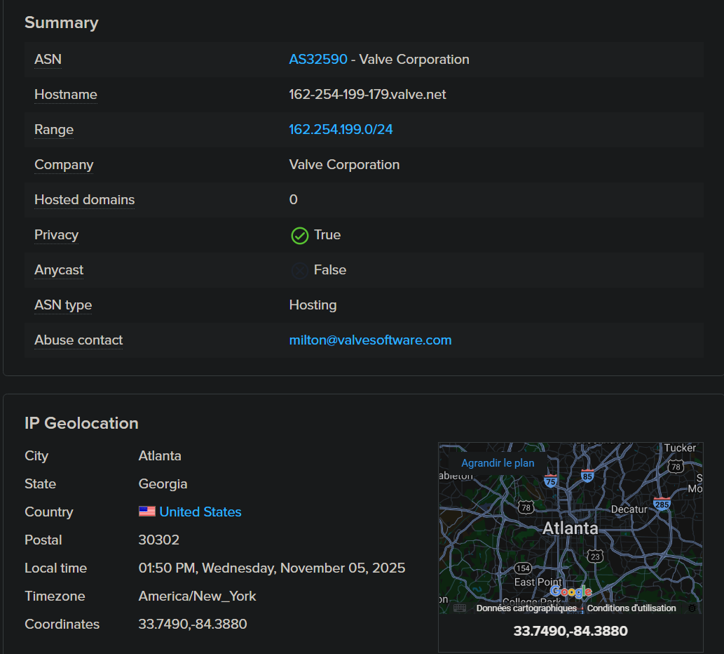

Tru ELiTE Posted November 6 Author Posted November 6 since privacy is true. thats why i cant connect to it or see it ?

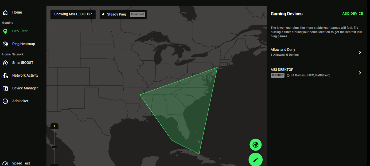

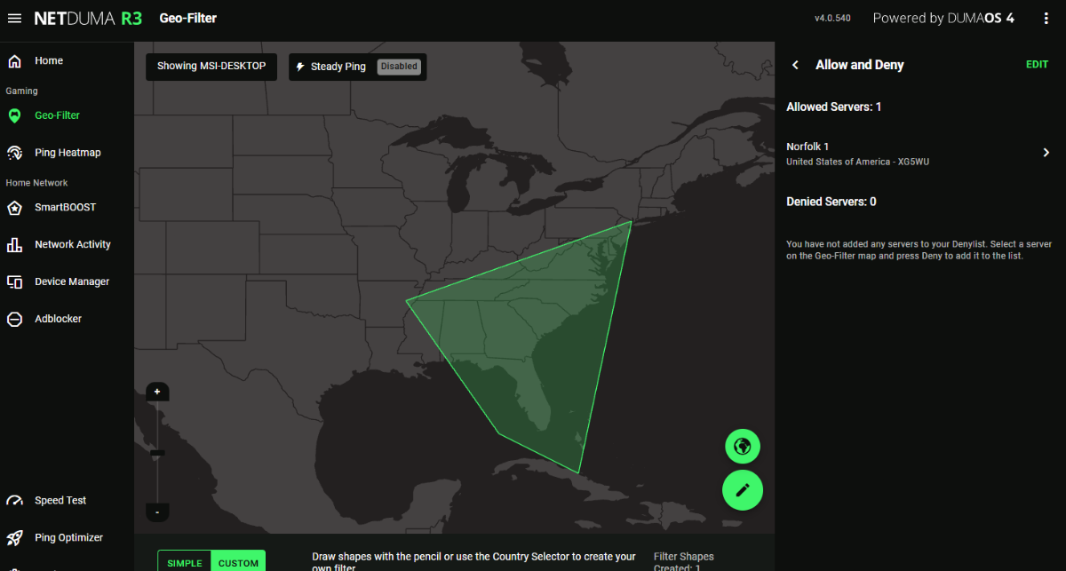

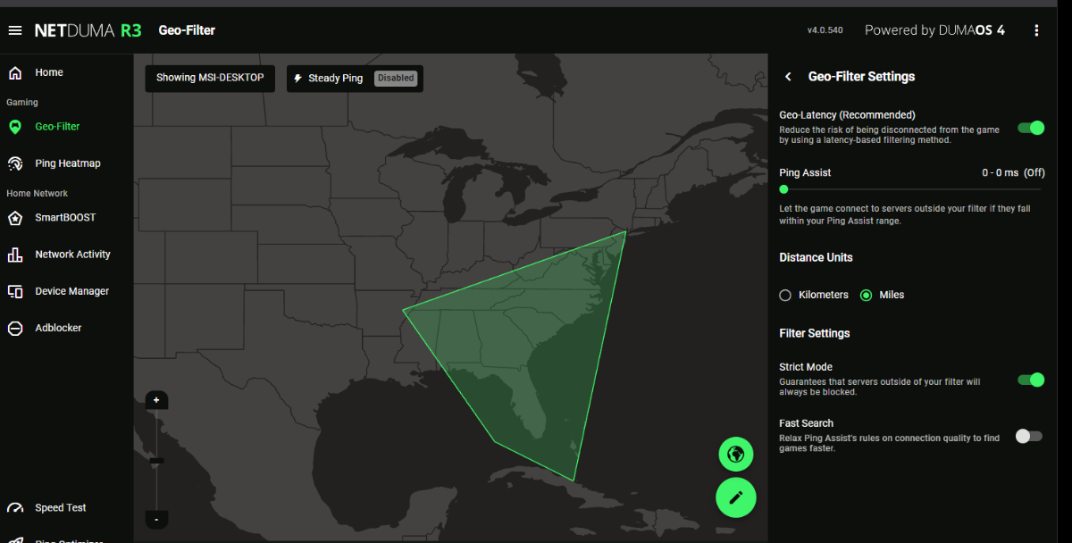

Administrators Netduma Fraser Posted November 6 Administrators Posted November 6 On 11/5/2025 at 1:54 AM, Tru ELiTE said: no still cant get the atl server If they're taking the above from the IP used for Heatmap that's just to ensure more long term reliability of Heatmap showing servers, it's not the specific server but represents where there is an available server for the game and your approximate ping to it. Based on your screenshots you actually have filtering disabled which would indicate the reason you're unable to force that server.

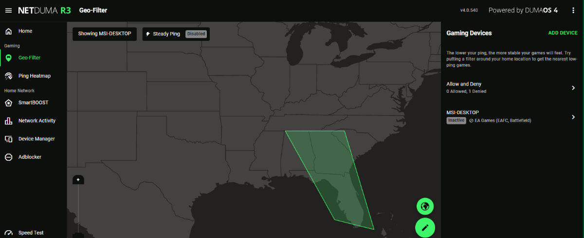

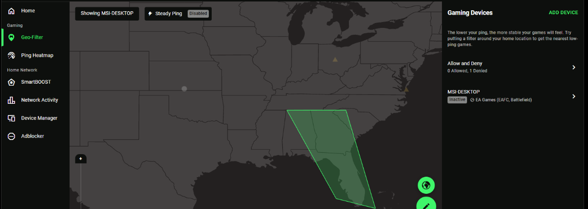

Tru ELiTE Posted November 7 Author Posted November 7 ping heatmap geo-filter section an east coast server that i allowed geo filter settings is there something i need to change??????????????????

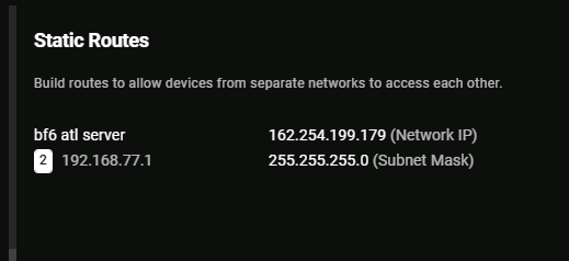

Tru ELiTE Posted November 7 Author Posted November 7 with the server ip mentioned above, i simply created a static route to it.
Administrators Netduma Fraser Posted November 7 Administrators Posted November 7 Do this and it will likely work better Quit the application/game/client completely - including the game client from the System Tray - important! Remove device from the Geo-Filter If you're on PC then give it the PlayStation Device Type in the Device Manager Resync from the Geo-Filter Map menu Re-add the device to the Geo-Filter Set up the Geo-Filter how you like Wait 2 minutes Boot up application/game/clientIt's essential the Geo-Filter is enabled before the game client or the game have been launched. If you change Geo-Filter settings when you're on the game then you will need to restart the game for those changes to take effect, otherwise it will use the previous Geo-Filter settings and appear not to be working. To force servers you need to do the following: For settings ensure Ping Assist and Geo-Latency are disabled in the Geo-Filter menu that can be found by clicking ⋮ in the top right hand corner of the page and go to Settings. Strict Mode should also be enabled, it is enabled by default so if you haven't disabled it you can ignore it. If you have disabled it or want to check it can be found in the same Settings menu as above or in Settings > Troubleshooting > Advanced > Developer Options depending on your firmware version. Fast Search should also be disabled which it is by default so can be ignored if you haven't changed it, otherwise this can be found in the same place.
