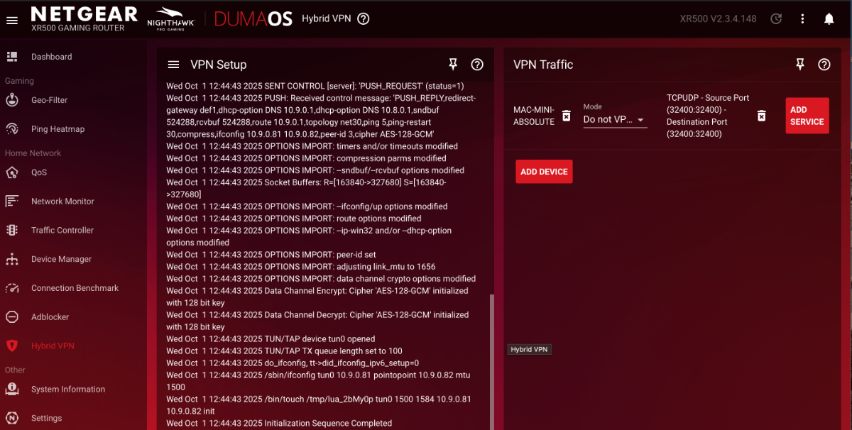

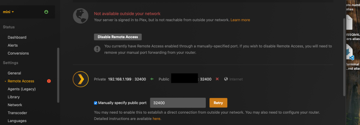

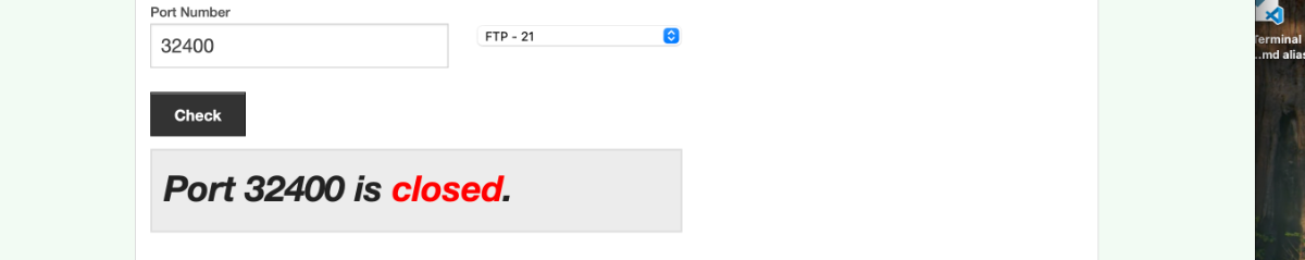

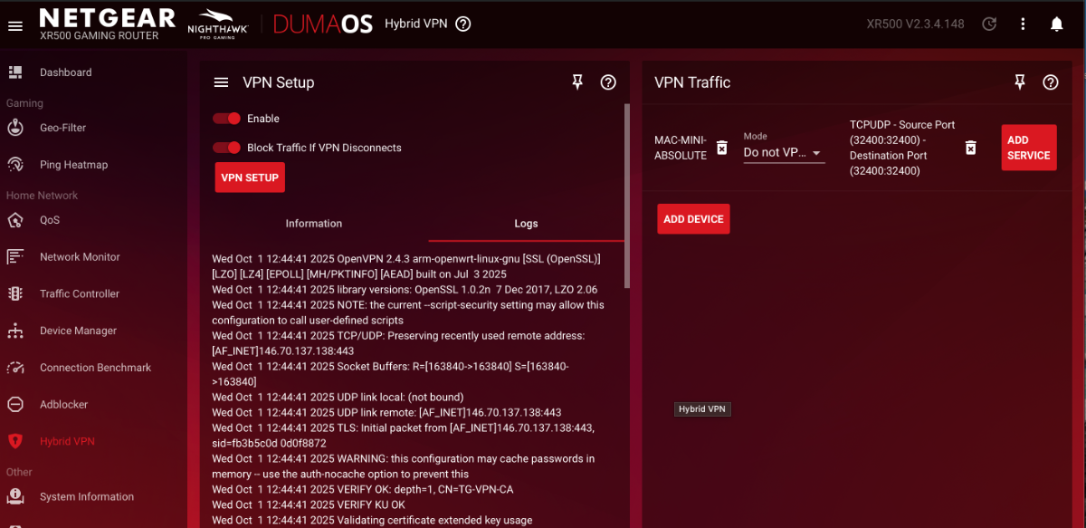

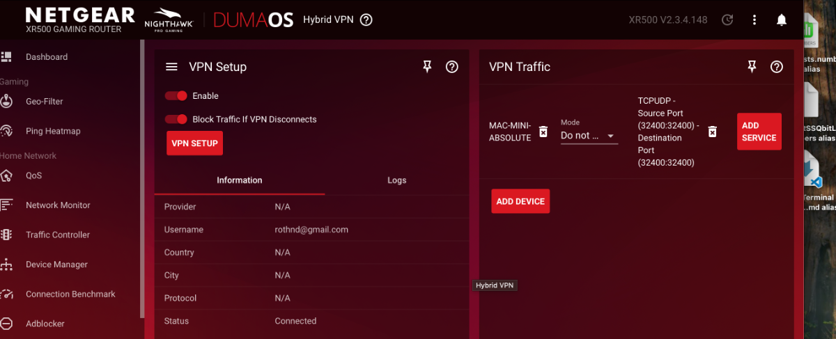

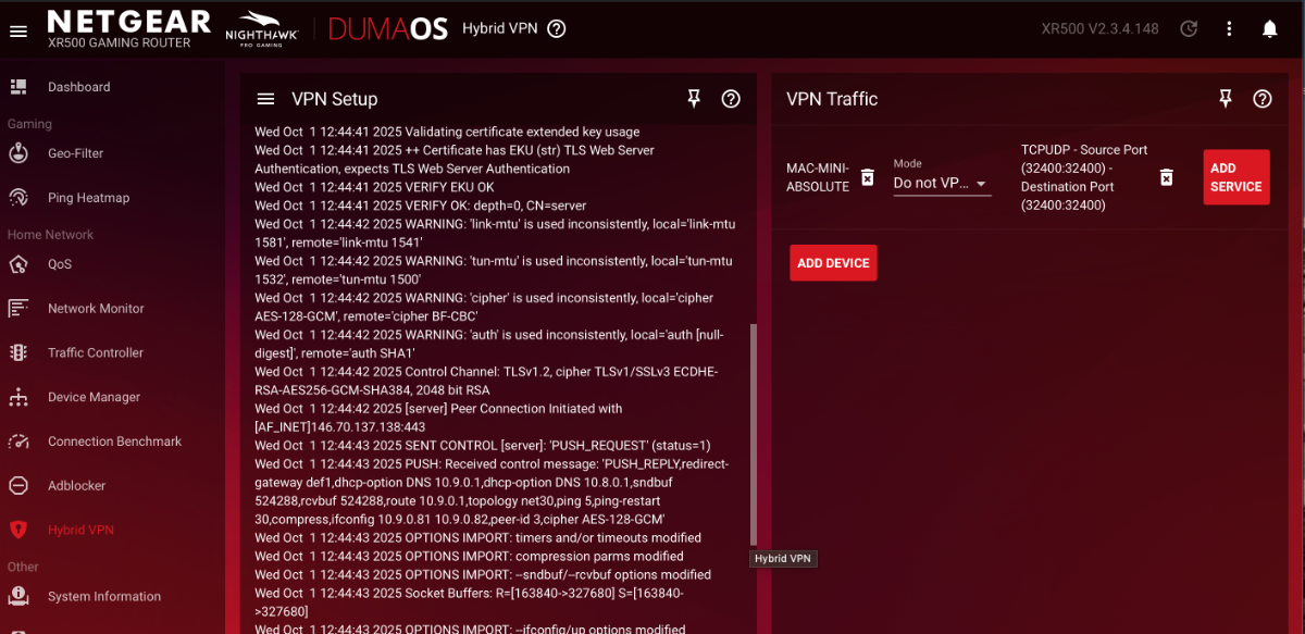

NaterTaterTheAviator25 Posted October 1, 2025 Posted October 1, 2025 Hello, I have gone round-and-round trying to separate my Plex traffic from my m1 Mac mini from all other traffic on this home media server. I'm running macOS, I have the Nighthawk XR500 just updated to v2.3.4.148. I spent the last few minutes trying to get the logs copied but they won't copy(?) so the best I can come up with is a bunch of pictures. But, it looks like the Hybrid is connecting, it looks like my external IP reflects that connection, but I can't seem to figure out/make Plex use the WAN IP, it seems to be stuck somehow (ie port showing closed even though port is open on both IPs). I would love some help with this! If I'm not providing something please just ask me to or, in some cases, tell me where to find what you're looking for and I'll be happy to get! Thank you!

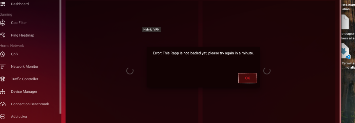

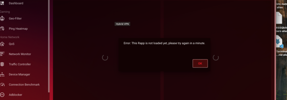

NaterTaterTheAviator25 Posted October 1, 2025 Author Posted October 1, 2025 And now I can't get into the Hybrid VPN settings...
Administrators Netduma Fraser Posted October 2, 2025 Administrators Posted October 2, 2025 You want the VPN to apply to just Plex on the 32400 port is that right? If so you need to change the mode to Only VPN these services instead. Did you reboot the router while the VPN was connected by any chance? If so that'll be why it's not loading now, I think you'll need to do a factory reset to clear that.
NaterTaterTheAviator25 Posted October 2, 2025 Author Posted October 2, 2025 Yep, you called reboot while connected. Ok. Thanks!
