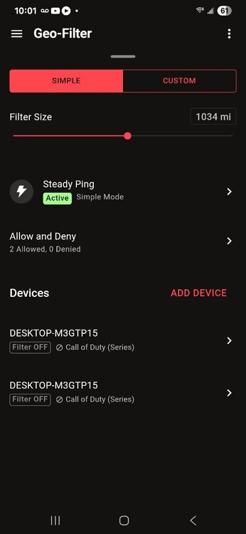

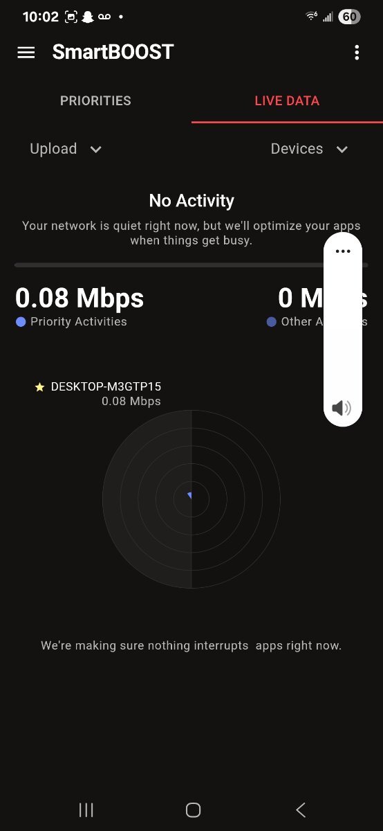

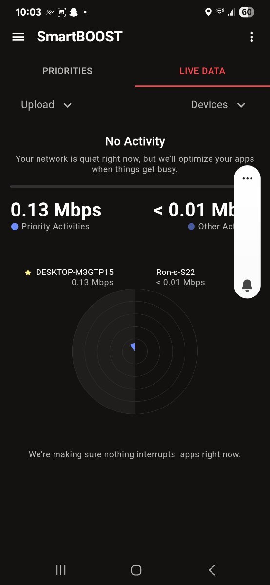

Ron runion Posted October 1, 2025 Posted October 1, 2025 Gio filter won't show servers or connect to any servers, and in the smart boost tab it dosnt / barly shows i am using my pc to play any sort of game
Ron runion Posted October 1, 2025 Author Posted October 1, 2025 Update got it to where it sais connecting to host. is lagging and spikes when playing non wired connection not sure if it's connecting and working some how but not showing stats cause my connection is good and it shows the controller icon for what server i am on

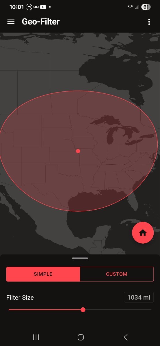

Administrators Netduma Fraser Posted October 2, 2025 Administrators Posted October 2, 2025 Gaming doesn't use much bandwidth at all so SmartBOOST is reporting accurately there. Remove your both additions of your PC from the Geo-Filter, then go to the Device Manager on the router and change the PC device type to a PlayStation. Go back to the Geo-Filter and add your PC, it should add as a console and will perform better then. Make sure it says Filter On/Filtering as well as in the above screenshot the Geo-Filter wasn't doing anything.
