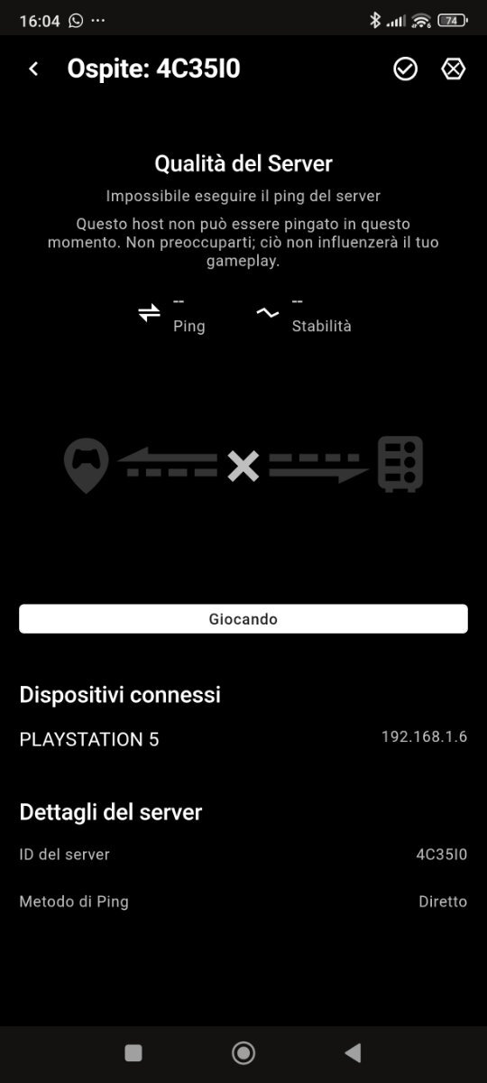

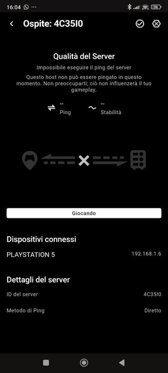

Vincenzo Posted September 11, 2025 Author Posted September 11, 2025 Ok. Ma come si fa ad aggiornare la mappa termica del ping affinché mostri un elenco di server più aggiornati? Poi un'altra cosa allego uno screenshot, puoi spiegarmi perché accade questo? Grazie.
Administrators Netduma Fraser Posted September 11, 2025 Administrators Posted September 11, 2025 That's something we'd need to update on our side. Game servers don't always respond to pings so you won't always see a ping value unfortunately
