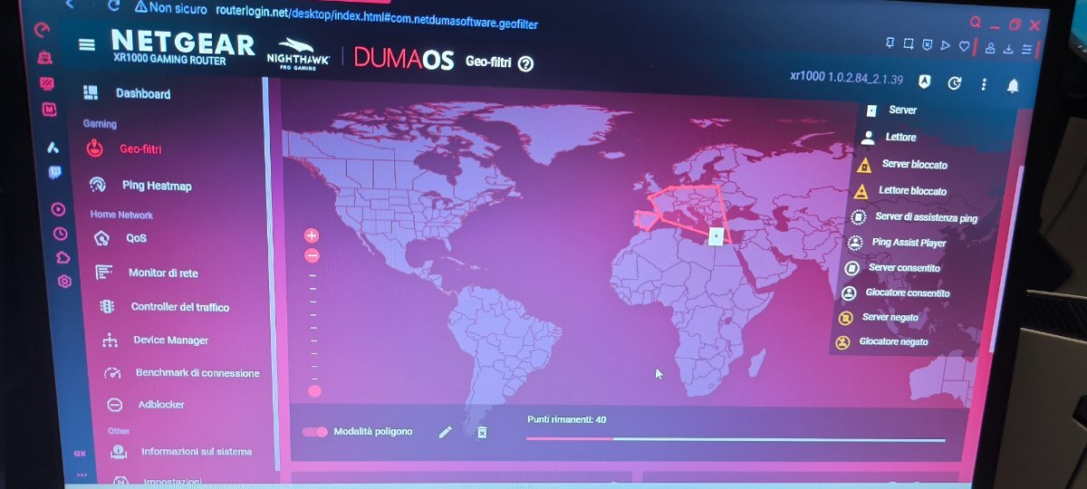

Administrators Netduma Fraser Posted September 2, 2025 Administrators Posted September 2, 2025 Can you provide a screenshot of the page showing what you see when it happens please?
Administrators Netduma Fraser Posted September 2, 2025 Administrators Posted September 2, 2025 The whole page from a PC if possible - specifically when the issue is happening i.e you're in a game

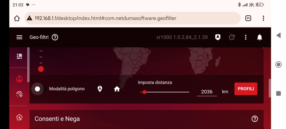

Vincenzo Posted September 3, 2025 Author Posted September 3, 2025 Questa è un immagine durante una partita dove si nota che non c'è ping assist
