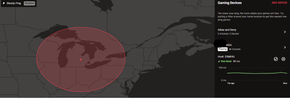

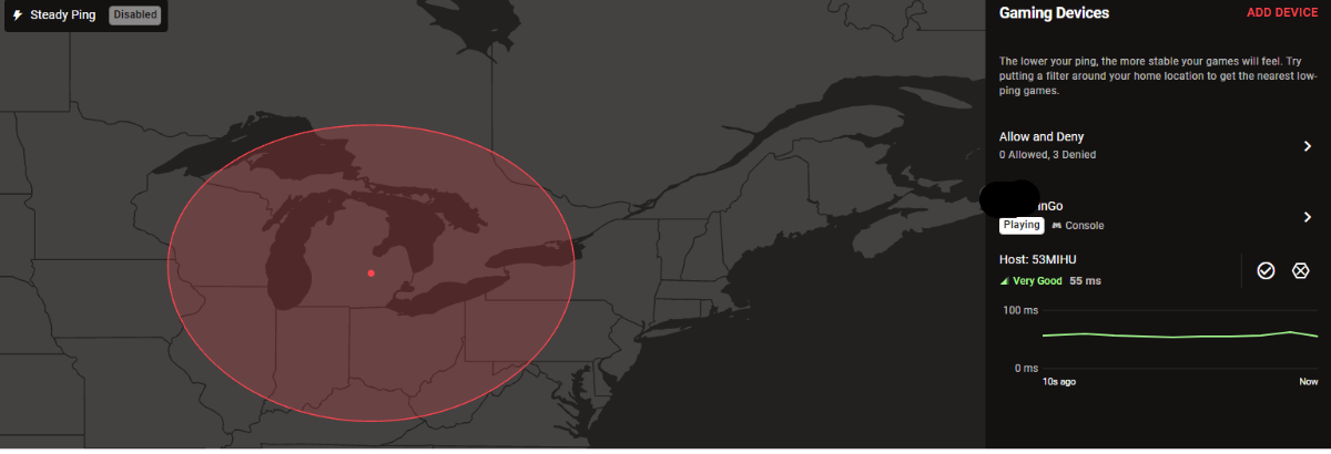

Genorok Posted Friday at 07:17 PM Posted Friday at 07:17 PM Not sure if this will be able to be fixed when the game launches, but using the PC game selection of Battlefield 6 or even setting the PC as a console and using the console Geofilter settings, the game is still connecting to matches outside of the set geofilter range and sometimes quite far away from the filter's range.
Administrators Netduma Fraser Posted Friday at 07:52 PM Administrators Posted Friday at 07:52 PM Have you got Geo-Latency and Ping Assist disabled? If not do that and then try again after rebooting the game/client
Genorok Posted 8 hours ago Author Posted 8 hours ago I have those settings disabled and it's still connecting me to servers outside of the geo range set. I've tried manually blocking each server it's connecting to. Now I'm getting servers that don't appear on the map which still must be outside of the range because the Ping is higher than those servers within the range. The servers within the range should be between 10-26ms.
Administrators Netduma Fraser Posted 38 minutes ago Administrators Posted 38 minutes ago The Geo-Filter has to be set before you launch the client/game otherwise it won't work correctly. Also if you make any changes while you're on the game you will need to reboot the game before searching again otherwise it won't filter correctly. Can you provide a screenshot of the Geo-Filter settings please?
