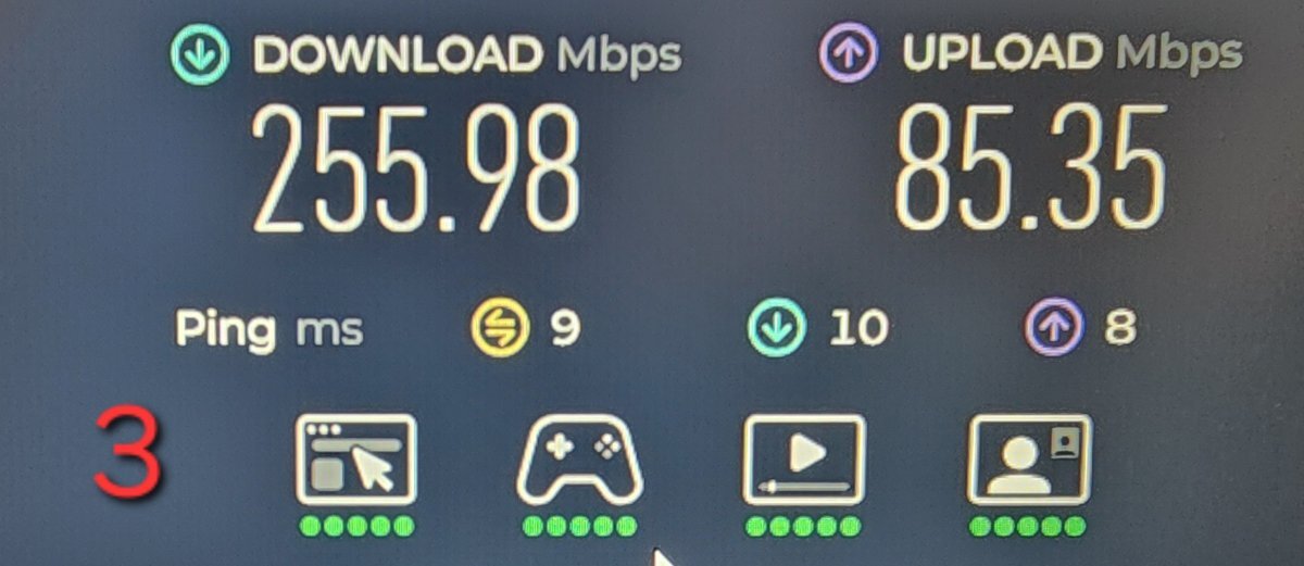

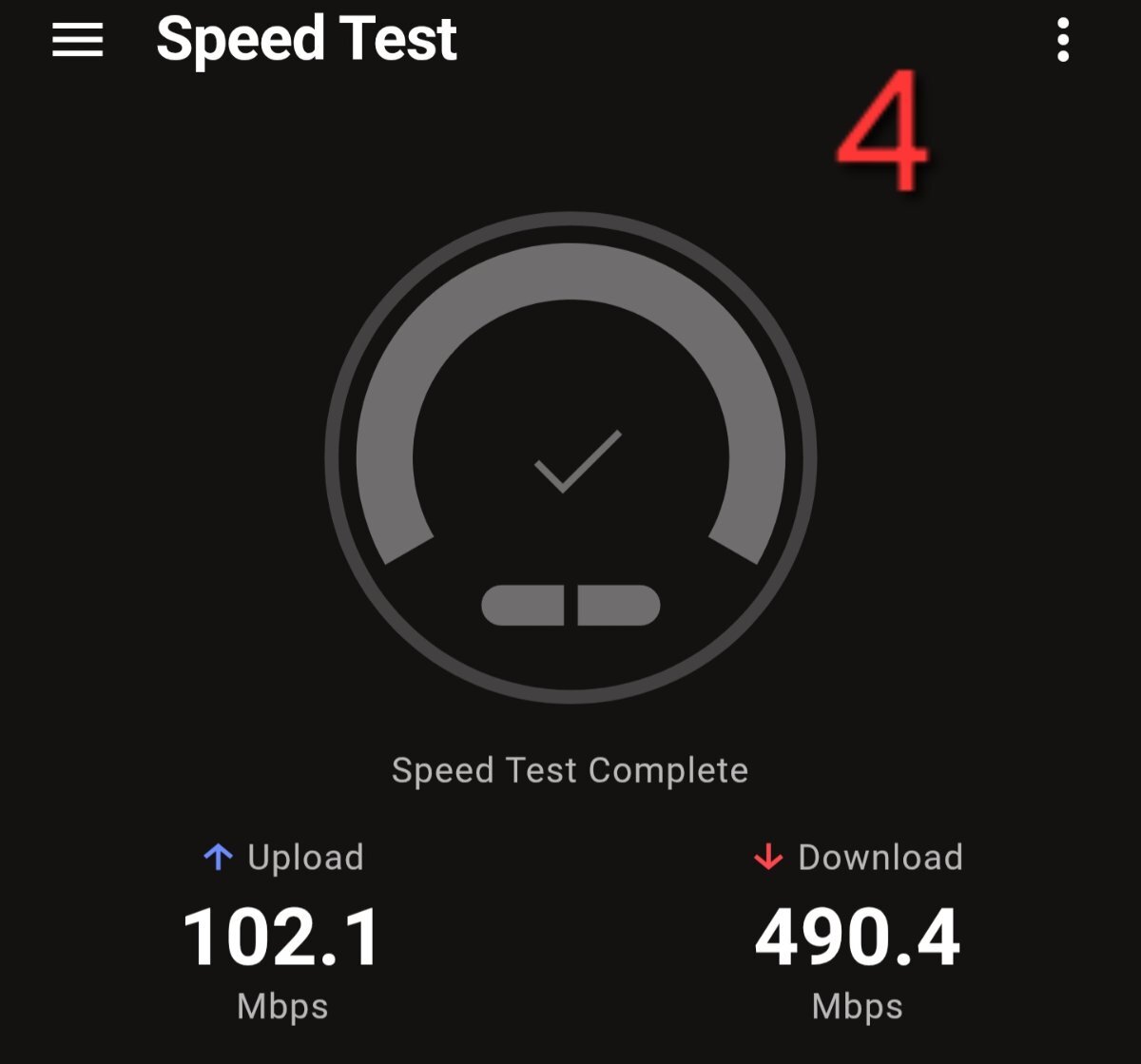

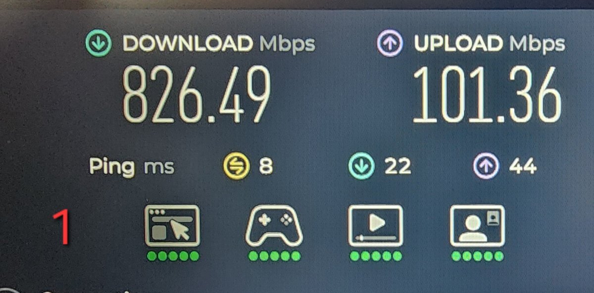

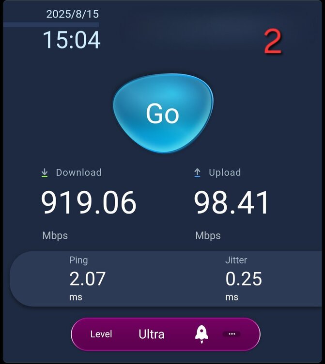

N.J Posted August 15, 2025 Author Posted August 15, 2025 To make sure the issue was with the Netduma settings, today I disconnected it and reconnected the Asus router instead. I ran a speed test via the Speedtest website using a wired connection, and also through the router’s app. Picture 1 is from the website, and Picture 2 is from the app — you can see the internet speed I got. After that, I reconnected the Netduma and ran another test via the Speedtest website using a wired connection to the computer, and also through the app. Picture 3 is from the website, and Picture 4 is from the app — you can see the results I got.
Administrators Netduma Fraser Posted August 15, 2025 Administrators Posted August 15, 2025 What is the model of the modem/router the R3 is connected to and how have you set that to ensure all traffic flows to the R3? E.g R3 in its DMZ, modem/bridge mode Are ALL devices connected to the R3? In some cases it can take time for new routers to achieve full speeds with some ISPs. If that is the case then if you copy the MAC address of your previous Asus router and set the R3 to use that MAC address instead. Give it a reboot, wait 4 minutes then it could restore your speeds.
N.J Posted August 15, 2025 Author Posted August 15, 2025 The R3 is connected to a TP-Link optical media converter for converting between 1000BASE-SX/LX fiber connections and 10/100/1000Base-T Ethernet, and also to a TP-Link Mini GBIC module TL-SM311LM V3, because it does not have a fiber optic input. I configured it via PPPoE. I didn’t set up anything in the DMZ; I only forwarded some ports for Battlefield 1 and Battlefield 5. Of course, all devices in the house are connected to it. The R3’s setup is the same as my previous Asus router — everything that was connected to the Asus is now connected to the R3. If the Asus delivered full speed, the R3 should be able to deliver it as well.
Administrators Netduma Fraser Posted August 15, 2025 Administrators Posted August 15, 2025 15 minutes ago, N.J said: The R3 is connected to a TP-Link optical media converter for converting between 1000BASE-SX/LX fiber connections and 10/100/1000Base-T Ethernet, and also to a TP-Link Mini GBIC module TL-SM311LM V3, because it does not have a fiber optic input. I configured it via PPPoE. I didn’t set up anything in the DMZ; I only forwarded some ports for Battlefield 1 and Battlefield 5. Of course, all devices in the house are connected to it. The R3’s setup is the same as my previous Asus router — everything that was connected to the Asus is now connected to the R3. If the Asus delivered full speed, the R3 should be able to deliver it as well. The ISP/MAC thing I mentioned is a legitimate thing and can result in reduced speeds over a few days/weeks, it wouldn't be an R3 specific issue. However, in this circumstance it's actually due to PPPoE, I've given you Early Access: https://forum.netduma.com/forum/151-netduma-r3-early-access so you can upgrade to the firmware there which may help to improve the speeds in the meantime while we look to improve the speeds ourselves through firmware related changes. Otherwise the solution would be to have another router handle PPPoE instead of the R3 in the meantime.

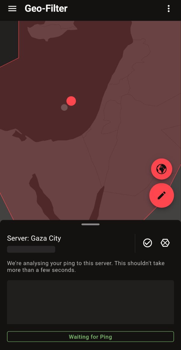

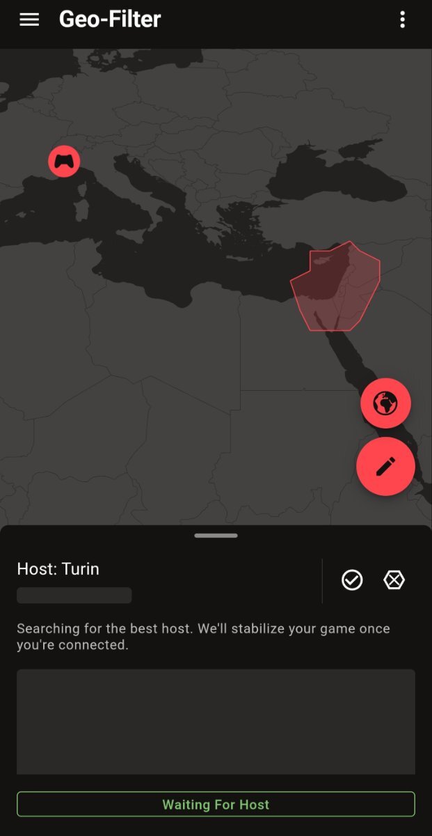

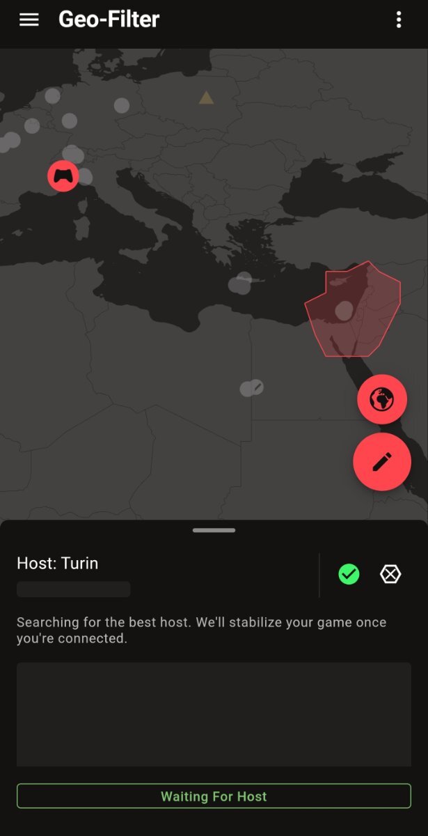

N.J Posted August 15, 2025 Author Posted August 15, 2025 I have another question that I still don't understand... In the GEO-Filter, can I choose which server to connect to or not? Because in the game Efootball, as you can see in the pictures, there are two servers near my home that are marked in red. When I click on them, it shows me their data and that everything is good, but when the game starts, they disappear from the map and suddenly connect to a server in Europe that is far from me. Why? I still haven't been able to connect to the servers I set; it connects according to what it wants...

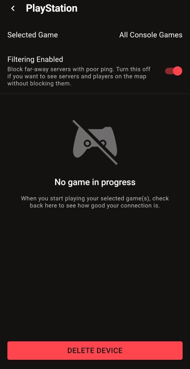

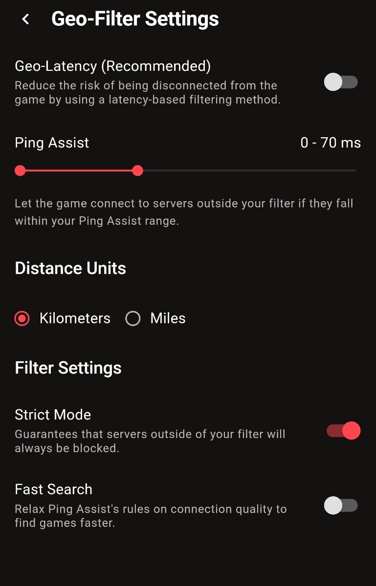

Administrators Netduma Fraser Posted August 15, 2025 Administrators Posted August 15, 2025 17 minutes ago, N.J said: I have another question that I still don't understand... In the GEO-Filter, can I choose which server to connect to or not? Because in the game Efootball, as you can see in the pictures, there are two servers near my home that are marked in red. When I click on them, it shows me their data and that everything is good, but when the game starts, they disappear from the map and suddenly connect to a server in Europe that is far from me. Why? I still haven't been able to connect to the servers I set; it connects according to what it wants... eFootball is a weird one where they use relay servers to connect you to the game server. For example, you cover an area, it'll connect to a server within that area to then connect you to a game server outside that location. Apparently covering Japan as well can make it so it adheres more to your radius. However, it actually appears as though you don't have filtering mode enabled on your Geo-Filter or you've enabled it after loading up the game as everything appears to be connectable. Make sure you have it enabled, have it all set before you launch the client/game, disable Geo-Latency in Geo-Filter settings also, cover Japan as well as the area you want and see if it improves.
Administrators Netduma Fraser Posted August 15, 2025 Administrators Posted August 15, 2025 34 minutes ago, N.J said: My settings are like this all the time. Disable Ping Assist, you're essentially allowing any servers up to 70ms regardless of where they are N.J 1
