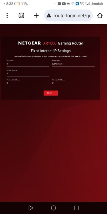

john33 Posted Saturday at 05:58 PM Posted Saturday at 05:58 PM Hello, a sudden, incomprehensible problem occurred, and my Netgear XR1000 stopped connecting to the internet and the indicator turned red. I performed a factory reset, but the problem has not been resolved yet. When I set up the router, a new menu appeared, which I have never seen before. I will attach it now. What is the solution? Thank you.

john33 Posted Saturday at 06:35 PM Author Posted Saturday at 06:35 PM Yes, I was logging in using 192.168.1.1. There is no difference in the login method. In all cases, it takes me to this new menu. If I try to enter the information correctly (if) the internet will not work. It will show a white color, but in reality it will not work. As for how the internet flows, it is PPPoE, and Netgear XR V1 is the basic one.

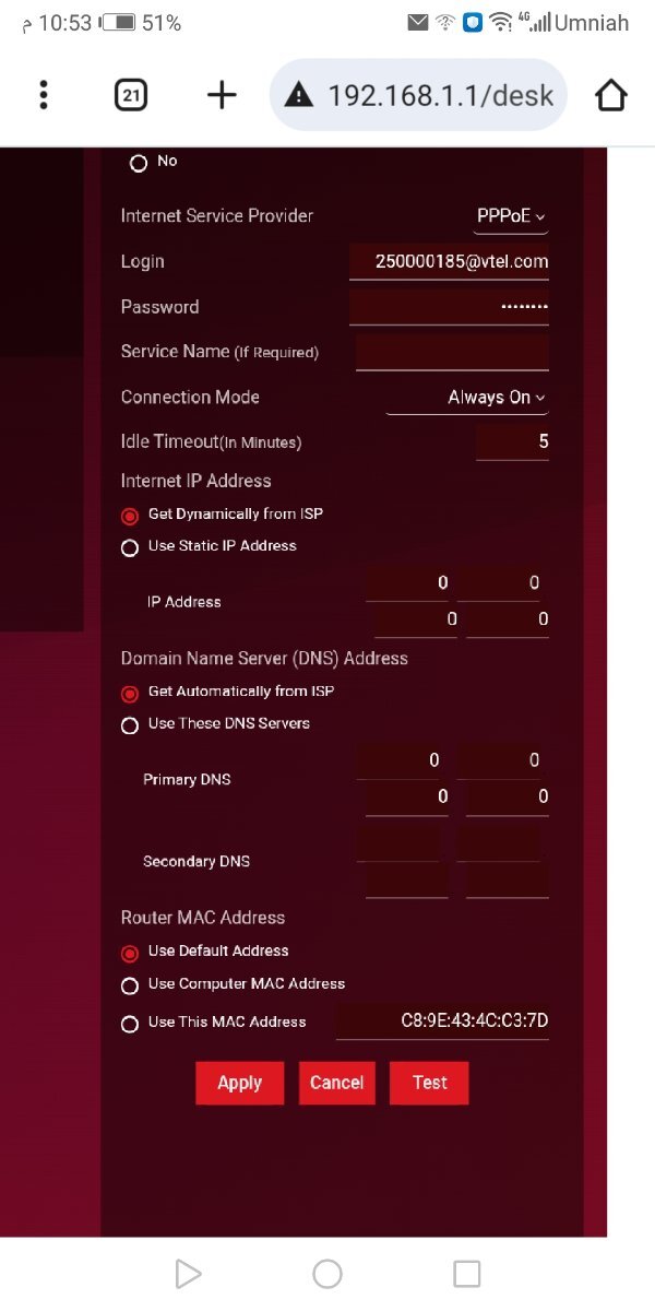

john33 Posted yesterday at 09:22 AM Author Posted yesterday at 09:22 AM I tried that, but it didn't work. The device doesn't automatically retrieve IP information. If I don't enter it, it stays blank. If I enter it manually, it gives off a white light indicating that the internet is working, but in reality, it doesn't. I've tried with two service providers.
Administrators Netduma Fraser Posted yesterday at 05:12 PM Administrators Posted yesterday at 05:12 PM Could you provide a screenshot of the Internet Setup page on the XR please?
Administrators Netduma Fraser Posted yesterday at 08:11 PM Administrators Posted yesterday at 08:11 PM Looking at your Huawei model, the XR shouldn't be handling PPPoE, it doesn't need to it looks like, so disable PPPoE on the XR. Reboot the Huawei, wait 2 minutes, reboot the XR from the interface, wait 4 minutes then see if you get internet.
john33 Posted yesterday at 08:41 PM Author Posted yesterday at 08:41 PM The problem is that the "fixed IP" list appears, not PPPoE. I tried with two service providers, both with PPPoE and without PPPoE. Yes, the router version doesn't support this. Instead, you need to contact your service provider to have the Netgear XR connect via PPPoE. I've been connecting via PPPoE for three months and never had any problems like this. Previously, the "fixed IP" list didn't appear. Now, no matter what service provider I connect to, it won't do this and won't get the correct IP readings.

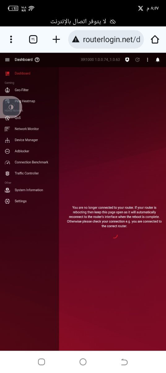

john33 Posted 3 hours ago Author Posted 3 hours ago First, I apologize for the delay in responding due to the time difference between countries. Second, the information list is as it is, without an IP address, unless you fill it out to no avail. Not to mention that the duma list has some problems logging in, and now I will attach it for you. Dear friend, are there any solutions? I've been experiencing this problem for 3 days. Yes, my Huawei was in bridge mode. And two hours ago, I spoke with my service provider to remove this mode.
Administrators Netduma Fraser Posted 2 hours ago Administrators Posted 2 hours ago No worries, reply whenever you're able to. Use 192.168.1.1 to login instead. I'll need the log from the System Information page when you then have access. As you've now disabled bridge mode you can also disable PPPoE on the XR. Reboot the Huawei, wait 2 minutes, reboot the XR from the interface, wait 4 minutes then check if you have internet.
