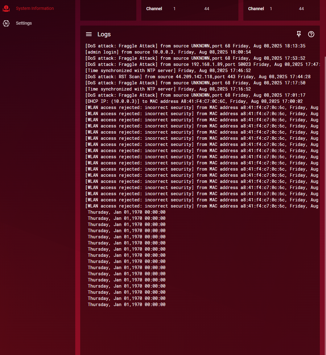

Seomos17 Posted August 8, 2025 Author Posted August 8, 2025 yes i did dowload it for the system information page
Administrators Netduma Fraser Posted August 8, 2025 Administrators Posted August 8, 2025 Does the System Information page report the correct date/time?
Seomos17 Posted August 8, 2025 Author Posted August 8, 2025 yea im just lost i have no idea what to do
Administrators Netduma Fraser Posted August 8, 2025 Administrators Posted August 8, 2025 Disable Armor if you're using it (the A in the shield top right of the interface), otherwise download the previous version and downgrade to that - it may have been when the router auto upgraded to the latest version that the issue started

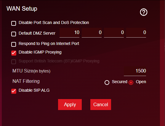

Administrators Netduma Fraser Posted August 8, 2025 Administrators Posted August 8, 2025 Set NAT to Open in WAN Settings and then reboot and try again please
Seomos17 Posted August 8, 2025 Author Posted August 8, 2025 Set nat to open , same issue occurs 32 minutes ago, Netduma Fraser said: Open in WAN Settings

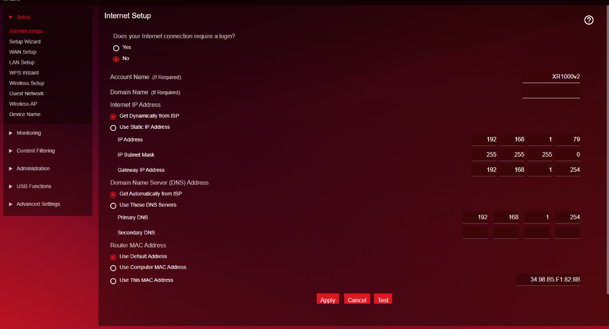

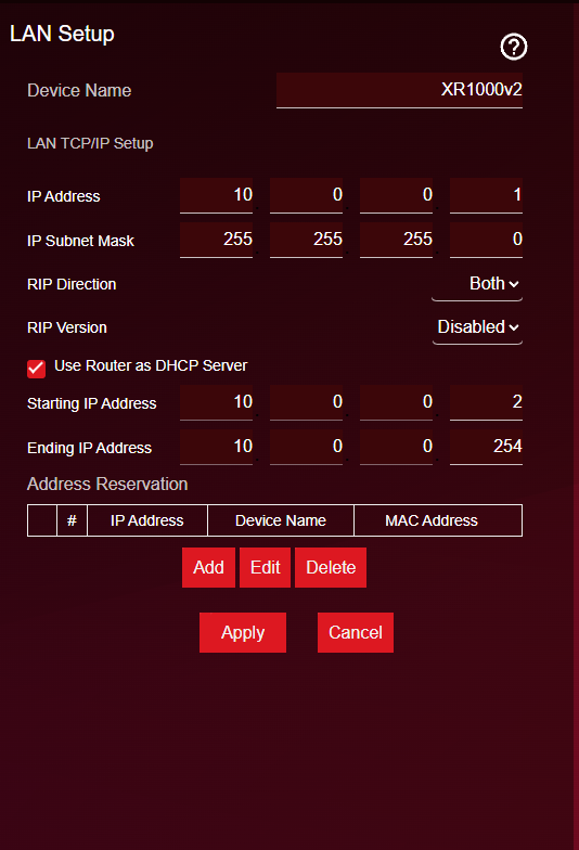

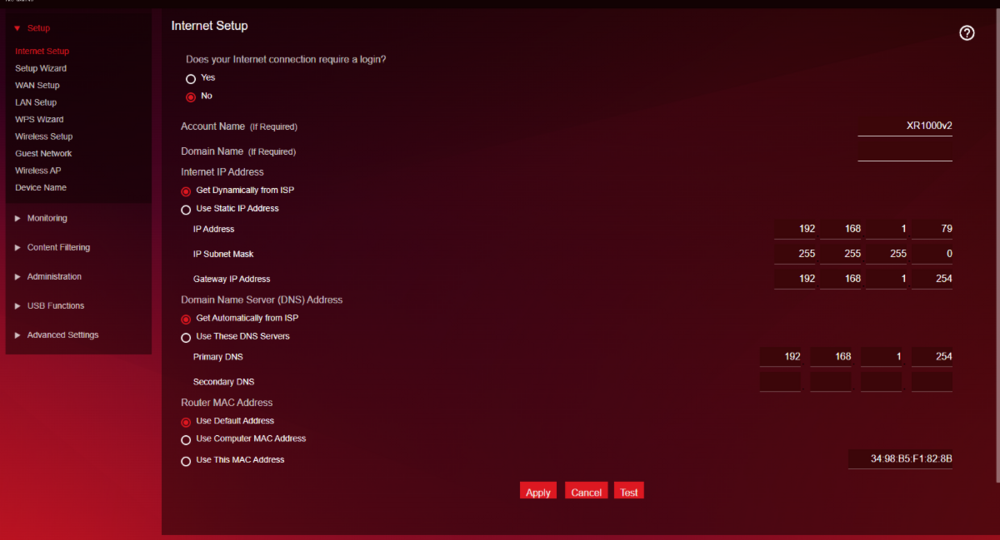

Administrators Netduma Fraser Posted August 8, 2025 Administrators Posted August 8, 2025 Could you provide a screenshot of your Internet page & LAN settings page on the XR please?
Administrators Netduma Fraser Posted August 8, 2025 Administrators Posted August 8, 2025 Thanks, that's all fine. It does seem like it's getting blocked from downloading from the cloud - are you able to switch your ISP router to modem/bridge mode instead?

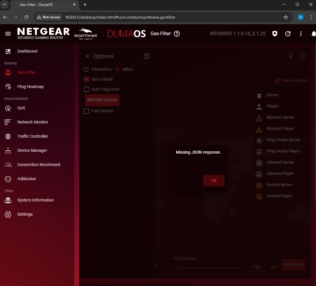

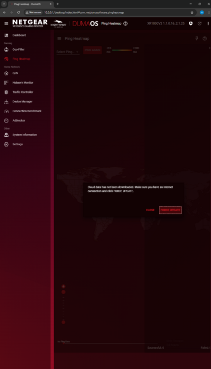

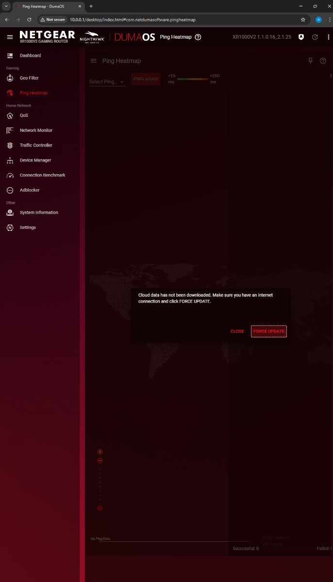

Seomos17 Posted August 8, 2025 Author Posted August 8, 2025 it doesnt seem to dowload from the cloud at all tho, geo filter doesnt work nor ping heatmap which im guessing both require the cloud, in the message it says cloud data has not been dowloaded, how do i dowload the data, forcing update does nothing, no im not able to switch modem to bridge mode it was working fine before

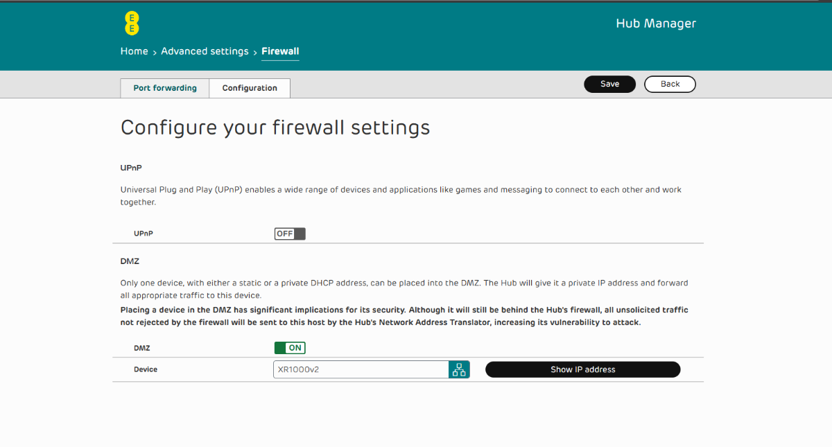

Administrators Netduma Fraser Posted August 9, 2025 Administrators Posted August 9, 2025 Yeah that's what I mean, that's why it seems like it is blocked from downloading. Just re-reading the DMZ section, it says that the firewall for the device is still active which wouldn't usually be the case and anything not blocked will be passed through. So it sounds like the firewall on the EE router might be causing it. Make sure ALL devices are connected to the XR, then disable the firewall on the EE router. Then try again please.
Seomos17 Posted August 9, 2025 Author Posted August 9, 2025 The EE router doesnt have an option to completely disable firewall. only option there is is upnp and dmz

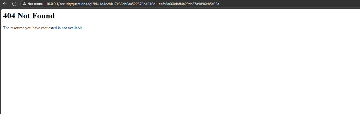

Seomos17 Posted August 10, 2025 Author Posted August 10, 2025 Hey again , i havent managed to connect the xr directly to ONT yet, so indtead i tried resetting the router, when i was on the set up page it the page stopped responding, but somehow the xr was still set up even tho i didnt finish setting it up, now i cant log into duma os using the user or password i tried getting in through using the serial number of the xr but i just get that message, i tried turning off and on the router already.
