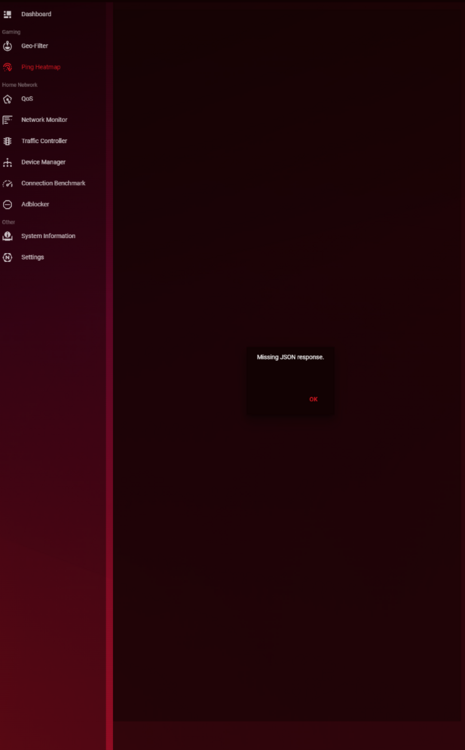

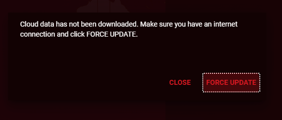

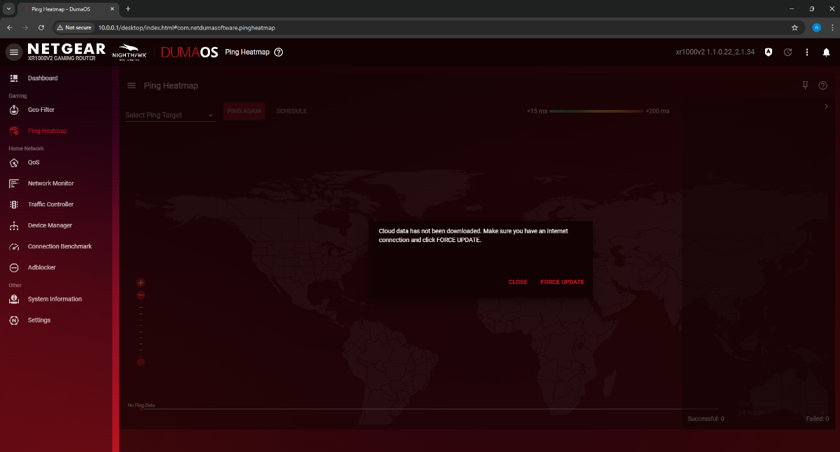

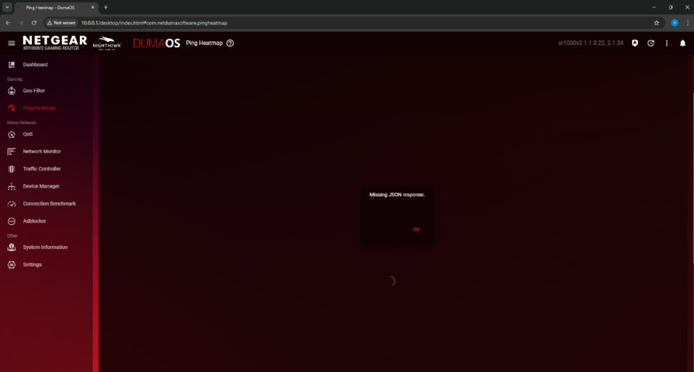

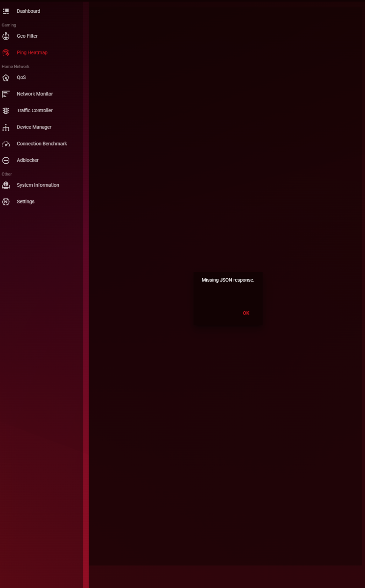

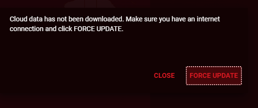

Seomos17 Posted August 8, 2025 Posted August 8, 2025 Hey again, ive now had the XR1000v2 for about 2 months now, in the last week ive been getting major packet loss over wifi so i decided to factory reset the router, i set up everthing just like i did before the packet loss did stop, but what also stopped working was ping heatmap and geo filter, i tried rebboting serveral times how ever i was unsuccessful. When on ping heat map this message pops up: When clicking force update it loads for around 5 min then shows me this: The exact same thing happens for geo filter, added devices correctly , filter is on, doesnt seem like the xr1000 detecs my game despite it being fine before the reset. when resycing cloud the same message pops up ''MISSING JSON RESPONSE''

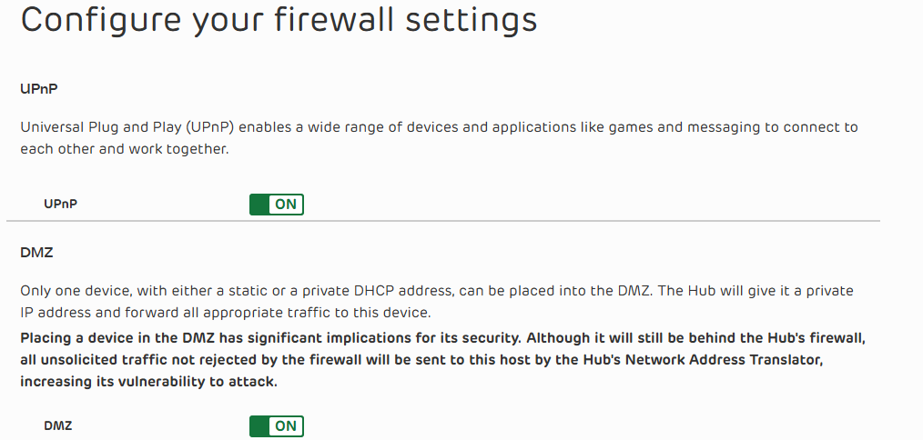

Seomos17 Posted August 8, 2025 Author Posted August 8, 2025 The XR is im DMZ it is connected to an EE smart hub plus router, add blocker is already disabled, i am not accessing the dumaos via HTTPS but rather html
Administrators Netduma Fraser Posted August 8, 2025 Administrators Posted August 8, 2025 2 minutes ago, Seomos17 said: The XR is im DMZ it is connected to an EE smart hub plus router, add blocker is already disabled, i am not accessing the dumaos via HTTPS but rather html If you factory reset the XR then its likely that it is no longer in the DMZ on the EE router so you'd need to put it in it again and that should resolve it. You mean you're connecting via HTTP definitely?

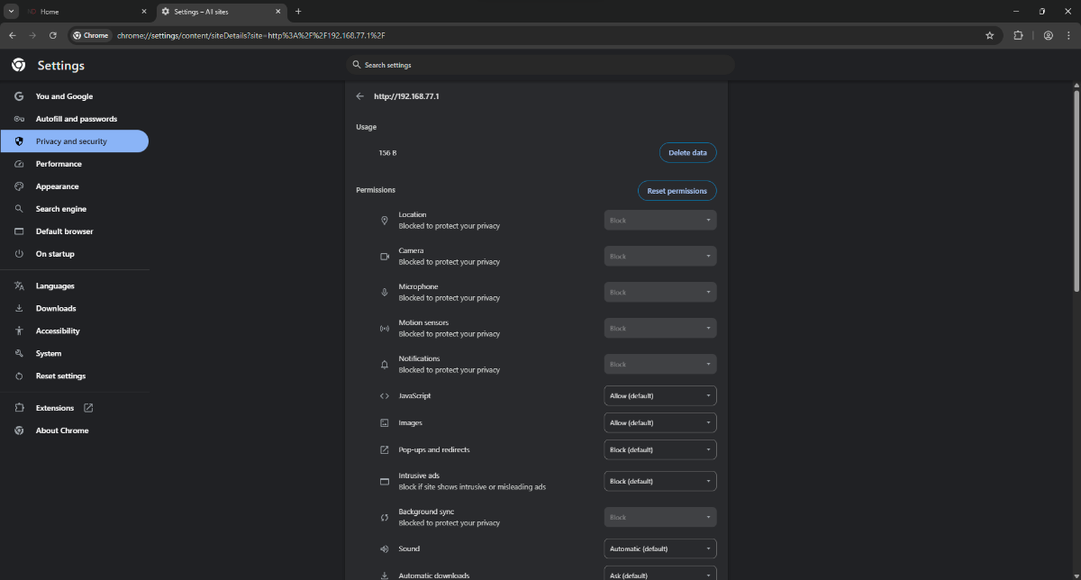

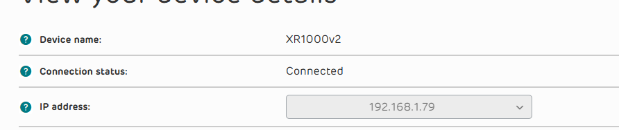

Administrators Netduma Fraser Posted August 8, 2025 Administrators Posted August 8, 2025 The XR should be in the DMZ on the EE router so you'd need to access the EE router to put the XR in the DMZ function there. The WAN IP of the XR is found on the System Information page on the XR, that's the IP you'll need to enter into the EE DMZ. Go here: chrome://settings/content/siteDetails?site=http%3A%2F%2F192.168.1.1%2F in your web browser, it should show a page like this: If so please change these: Popups & Redirects > Allow Intrusive Ads > Allow Insecure Content > Allow Then once you've done the DMZ see if you get the same issues. The IP that was entered into the DMZ will have changed after a factory reset, you'll need to double check its correct.
Seomos17 Posted August 8, 2025 Author Posted August 8, 2025 same issues, xr in dmz, same ip , chrome settings changed.

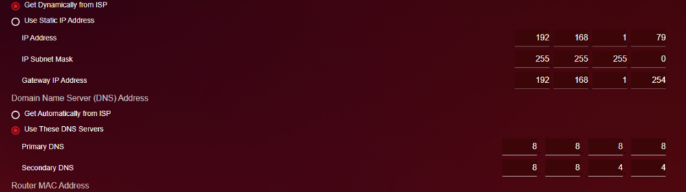

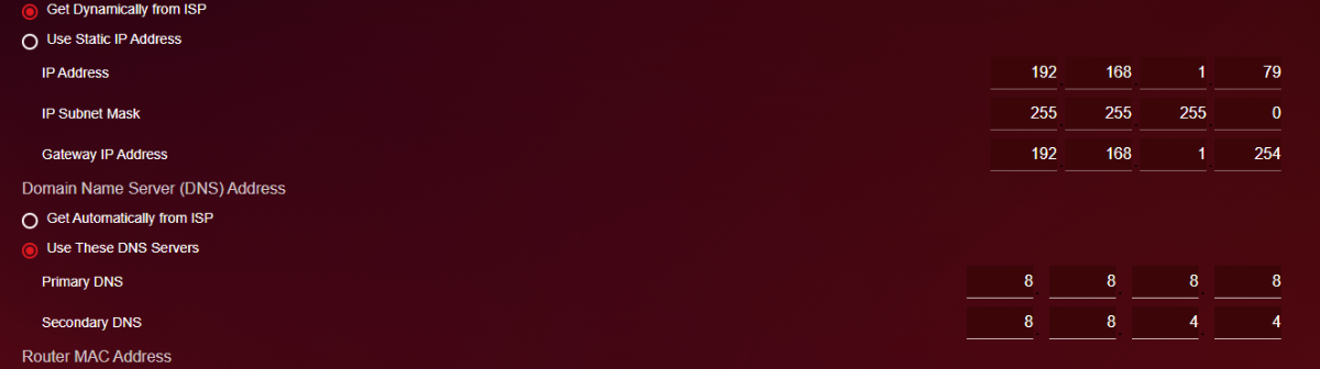

Administrators Netduma Fraser Posted August 8, 2025 Administrators Posted August 8, 2025 I didn't realize you're using 10.0.0.1 so make those changes on this page instead: chrome://settings/content/siteDetails?site=http%3A%2F%2F10.0.0.1%2F Also change DNS on the XR back to get from ISP
Seomos17 Posted August 8, 2025 Author Posted August 8, 2025 applied changes, problem still occurs, rebooted router too.

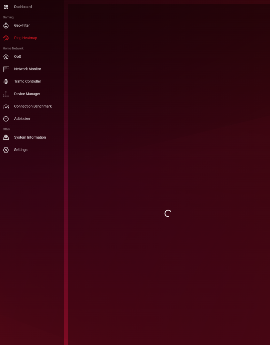

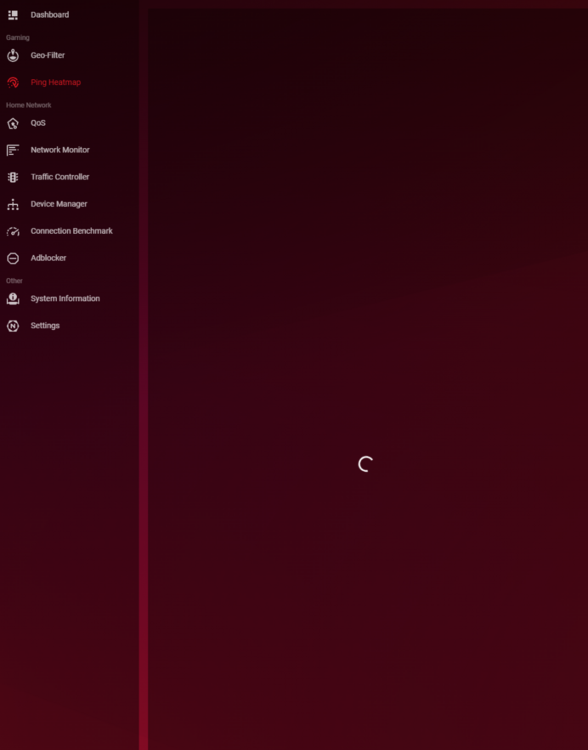

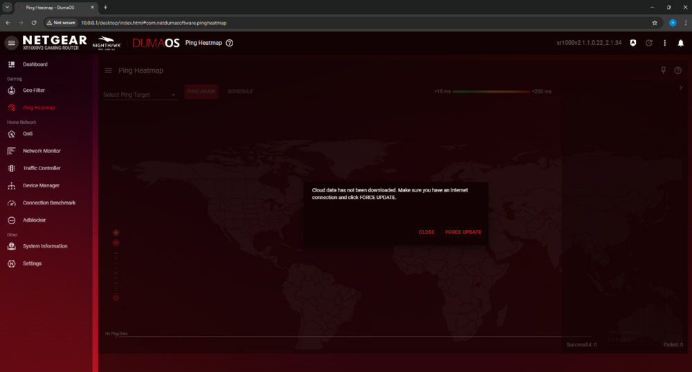

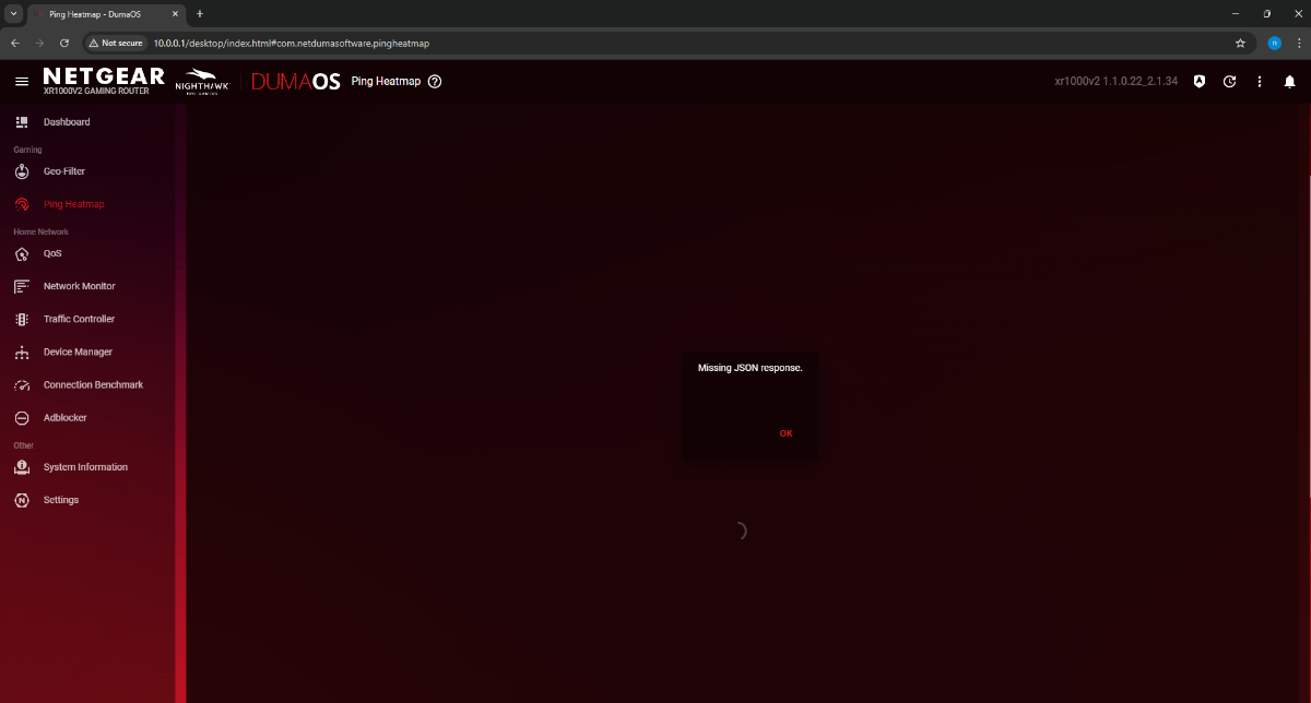

Administrators Netduma Fraser Posted August 8, 2025 Administrators Posted August 8, 2025 Could you provide uncropped screenshots please? Helps me see if there is anything else causing it. On the System Information page on the Rapp panel, click the icon and change retries to 5. Reboot from the interface, close the interface tab, wait 4 minutes then access and see if it loads everything. If not please provide a full screenshot of a page with the error and provide the logs from the System Information page please (click on it and download then upload here)

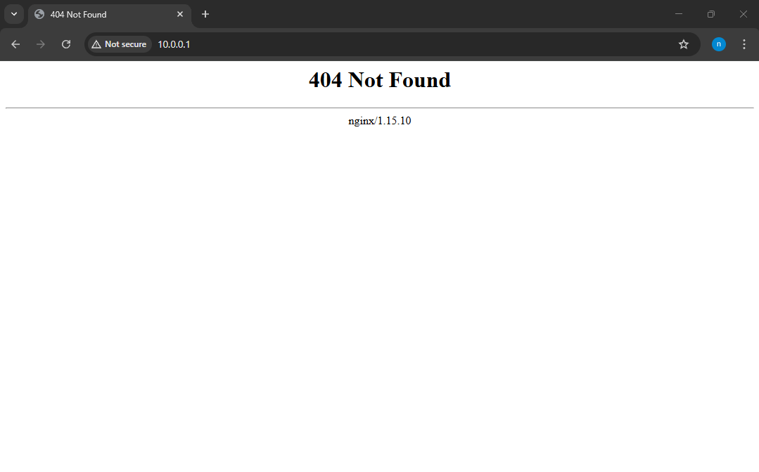

Seomos17 Posted August 8, 2025 Author Posted August 8, 2025 12 minutes ago, Netduma Fraser said: after changing retry to 5 then rebooting i am no longer able to access dumaos
Administrators Netduma Fraser Posted August 8, 2025 Administrators Posted August 8, 2025 Download the latest firmware from here: https://kb.netgear.com/000066234 You should be able to access the NTGR settings from 10.0.0.1/adv_index.htm - if so then re-upgrade to that firmware version please, close tab, wait 4 minutes then try accessing normally please
Seomos17 Posted August 8, 2025 Author Posted August 8, 2025 after manual update, same problem, when i click force update, loads for serveral mins then gives the same message ''Missing JSON response. i now get no internet connection over wifi s

Seomos17 Posted August 8, 2025 Author Posted August 8, 2025 i cant provide a pictrure at this time, the xr is connected from the yellow wan port to one of the ee routers port, clicking force update does nothing it just does a loading icon for 4 min then shows the missing json response message
