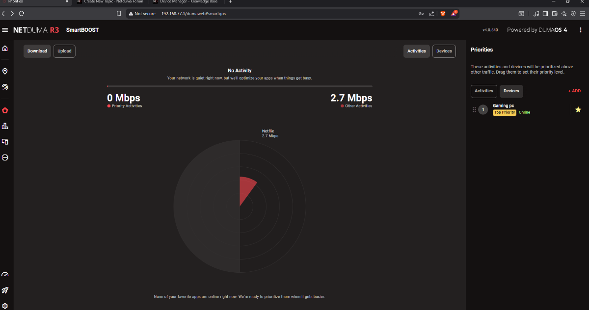

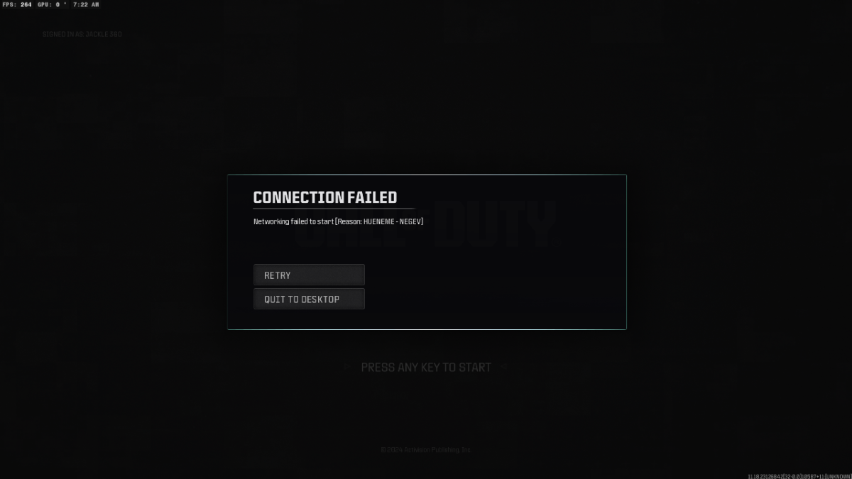

th3boywond3r Posted 14 hours ago Author Posted 14 hours ago ok when i set my gaming pc to a playstation device type this happens and i cant connect to cod at all

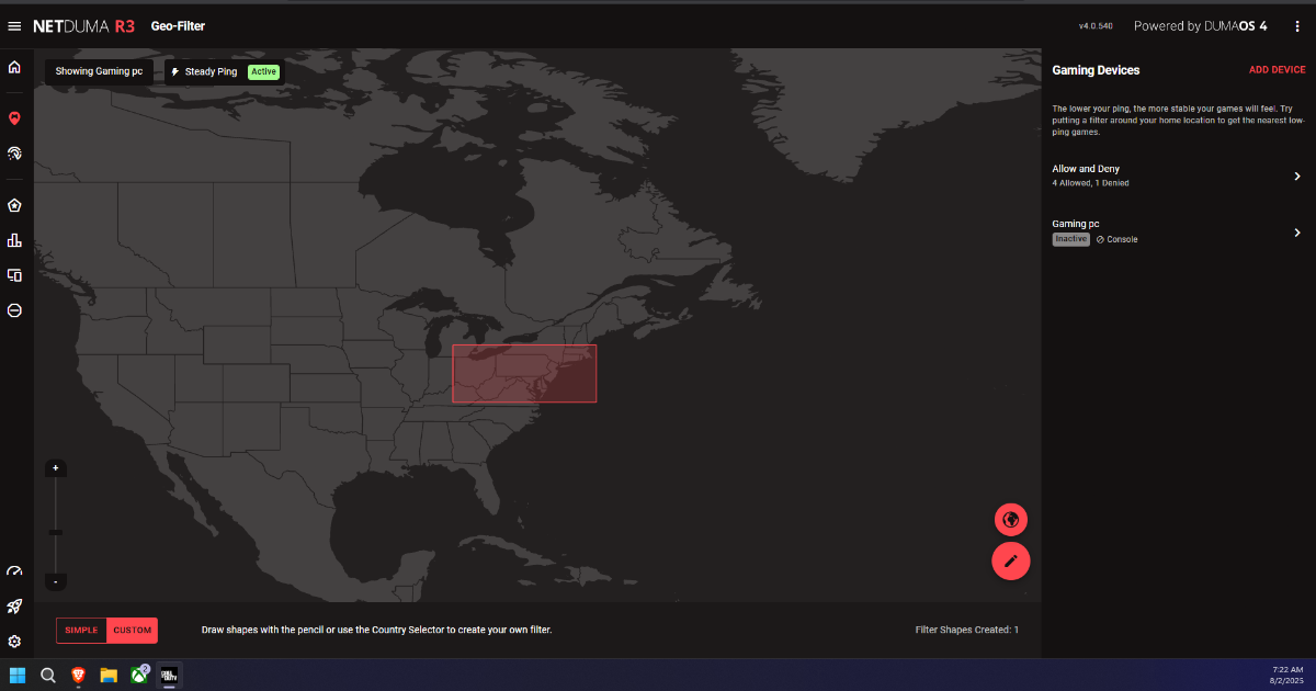

Administrators Netduma Fraser Posted 13 hours ago Administrators Posted 13 hours ago Did you follow all the steps through? Can you provide a new screenshot of your Geo-Filter page please?
