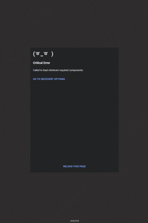

BlackBoXBoSS Posted July 26, 2025 Posted July 26, 2025 I can not access DumaOS interface at all even after restarting R3 multiple times. It always gives this error.
Administrators Netduma Fraser Posted July 26, 2025 Administrators Posted July 26, 2025 You're on a very old firmware, download the latest from here: https://forum.netduma.com/topic/58012-new-r3-firmware-dumaos-40540/ Then click Go to Recovery Options from the screen above and upgrade the firmware
BlackBoXBoSS Posted July 26, 2025 Author Posted July 26, 2025 I am on the latest early access firmware 4.0.645
Administrators Netduma Fraser Posted July 26, 2025 Administrators Posted July 26, 2025 Ah that's just highlighted that the version at the bottom of that page hasn't been updated. Re-upgrade anyway and it should resolve it

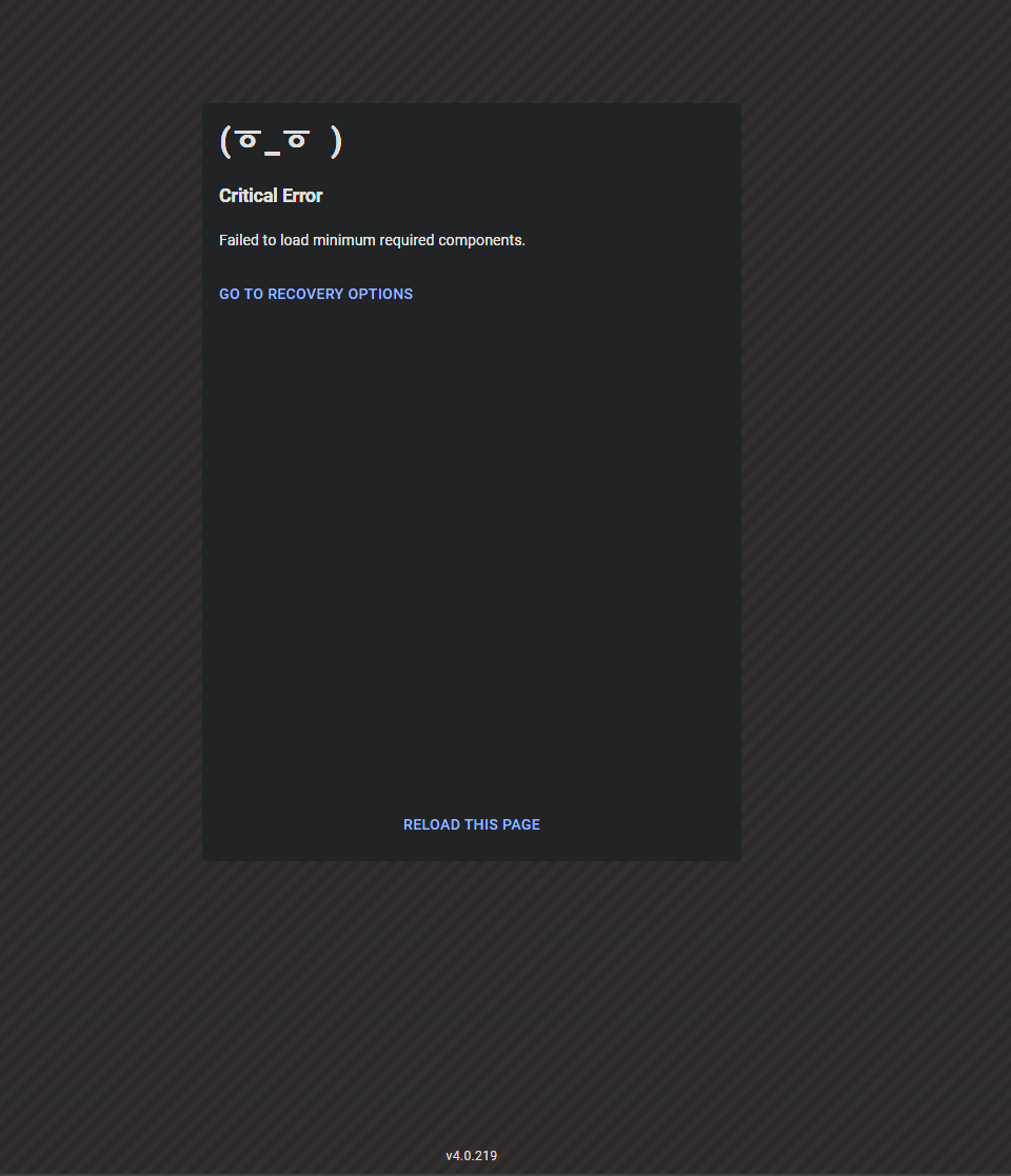

BlackBoXBoSS Posted July 26, 2025 Author Posted July 26, 2025 I re-upgraded then rebooted and got this
Administrators Netduma Fraser Posted July 26, 2025 Administrators Posted July 26, 2025 Are you able to access via the DumaOS app?
Administrators Netduma Fraser Posted July 26, 2025 Administrators Posted July 26, 2025 Okay I think you'll need to factory reset it then from the recovery options page. If you could grab the logs from that page first that would be really helpful
BlackBoXBoSS Posted July 26, 2025 Author Posted July 26, 2025 I did factory reset and it works for now. Netduma Fraser 1

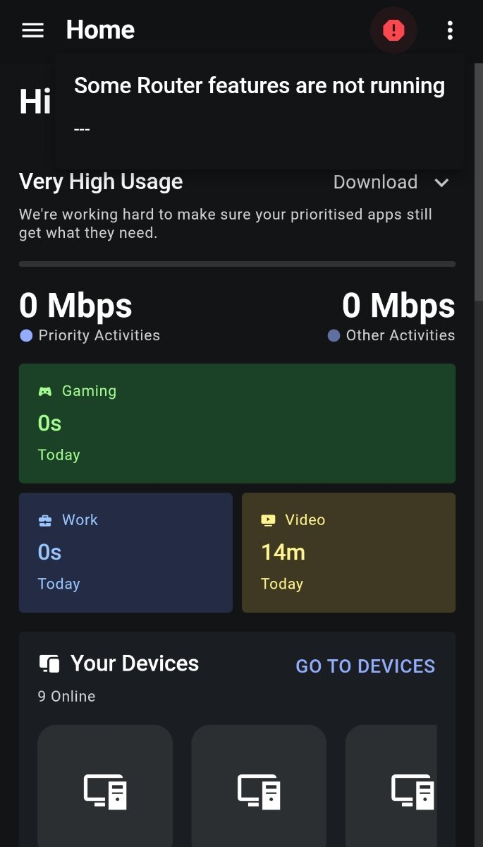

BlackBoXBoSS Posted July 27, 2025 Author Posted July 27, 2025 Now I get this after features loading and clicking continue anyway
Administrators Netduma Fraser Posted July 27, 2025 Administrators Posted July 27, 2025 Do all the pages/features appear to be working despite that message?
Administrators Netduma Fraser Posted July 28, 2025 Administrators Posted July 28, 2025 If you could grab the logs when it happens we can potentially find the cause

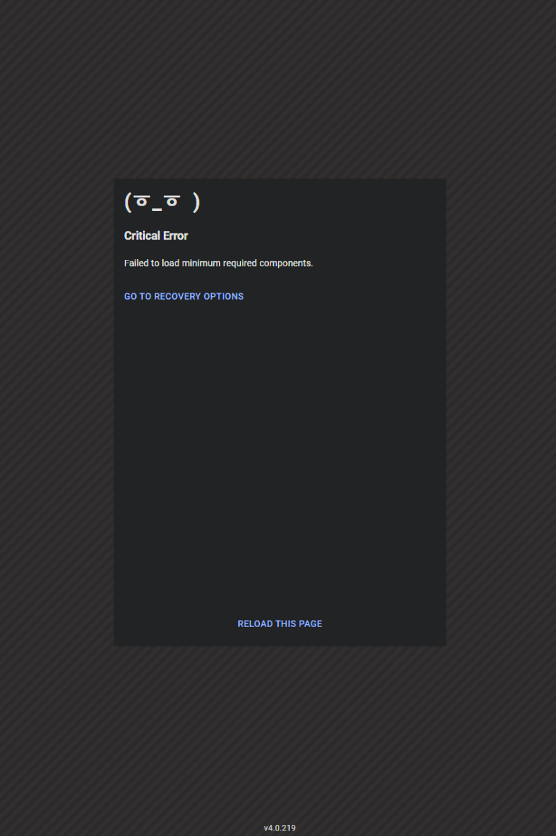

BlackBoXBoSS Posted July 28, 2025 Author Posted July 28, 2025 I tried to grab the logs but got this again.
Administrators Netduma Fraser Posted July 28, 2025 Administrators Posted July 28, 2025 Go to recovery options and you can get the logs from there
