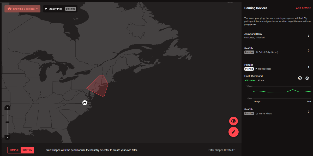

gearsniper550 Posted July 9, 2025 Posted July 9, 2025 for some reason when i was looking for a game i am getting connected to servers outside of the filter that i made. Is there a reason or am i doing something wrong
Administrators Netduma Fraser Posted July 10, 2025 Administrators Posted July 10, 2025 Do this: Quit the application/game/client completely Remove all the devices from the Geo-Filter Give PC PlayStation Device Type in the Device Manager Resync from the Geo-Filter Map menu Re-add the device to the Geo-Filter Set up the Geo-Filter how you like Wait 2 minutes Boot up application/game/client Then check that Geo-Latency and Ping Assist are disabled. Also keep in mind that Halo did put things in place quite awhile ago to prevent filtering so likely the only way to filter if it does work would be to use Geo-Latency which could still allow servers outside your radius but the ping shouldn't be too high, like the one from your screenshot.
