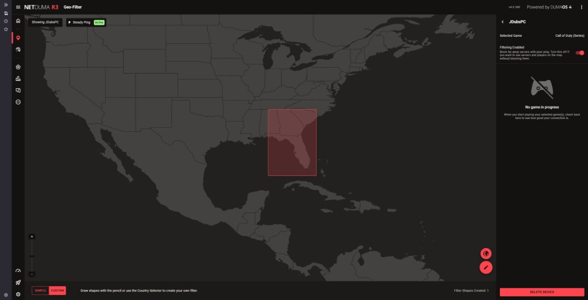

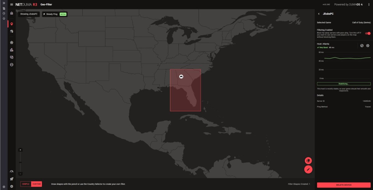

JDubs Posted July 11, 2025 Author Posted July 11, 2025 I will post two images. Both are while actively connected to a lobby & in a game on the same server. The first one shows no game in progress which is what I see 95% of the time. The second image is when it appears to be functioning properly where my latency reflects the added delay and it shows my preferred server connected.
Administrators Netduma Fraser Posted July 11, 2025 Administrators Posted July 11, 2025 You've not followed through the steps I posted fully as the PC is still added with the Call of Duty option, when you follow the steps and set the PC to a PlayStation in the Device Manager and then add it to the Geo-Filter it will add with the Games Console service and it will work much better
