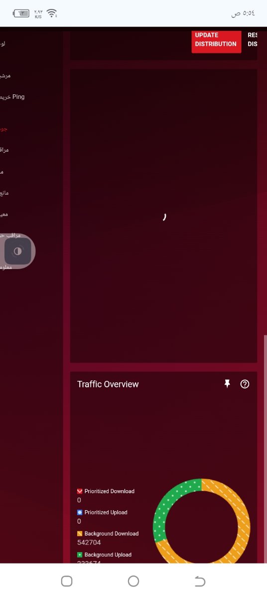

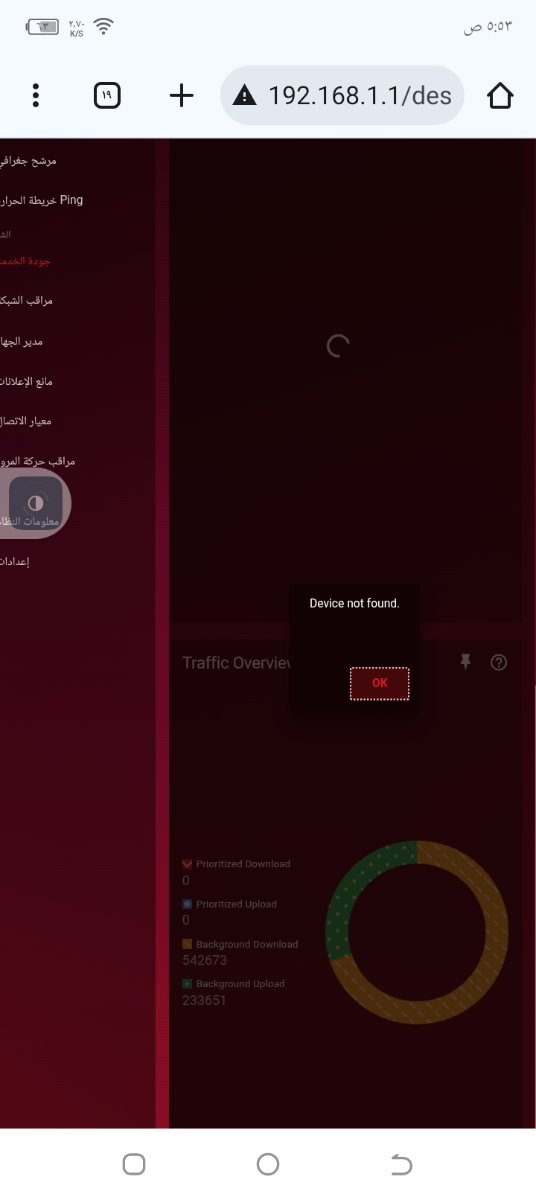

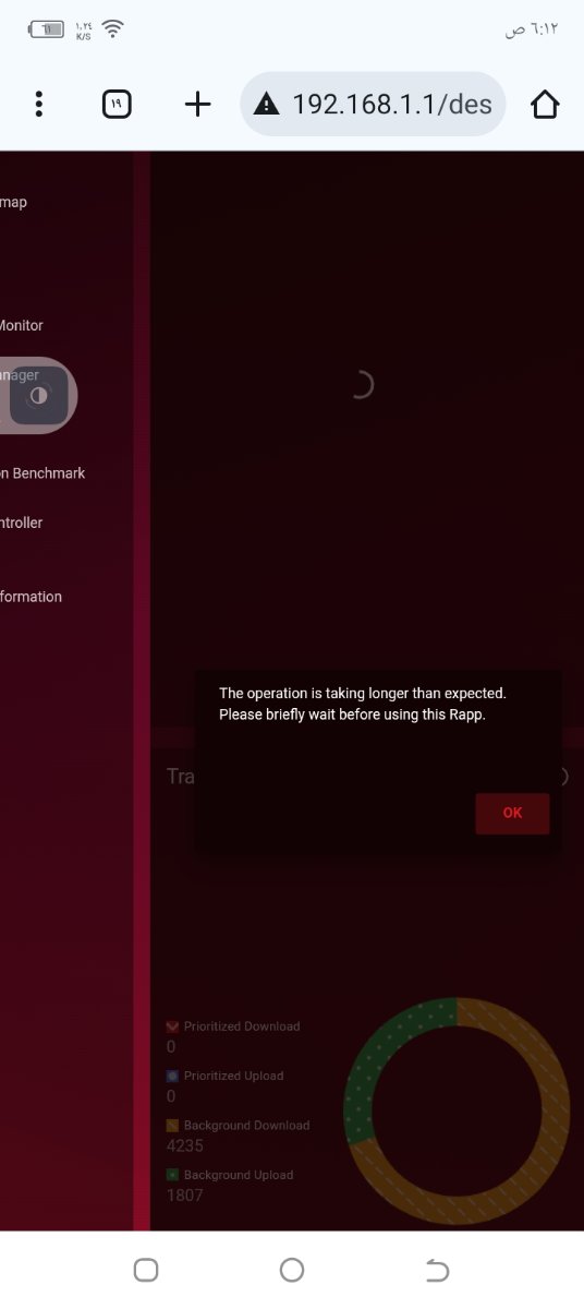

john33 Posted July 1, 2025 Posted July 1, 2025 Hello. Yes, as in the title, Qos suddenly stopped working and this option appears to me (Device not found). What is the solution, please? My version is netgear xr 1000v1 with the latest update Also, in conjunction with the main problem, when I want to choose a server from the geo filter feature, I cannot, or rather, there is a problem with the synchronization.
Administrators Netduma Fraser Posted July 1, 2025 Administrators Posted July 1, 2025 You have deleted a device from the Device Manager that was added to Traffic Prioritization on the QoS page and to the Geo-Filter. You have two options to remove the error and restore functionality: Factory reset Reconnect the device to the router via the same method (ethernet or WiFi), give it the same name as you had previously in the Device Manager as well as give it the same device type in the Device Manager
