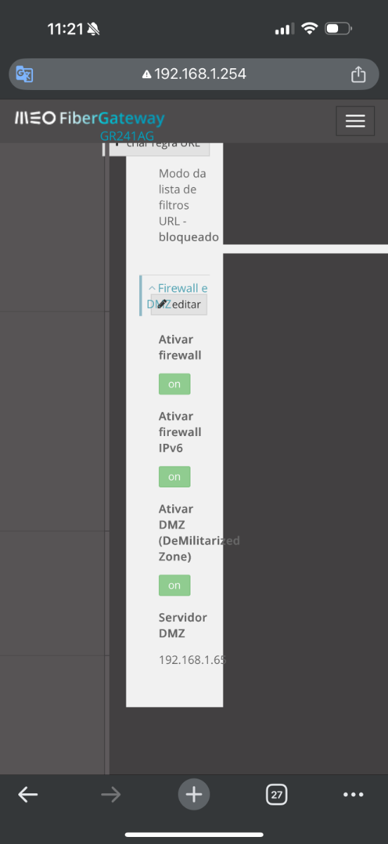

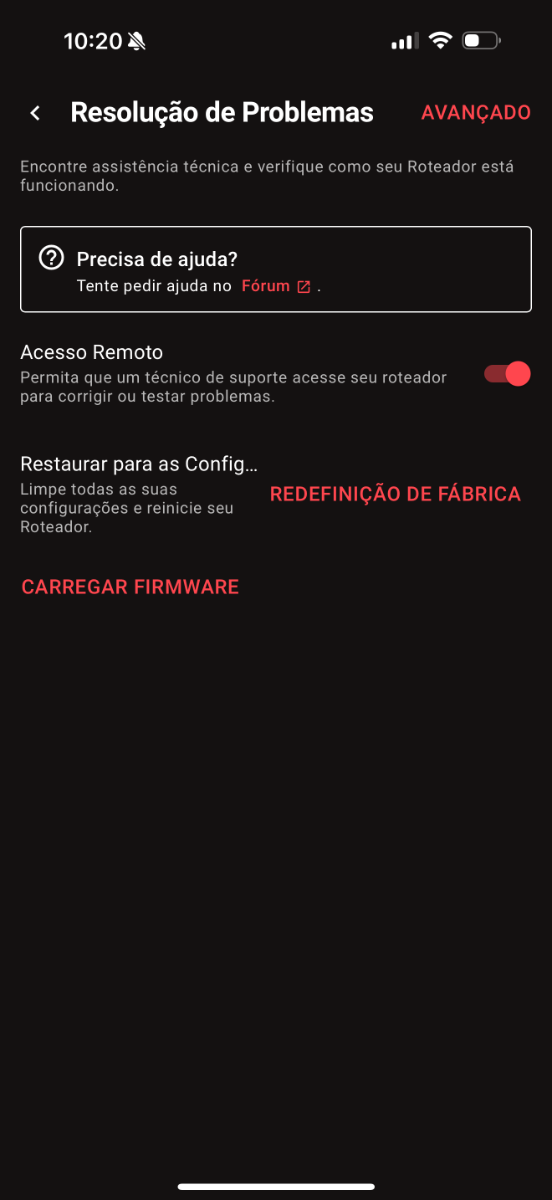

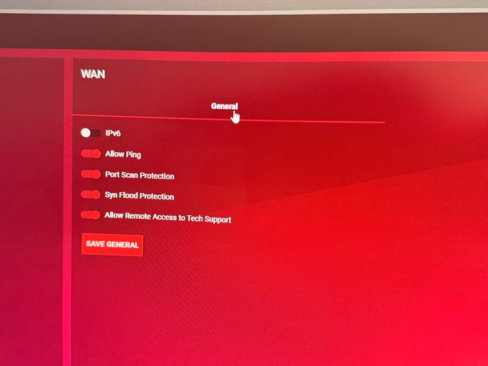

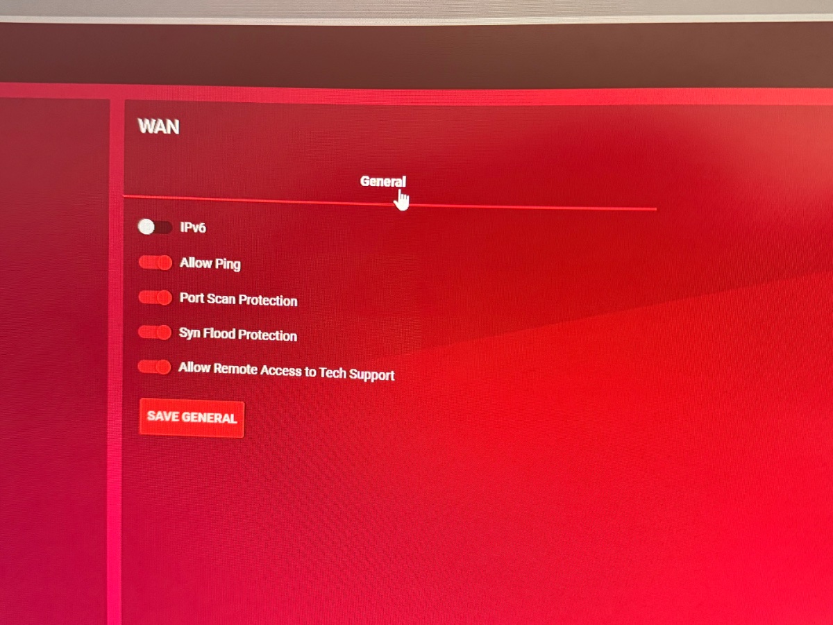

Hygor Posted July 2 Author Posted July 2 A segunda imagem é wan Ip do r2 no provedor , e a primeira imagem ipv6 desativada com suporte ativado ativado .

Administrators Netduma Fraser Posted July 3 Administrators Posted July 3 You doing it isn't going to work so you don't need to keep trying. Also if you're rebooting the router then it is likely the IP is changing and making the DMZ invalid so you'll need to double check it's the same IP as is shown on the R2 System Information page. We're seeing an IPv6 IP address when you're posting here so you'll need to disable IPv6 on the ISP router also, once you've done all that post back again.
Administrators Netduma Fraser Posted July 3 Administrators Posted July 3 The IP wouldn't change there, the IP shown on the R2 System Information page would change and may not be the same as what you entered in the DMZ. IPv6 is still enabled on the ISP router

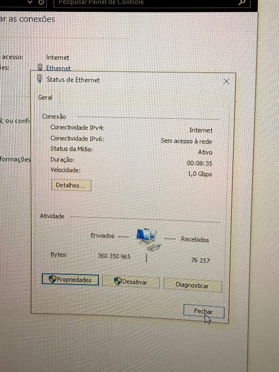

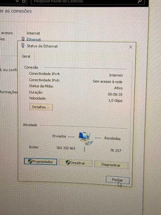

Administrators Netduma Fraser Posted July 3 Administrators Posted July 3 What do you get from here: https://test-ipv6.com
Hygor Posted July 3 Author Posted July 3 (edited) Screenshot from test showing IPv6 address active Edited July 3 by Netduma Fraser Removed as shows IP
Administrators Netduma Fraser Posted July 3 Administrators Posted July 3 Yeah so you're still getting a public IPv6 address, we'll try with the IPv4 address from the screenshot tomorrow.

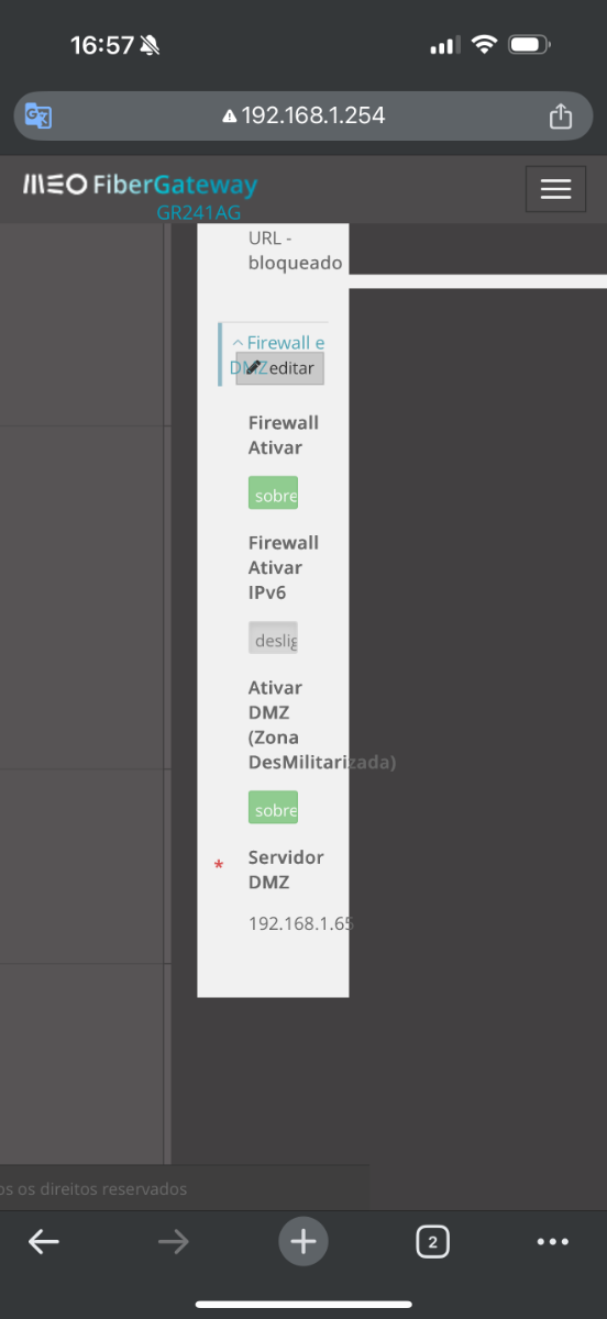

Hygor Posted July 3 Author Posted July 3 Pois , n estou sabendo ou conseguindo desativar , estou tentando ver no youtube.
Administrators Netduma Fraser Posted July 3 Administrators Posted July 3 We've got the IPv4 address so we'll try it, it's the same IP we tried last time that we were unable to access but maybe now you've run through the process again it will work. Hygor 1
