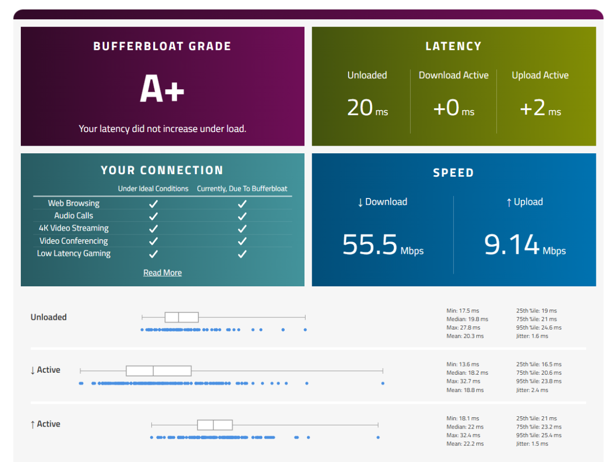

These are the best bufferbloat values I've gotten so far – unfortunately, they are still quite inconsistent. My maximum often spikes.

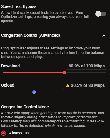

My bandwidth is 400/40, which I’ve currently limited to 100/30
These are my settings:

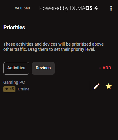

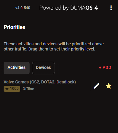

image.png.0a2533fe20d4c90023808a3a58b4bdb8.pngimage.png.7031b088af4150a30d28b8d94749cf81.pngimage.png.b16fd429a34b7f9f51d773df4f86c17c.png

Yes the R3 should be put in the DMZ on the Technicolor. You should set the speeds you pay for/receive in the router then use Congestion Control, you're throttling way too much currently which isn't needed. Follow this guide https://support.netduma.com/frequently-asked-questions/legacyfaqs/test-your-ping/ while downloading & start with 95% for Congestion Control (set to Always), check results, decrease by 10%, check, decrease by 10% etc, until you get to a value that is pretty good & then try 5% either side of that value to see if it can be improved. Download & Upload on Congestion Control don't have to be the same value & you may have a better experience with differing values.

Hi Fraser, thanks for your help. I’ve set everything up just as you said. The R3 is being used in DMZ mode, and all devices are connected only to the R3.Regarding the results – the screenshot above shows the best outcome I’ve gotten. The only thing is that I can’t get the "minimum" any lower than what’s shown in the picture. The ping basically stays the same.
