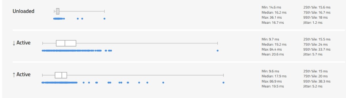

x_xSICKARIOx_x Posted June 24 Posted June 24 I am having buffer bloat, geo filter problems, and also unstable ping. I can't capture video. I just need help setting it up to work right and step by step. Thanks and much Obliged.

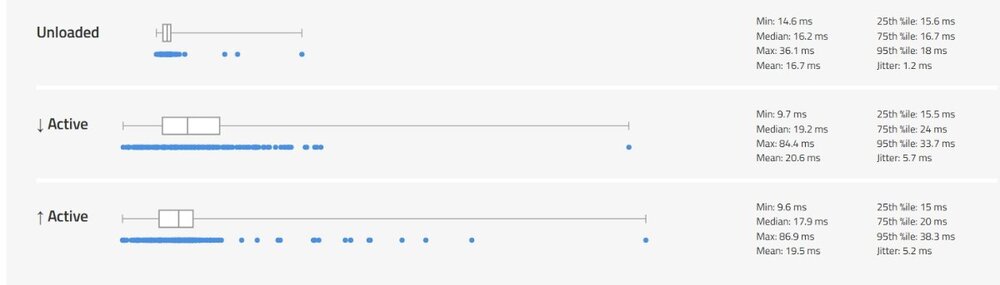

x_xSICKARIOx_x Posted June 24 Author Posted June 24 Here are my numbers, my max us to be 20 and now it's above 80 on both upload and download.
J3Ss Posted June 25 Posted June 25 What helped me was to manually set the ping optimizer to 93% for download and upload. Turned off Steady Ping and set my gaming console to DMZ.
Administrators Netduma Fraser Posted June 26 Administrators Posted June 26 What is the model of the modem/router the R3 is connected to and how have you set that to ensure all traffic flows to the R3? E.g R3 in its DMZ, modem/bridge mode Are ALL devices connected to the R3? What are the speeds you pay for/receive? Have you entered those speeds into the router? How have you setup Congestion Control? How have you setup SmartBOOST? How is the PS5 connected, via ethernet or WiFi? How have you setup the Geo-Filter?
