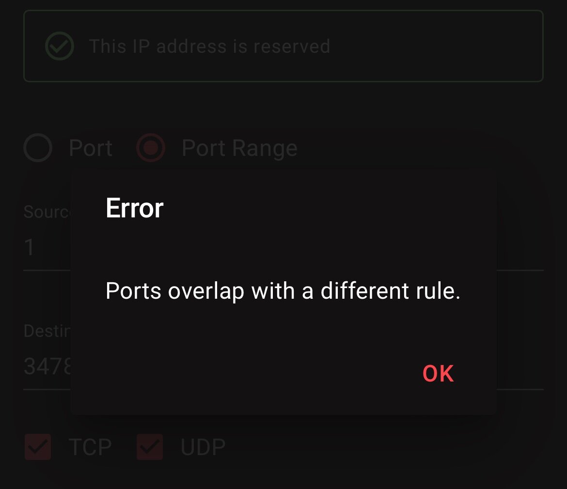

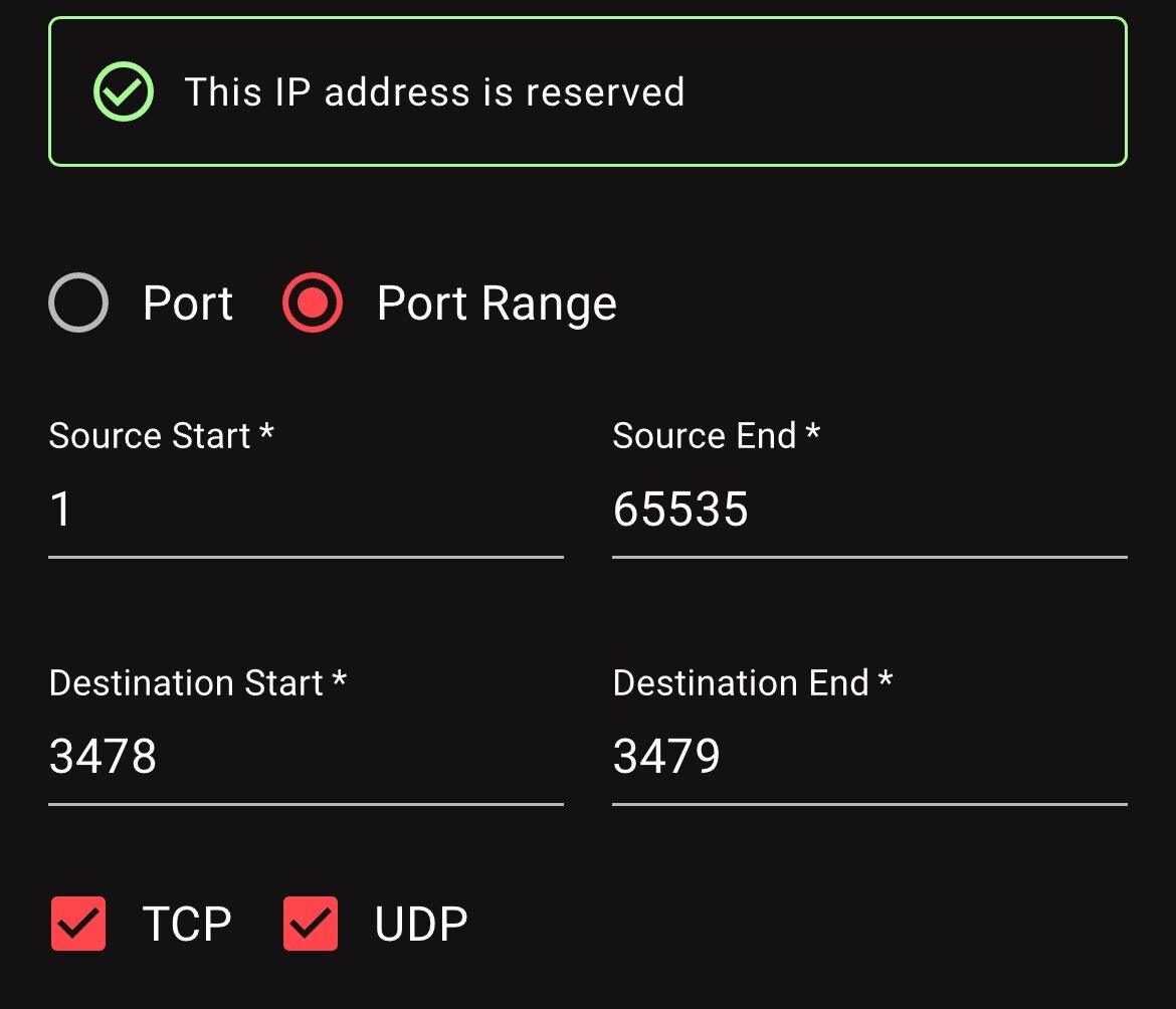

It doesn’t work. Error: Port overlap with a different rule
- UPnP Off
Port Range
Port 3478-3479
Source Start: 1
Source End 65535
Destination Start: 3478
Destination End: 3479

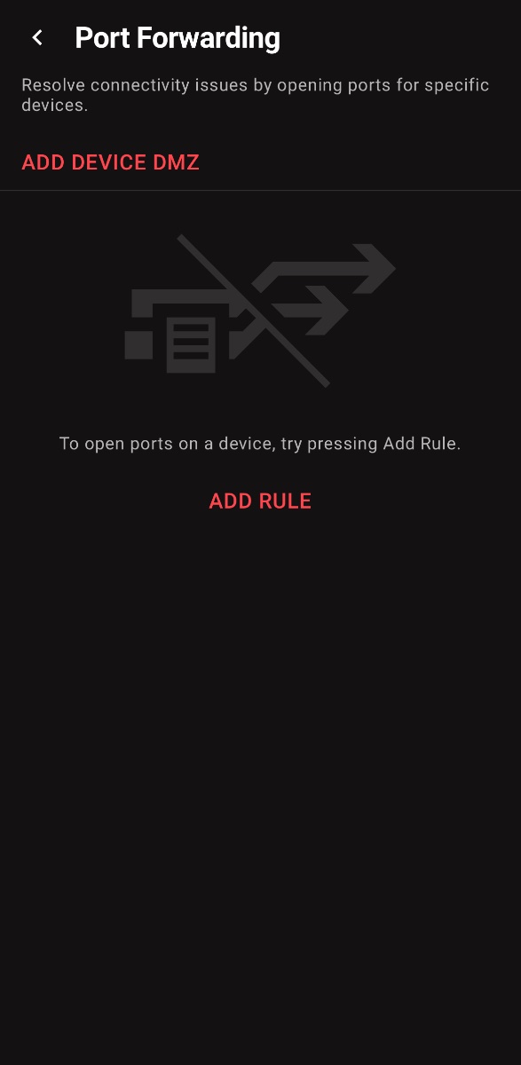

  • Administrators
Posted
Please provide a screenshot of the port forwarding page and then another one of the screen how you're trying to set the rule
Posted
Posted
7 minutes ago, Netduma Fraser said:
My mistake, do #2 from the options you gave instead
thank you very much 🤘
