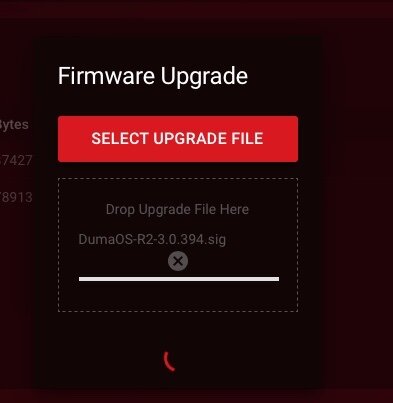

Erick Paiz Posted June 6 Posted June 6 Help!! I've tried updating my NetDuma from Firmware R2 3.0.123 to the current version 3.3.380, but I'm getting an error. "Invalid Firmware..." I've already rebooted, reset Factory Defaults reset... Dmz, and from Ethernet, and I'm still stuck. Also, the rapps won't load. Please help. Thanks.
Administrators Netduma Fraser Posted June 6 Administrators Posted June 6 That's a big jump in firmware, try incrementally at least once then try again https://support.netduma.com/firmwares/netduma-r2/ Erick Paiz 1
Erick Paiz Posted June 6 Author Posted June 6 Thanks, yes, I realize I have the firmware release, try the next one, and the next one, but I still get the same message, I even tried in ingonito, I attached the log. In case it helps, I hope to be able to get my R2 up and running, I never used it... log-1749249539282.txt

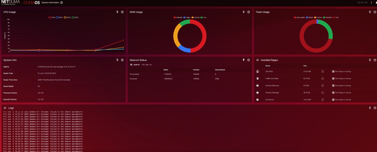

Administrators Netduma Fraser Posted June 6 Administrators Posted June 6 Could you provide a screenshot of the System Information page please?

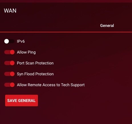

Administrators Netduma Fraser Posted June 7 Administrators Posted June 7 Okay thank you, factory reset then as soon as you can try upgrading to .179 If that doesn't work: If your ISP modem/router has WiFi, set it up so that it is in bridge or modem mode, you can also use the DMZ. Copy the WAN IP from the R2 (found in System Information) and enter it into the DMZ function on the ISP modem/router. Disable IPv6 in LAN/WAN on the R2 and enable remote support in Settings. Then post back here from a device connected to the R2 when you've done that and we'll get a dev to try and force an upgrade through on Monday. Erick Paiz 1
Erick Paiz Posted June 7 Author Posted June 7 Hi, I did what you asked and tried updating, but it still doesn't work. According to the instructions, the router is ready for remote access. Thanks again.

Erick Paiz Posted June 12 Author Posted June 12 Hi, sorry... I didn't realize I had VPN enabled on my main router, but I did understand the procedure, DMZ, etc.,VPN Off Now. and remote tech on. I can confirm the public IP privately. Thanks again.
Administrators Netduma Fraser Posted June 12 Administrators Posted June 12 Looks like IPv6 is enabled now, unless you didn't post from a device connected to the router
Erick Paiz Posted June 12 Author Posted June 12 Right now, I'm answering, from my device, connected to my R2. With and the router IPV6 is off. I'll be on the lookout...
