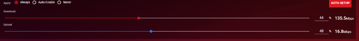

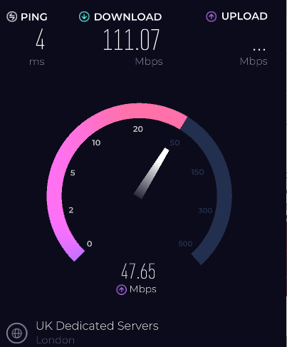

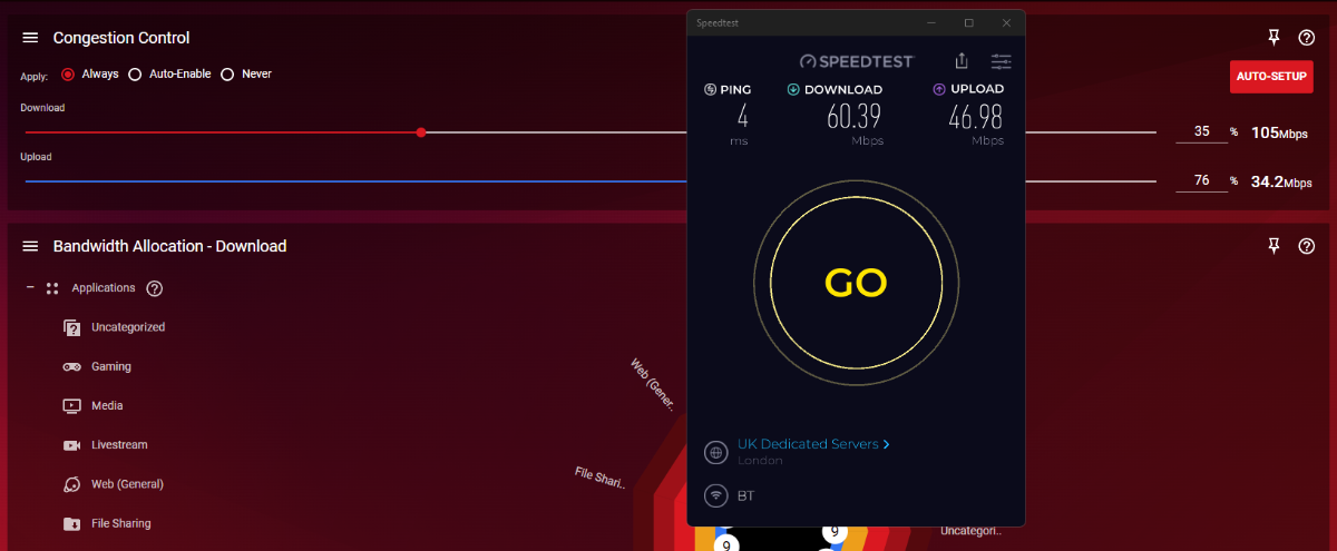

Seomos17 Posted May 29, 2025 Posted May 29, 2025 Hello, just recently purchased the XR1000V2 and I instantly recognized a problem with the QOS when I had finished setting things up. I'm not a techy guy when it comes to the router, my ISP is EE, and the XR1000 is connected directly to the ONT, connected pppoe. When setting limits for upload and download speed. download speed is limited just fine, but upload speed doesn't get limited at all I've tried a range of things from resetting the router to manually installing updates. Can someone help me?
Administrators Netduma Fraser Posted May 29, 2025 Administrators Posted May 29, 2025 It'll be due to PPPoE which is an issue we are aware of. Have the upstream modem/router/ONT handle PPPoE instead if possible so the XR just does DHCP and it will work

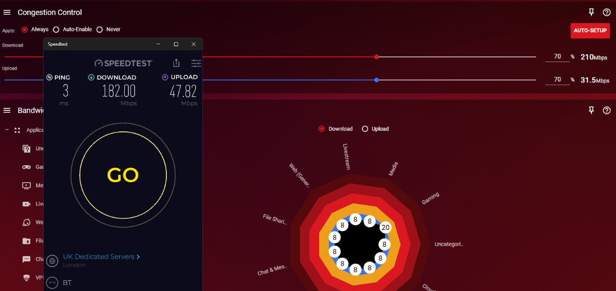

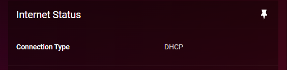

Seomos17 Posted June 6, 2025 Author Posted June 6, 2025 Sorry for the late reply, I Have the XR connected to the EE router which is connected into the ont and im still getting the same issue, The EE router is handling PPPoe. XR is on DHCP.
Seomos17 Posted June 6, 2025 Author Posted June 6, 2025 Got it to work by restarting EE router and the XR thank you.
Administrators Netduma Fraser Posted June 6, 2025 Administrators Posted June 6, 2025 Good to hear, thanks for posting the solution, have a great weekend!
Seomos17 Posted June 6, 2025 Author Posted June 6, 2025 It stopped working again... i didnt mess around with anything.
Administrators Netduma Fraser Posted June 6, 2025 Administrators Posted June 6, 2025 Check the Network monitor when it happens, is there any other device using a significant amount of bandwidth?

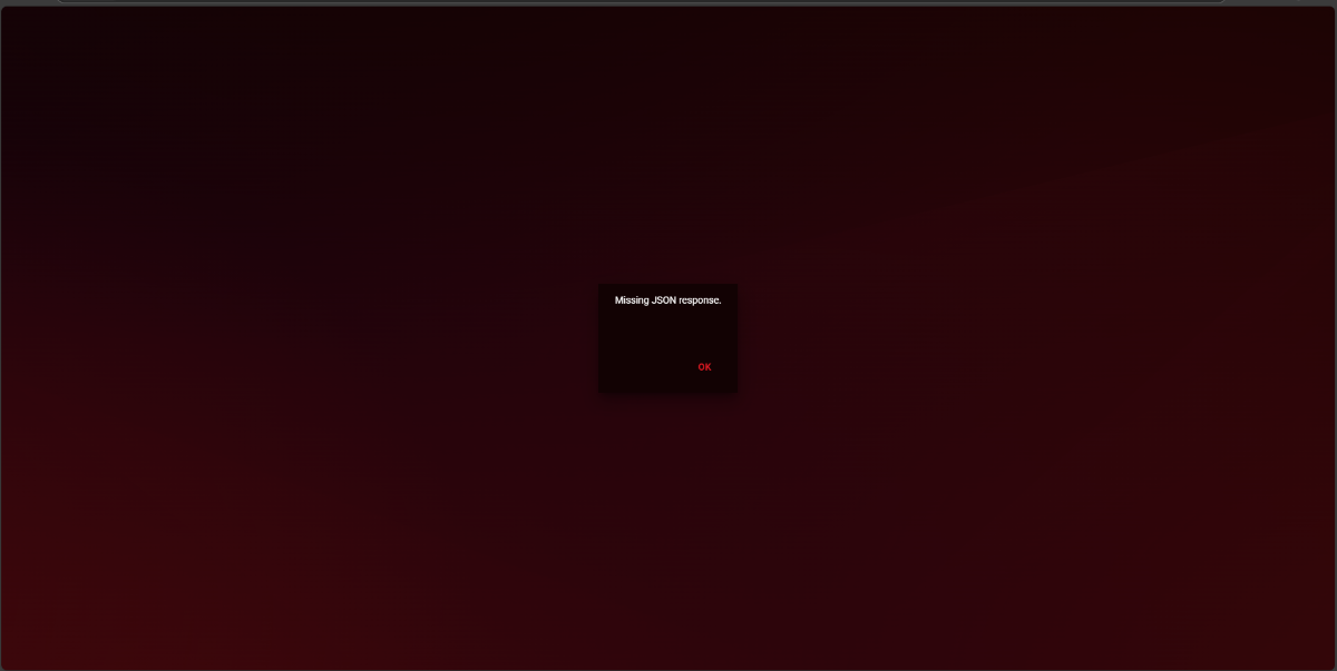

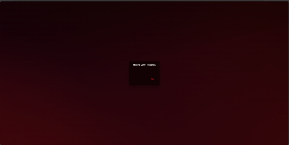

Seomos17 Posted June 7, 2025 Author Posted June 7, 2025 no there isnt. the router is now fully bugged qos works but geo filter doesnt work or traffic prioritization, most games do not show up on the duma classified games. restarted router after this now i cant get into dumo OS at all. i did put the xr on static ip on the ee router and also enabled DMZ on the ee router for XR.
Administrators Netduma Fraser Posted June 7, 2025 Administrators Posted June 7, 2025 This error is usually due to the browser forcing a connection to the interface via HTTPS rather than HTTP (e.g. Chrome, Safari etc), so using a different browser/disabling force HTTPS/adding an exception for the interface should resolve it. Otherwise a browser based Adblocker can cause it. What do you mean most games don't show up on classified games exactly? How have you added your device to the Geo-Filter, can you provide a screenshot?
