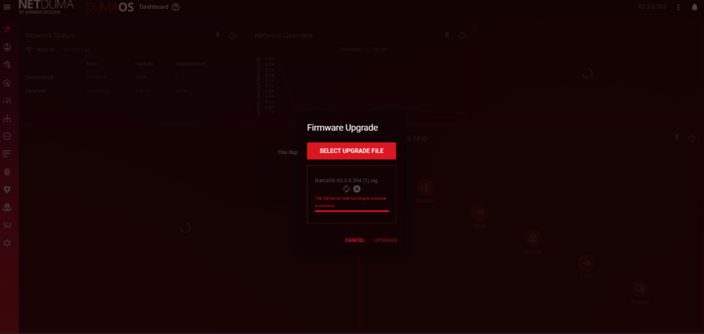

Jessicadavisonn Posted May 28, 2025 Posted May 28, 2025 I keep getting error messages when I try to update my netduma r2 it is on version v3.0.205 I am trying to do it on my pc with an ethernet cable I have tried latest firmware and the firmware after this one and I have also try factory rebooting and it just seems to get stuck. Any help please? The CGI script took too long to produce a response - this is example of error message when trying to update firmware
Administrators Netduma Fraser Posted May 29, 2025 Administrators Posted May 29, 2025 Reboot then try to upgrade to this version please: https://www.dropbox.com/s/ctjppykaasmorxp/DumaOS-R2-3.0.394.sig?dl=0

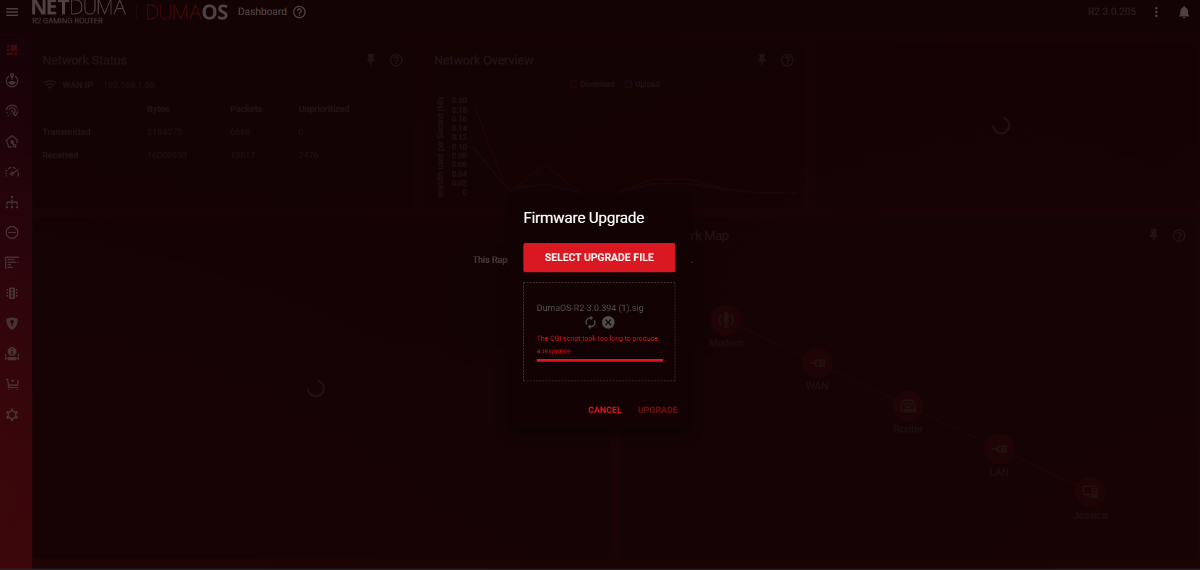

Jessicadavisonn Posted May 29, 2025 Author Posted May 29, 2025 The CGI script took too long to produce a response I keep getting this error , I am plugged in to my pc via ethernet cable too. Many thanks
Administrators Netduma Fraser Posted May 29, 2025 Administrators Posted May 29, 2025 Is this after a reboot? Are you accessing the interface via HTTPS rather than HTTP? Do you have a browser based Adblocker enabled, if so disable and try again please.
Jessicadavisonn Posted May 29, 2025 Author Posted May 29, 2025 yes after reboot no ad blocker and I am just typing in 192.168.77.7 to access the interface

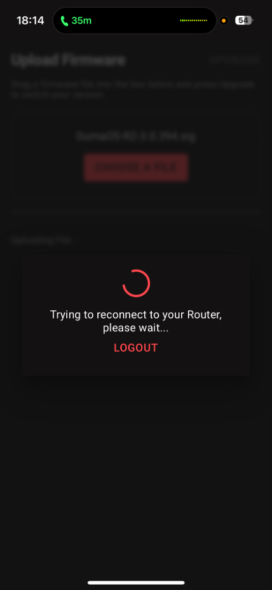

Administrators Netduma Fraser Posted May 29, 2025 Administrators Posted May 29, 2025 Download the firmware to your phone, then try upgrading via the DumaOS app please
Jessicadavisonn Posted May 29, 2025 Author Posted May 29, 2025 I have tried and tried in incognito mode on pc it is like it starts to update then just can’t and gets stuck for long time and doesn’t do anything then when I try access interface this happens and nothing works until I unplug it again no matter how long I leave it

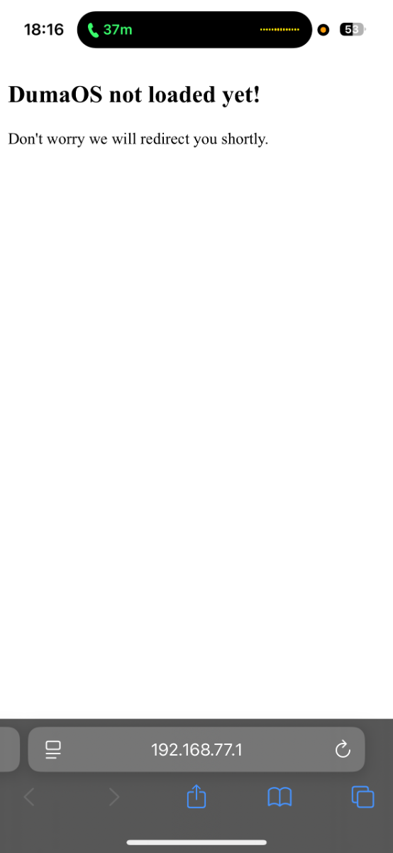

Fairypusher Posted June 1, 2025 Posted June 1, 2025 I have a Bug after Update. I connect the WAN from R2 to Lan1 from my Router with Internet. After this the Setup from R2 found Internet and run DumaOS. After that i can use PPPOE, PPPOE dont work right for me with Setup. DumaOS dont start. If your Dumaos dont start. Now you can read the log. 192.168.77.1/adv_index.htm I use Static IP
Administrators Netduma Fraser Posted June 1, 2025 Administrators Posted June 1, 2025 6 hours ago, Fairypusher said: I have a Bug after Update. I connect the WAN from R2 to Lan1 from my Router with Internet. After this the Setup from R2 found Internet and run DumaOS. After that i can use PPPOE, PPPOE dont work right for me with Setup. DumaOS dont start. If your Dumaos dont start. Now you can read the log. 192.168.77.1/adv_index.htm I use Static IP I responded to you in another topic but please make your own topic

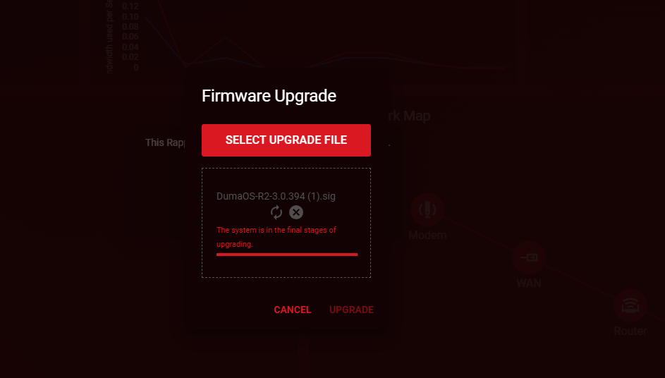

Jessicadavisonn Posted February 24 Author Posted February 24 I've only just got round to doing this now, tried to update and still won't is there anychance of someone forcing the update for me with remote access at all if I can enable this?
Administrators Netduma Fraser Posted February 24 Administrators Posted February 24 51 minutes ago, Jessicadavisonn said: I've only just got round to doing this now, tried to update and still won't is there anychance of someone forcing the update for me with remote access at all if I can enable this? Factory reset then try to upgrade again please as soon as you can access the interface. If it doesn't work please follow my previous instructions about making your router accessible and then I can see if a colleague can push it through for you.

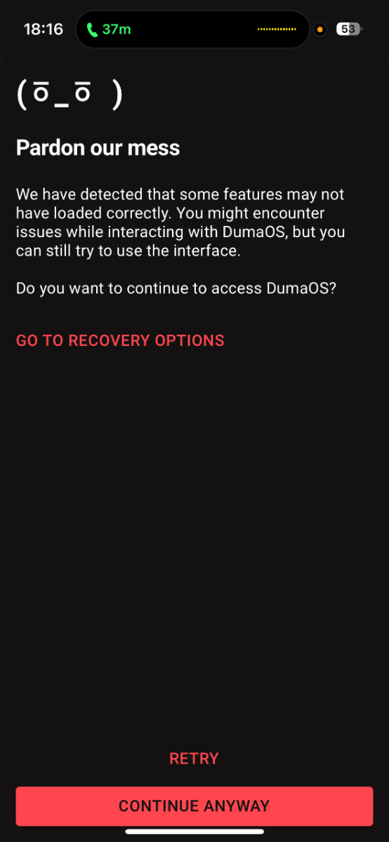

Jessicadavisonn Posted February 24 Author Posted February 24 when i factory reset then do the upgrade i cant no longer access the interface and it stays stuck
Administrators Netduma Fraser Posted February 24 Administrators Posted February 24 Factory reset again, close the interface then wait 4 minutes before trying to access and you should be able to access fine. I still can't ping you but I'll let them know, maybe they can access, will let you know when I've heard back, likely a few days
