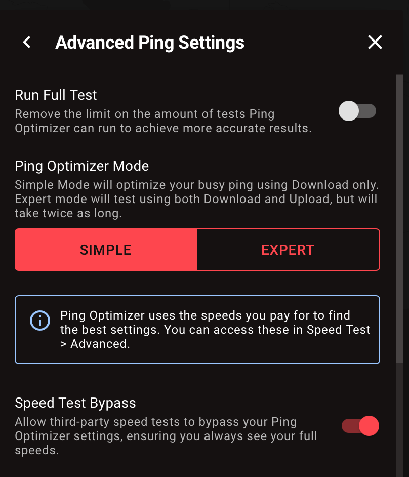

Administrators Netduma Fraser Posted May 27, 2025 Administrators Posted May 27, 2025 Bridge or having the R3 in its DMZ would be best yes. Congestion Control is what Ping Optimizer sets, you can adjust it manually in Ping Optimizer > Advanced, how is it set? How have you setup SmartBOOST?

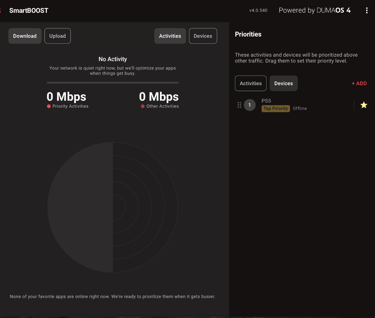

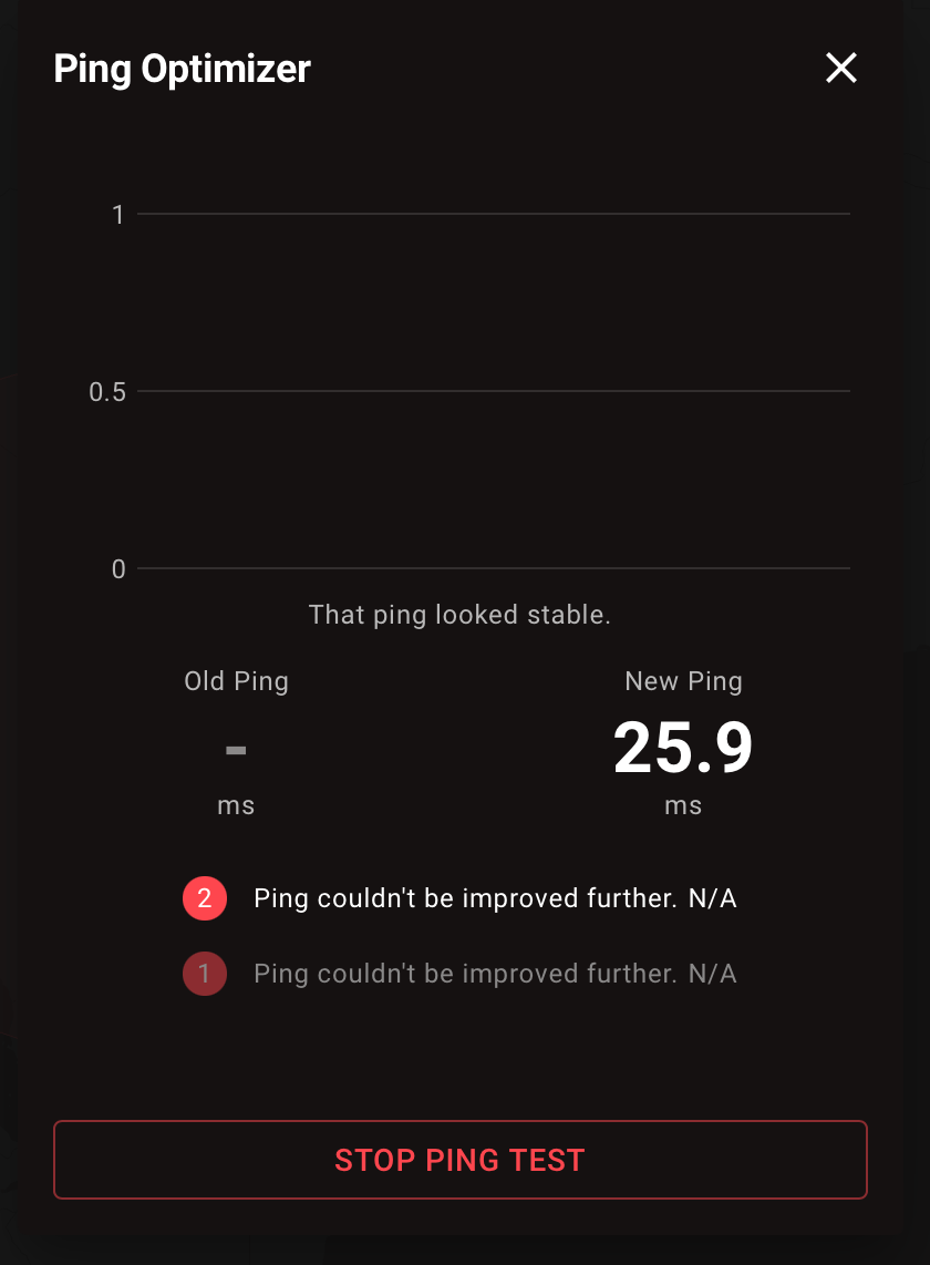

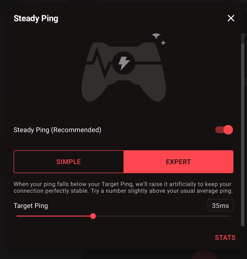

xmacx7 Posted May 27, 2025 Author Posted May 27, 2025 13 minutes ago, Netduma Fraser said: Bridge or having the R3 in its DMZ would be best yes. Congestion Control is what Ping Optimizer sets, you can adjust it manually in Ping Optimizer > Advanced, how is it set? How have you setup SmartBOOST? the nearest server to me 17m and without steady ping, my ping at the game 18 While enable the simple steady ping, the ping always 28 or 35 So I tried to make it expert, but the gameplay is the same this is how I install the Smartboost and this is the Ping Optimizer

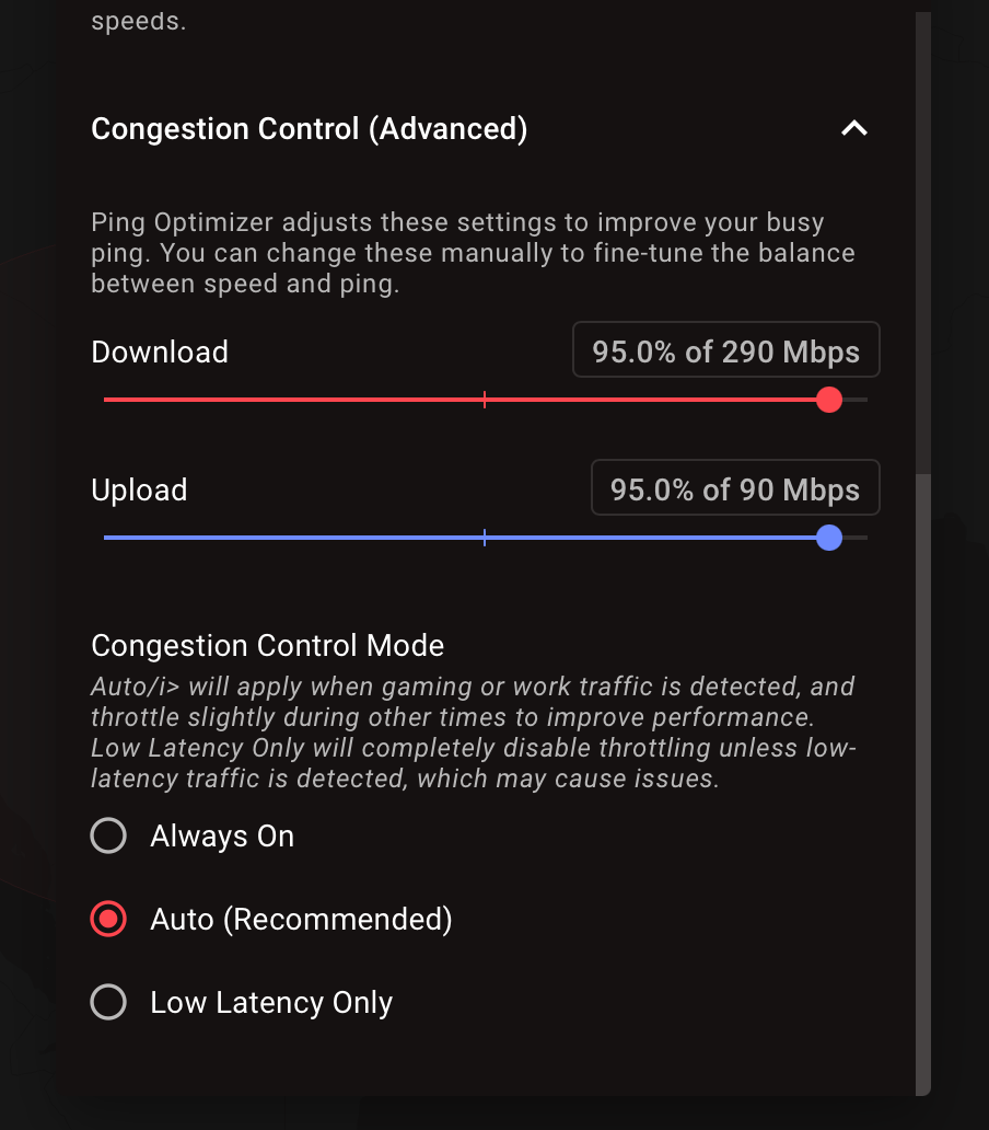

Administrators Netduma Fraser Posted May 27, 2025 Administrators Posted May 27, 2025 Presumably you'd want to set Steady Ping to somewhere in between it being off/on so +5ms above your normal ping so set to 23/24ms something like that and try it. Not Ping Optimizer, go to Ping Optimizer > Advanced, how is Congestion Control setup there?
xmacx7 Posted May 27, 2025 Author Posted May 27, 2025 6 minutes ago, Netduma Fraser said: Presumably you'd want to set Steady Ping to somewhere in between it being off/on so +5ms above your normal ping so set to 23/24ms something like that and try it. Not Ping Optimizer, go to Ping Optimizer > Advanced, how is Congestion Control setup there? this is how the Congestion Control
Administrators Netduma Fraser Posted May 27, 2025 Administrators Posted May 27, 2025 Try with download & upload at 70% each and see if your overall experience improves xmacx7 1
xmacx7 Posted May 27, 2025 Author Posted May 27, 2025 1 minute ago, Netduma Fraser said: Try with download & upload at 70% each and see if your overall experience improves Really Appreciate your kind support Netduma Fraser 1
xmacx7 Posted May 30, 2025 Author Posted May 30, 2025 On 5/27/2025 at 9:01 PM, Netduma Fraser said: Try with download & upload at 70% each and see if your overall experience improves I tried serval games with steady ping simple and the gameplay too much slow, also tries to make it expert with 20ms , 25, 30, and 35ms but all the same slowness, and looks like I am playing on ping 200ms if I disable the steady ping feature. the game better than while enable it, is there a way to make the steady ping feature useful?
Administrators Netduma Fraser Posted May 30, 2025 Administrators Posted May 30, 2025 6 hours ago, xmacx7 said: I tried serval games with steady ping simple and the gameplay too much slow, also tries to make it expert with 20ms , 25, 30, and 35ms but all the same slowness, and looks like I am playing on ping 200ms if I disable the steady ping feature. the game better than while enable it, is there a way to make the steady ping feature useful? Some people don't get on with Steady Ping, if it's better without then disable it and continue just by forcing the closest servers instead
