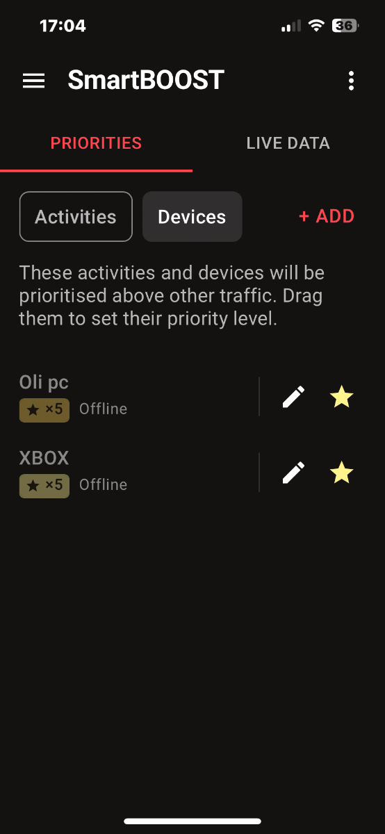

talbyfish Posted May 25, 2025 Author Posted May 25, 2025 1 hour ago, talbyfish said: Trying now, how do I reserve bandwidth. On ping plotter av had to drop me speed from 800 down to 260 down, the upload from 110 to 56. lost a lot of download speed is this normal, back in the r1 days it was always the upload that caused lag but mine is all happening on downloads at the minute
Administrators Netduma Fraser Posted May 25, 2025 Administrators Posted May 25, 2025 6 hours ago, talbyfish said: Trying now, how do I reserve bandwidth. Click the 3 dots icon top right on the SmartBOOST page Click Favorites Primary Profile Click the icon top right of that panel 4 hours ago, talbyfish said: On ping plotter av had to drop me speed from 800 down to 260 down, the upload from 110 to 56. lost a lot of download speed is this normal, back in the r1 days it was always the upload that caused lag but mine is all happening on downloads at the minute As in you've got Congestion Control down that low or you've actually put your speeds down? Downloads more commonly cause lag compared to uploads

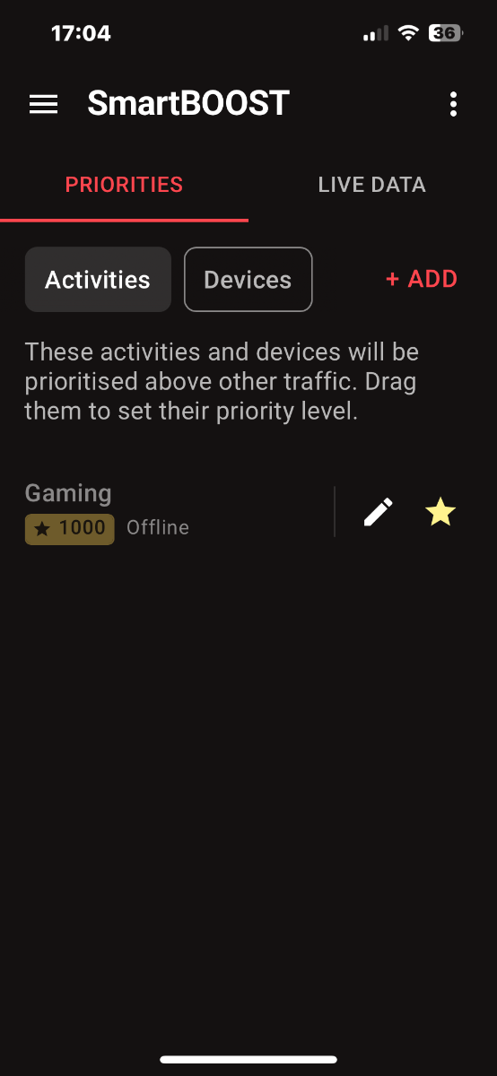

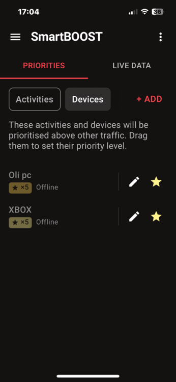

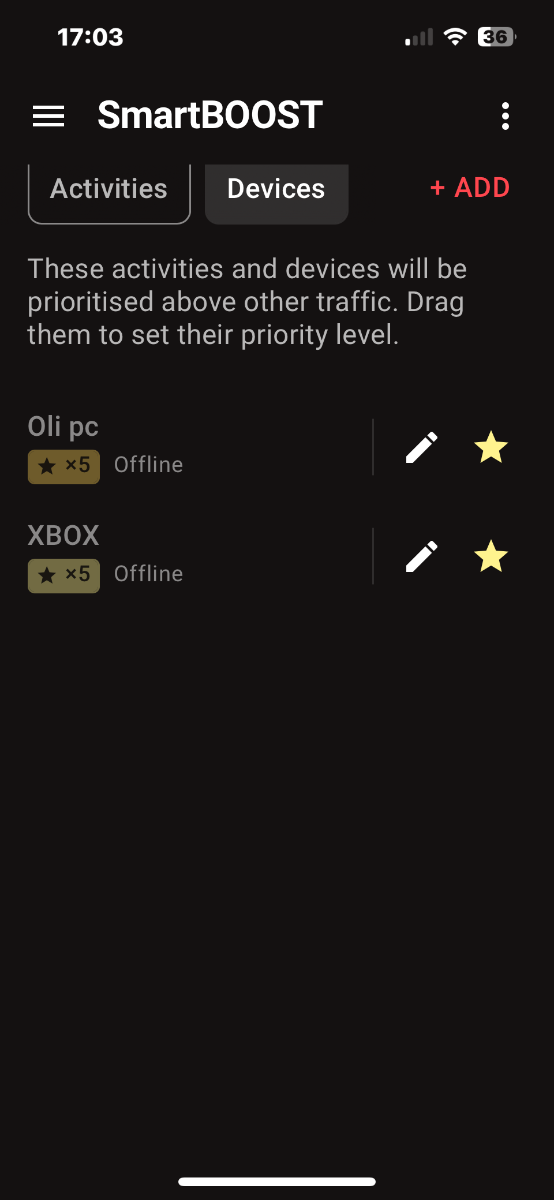

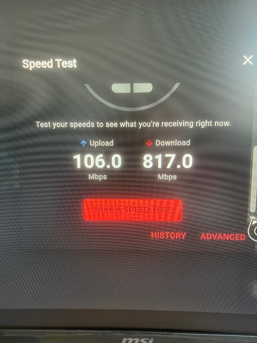

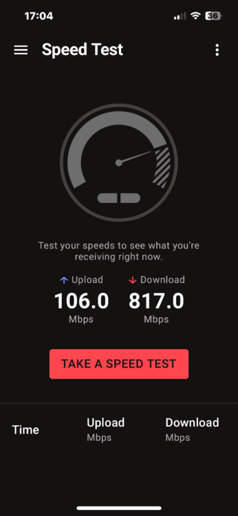

talbyfish Posted May 30, 2025 Author Posted May 30, 2025 OK av been messing bout and can’t get it to work proper, my son is on pc, gaming and chatting using about 3mbps up and down max. I have his pc set to priority all ports 1 to 65335 or what ever it is, also have gaming set to 1000 top priority but when start my Xbox game update he starts lagging instantly yet my download speed is only 200mbps and my download speed is over 800, should this be happening or am I doing something wrong? might have to reset and start again ??

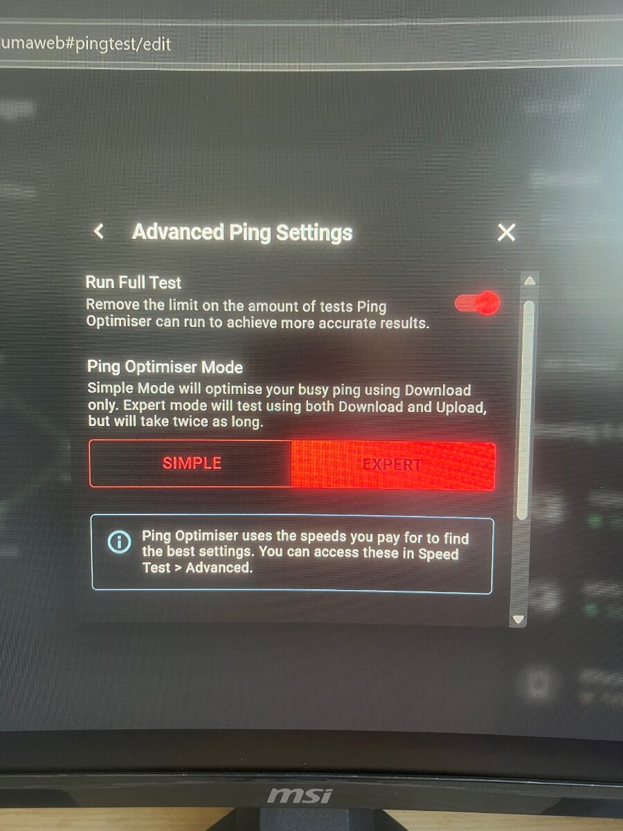

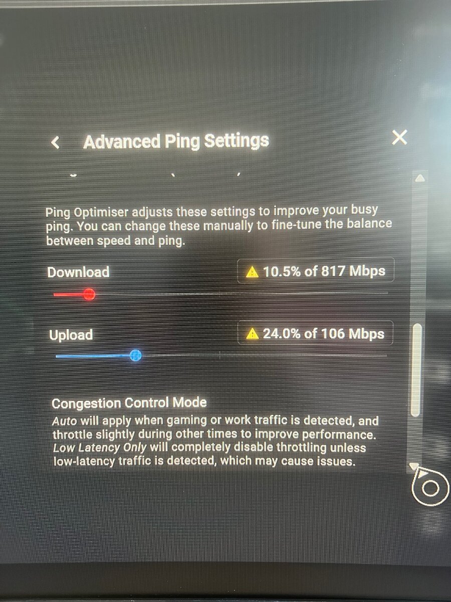

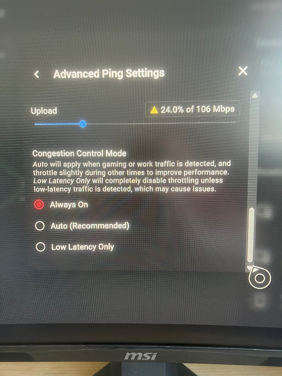

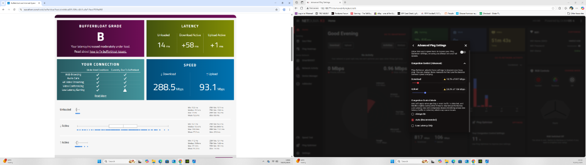

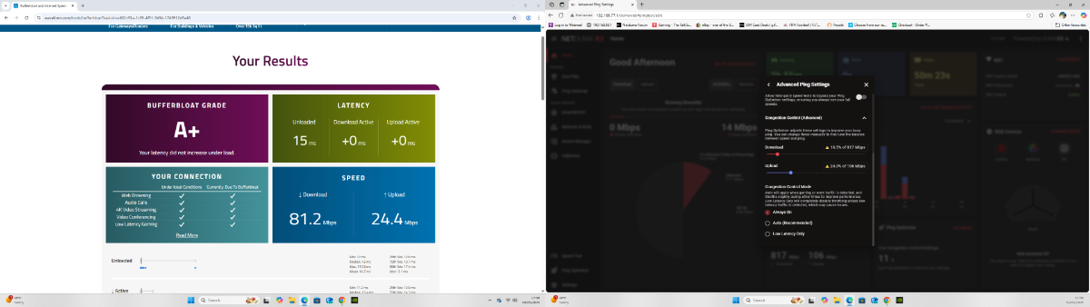

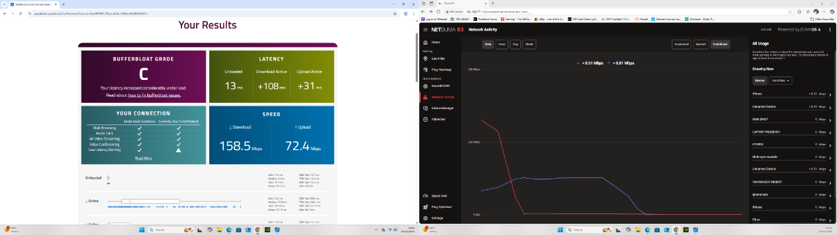

talbyfish Posted May 30, 2025 Author Posted May 30, 2025 Yea, I have found auto doesn’t work so I have had to drop my speeds to 10% download and 50% upload to stop games lagging if someone watches a video or downloads anything. Even if the video is only downloading at 25mbps I have over 800 spare but still lags. Am currently using only 80mbps download with always on ticked.
talbyfish Posted May 30, 2025 Author Posted May 30, 2025 Also reserving 20% down and up makes no difference to lag when someone watches a video

Administrators Netduma Fraser Posted May 30, 2025 Administrators Posted May 30, 2025 Switch SmartBOOST back to the basic, not advanced. Where else have you changed settings e.g. DMZ, port forwarding, internet rules etc

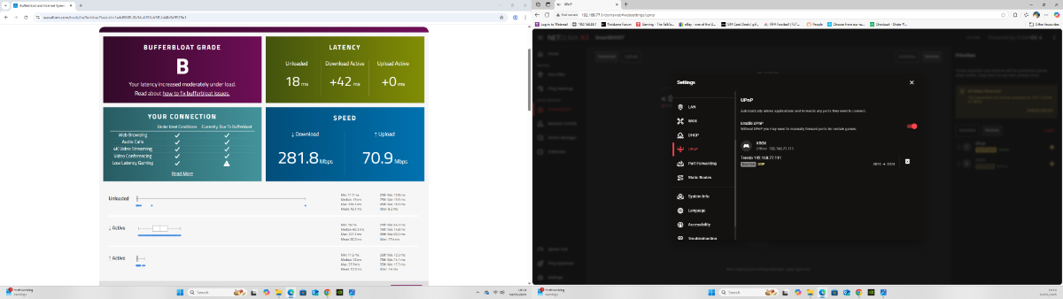

Administrators Netduma Fraser Posted May 30, 2025 Administrators Posted May 30, 2025 Disable the DMZ and take off those reservations then try again. The percentages you got with Congestion Control, that was really the best you found when following the PingPlotter instructions?

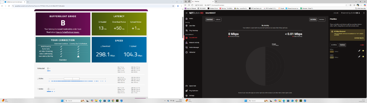

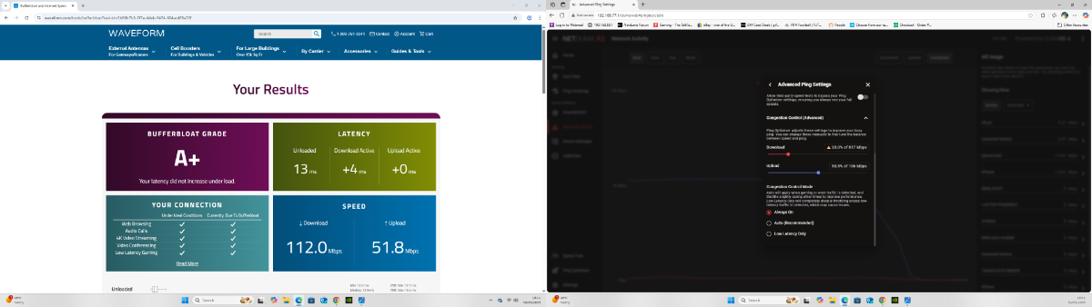

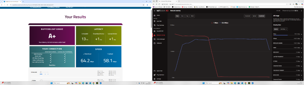

talbyfish Posted May 30, 2025 Author Posted May 30, 2025 yes al try ping plotter again now, here are some screen shots i took but might be pointless becouse i have changed the things you said.

Administrators Netduma Fraser Posted May 30, 2025 Administrators Posted May 30, 2025 Having the Xbox in the DMZ while you do those tests is going to skew the results so take that out, you should remove that anyway, then proceed with below. PingPlotter link/instructions from my 1st response On 5/24/2025 at 7:08 PM, Netduma Fraser said: Rather than focusing on a letter grading I'd suggest following this guide https://support.netduma.com/frequently-asked-questions/legacyfaqs/test-your-ping/ while downloading & start with 95% for Congestion Control (set to Always), check results, decrease by 10%, check, decrease by 10% etc, until you get to a value that is pretty good & then try 5% either side of that value to see if it can be improved. Download & Upload on Congestion Control don't have to be the same value & you may have a better experience with differing values. This will be better as it's a real world test and you'll be able to see how your changes effect it in real time and adjust from there.
talbyfish Posted June 1, 2025 Author Posted June 1, 2025 Done all the ping plotter tests again on pc and I get lag spikes when I run a speed test on my iPhone, I need to set my download to 20% which is about 160mbps. This was with YouTube playing and a few twitch streams
Administrators Netduma Fraser Posted June 1, 2025 Administrators Posted June 1, 2025 Could you provide the screenshot of the best results you got on PingPlotter please?
