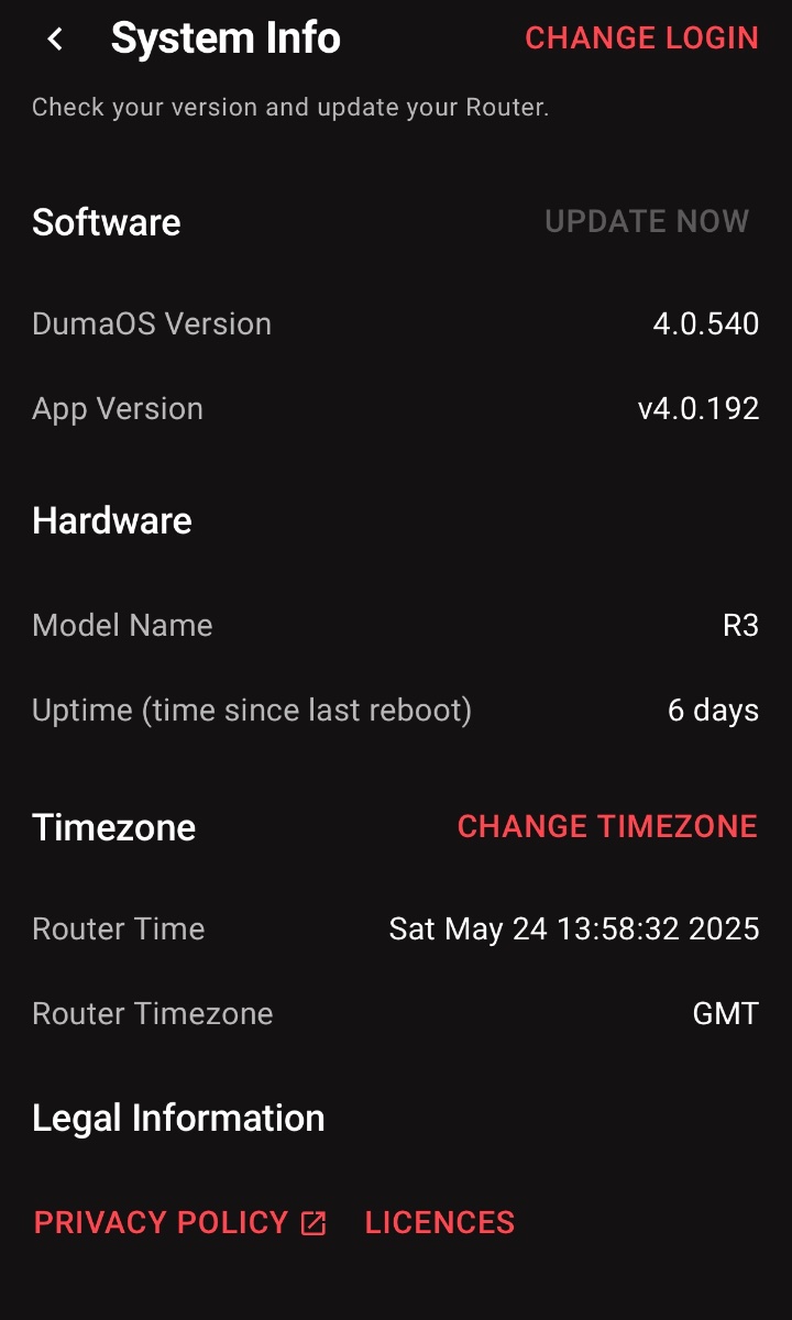

Administrators Netduma Fraser Posted May 24, 2025 Administrators Posted May 24, 2025 What DumaOS router are you using and what firmware is it on? What is the model of the modem/router the DumaOS router is connected to and how have you set that to ensure all traffic flows to the DumaOS router? E.g DumaOS router in its DMZ, modem/bridge mode Are ALL devices connected to the DumaOS router? What are the speeds you pay for/receive? Have you entered those speeds into the router? How have you setup Congestion Control? How have you setup SmartBOOST/Traffic Prioritization? What platform are you playing on and how is it connected, via ethernet or WiFi?
Kevin.pal Posted May 24, 2025 Author Posted May 24, 2025 I have done all the correct setting. Perhaps cod was giving me spike in ping? Overload servers caused this?
