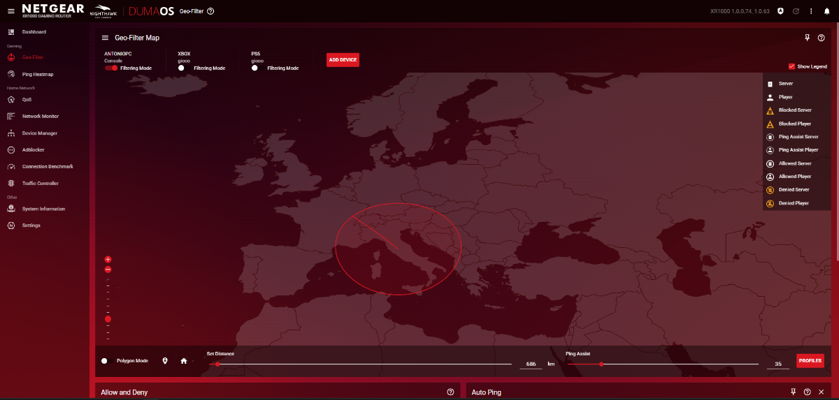

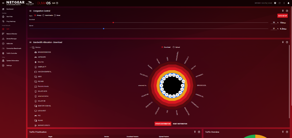

Anto_2000 Posted May 18 Author Posted May 18 On ISP router I set static IP for xr1000 IP on dhcp settings and i double checked it's the correct IP right now. I got 45 mbps (down) and 19 mbps (up). My qos is 35% down and 31% up with traffic priority on every device. Geo filter is configured to get 35 ms max server but if i get 40ms server i still got spike lags

Administrators Netduma Fraser Posted May 18 Administrators Posted May 18 Your QoS percentages are really low, I don't think you need to have them that low down. Traffic Priority on every device basically means you have traffic priority on no device, you've made them all equal. Just prioritize your game rather than everything. Do you mean you've set Ping Assist for the Geo-Filter? If you could provide some screenshots of the QoS and Geo-Filter pages I can take a look

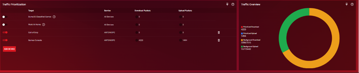

Anto_2000 Posted May 18 Author Posted May 18 50 minutes ago, Netduma Fraser said: Traffic Priority on every device basically means you have traffic priority on no device, you've made them all equal. Just prioritize your game rather than everything. I mean the traffic priority is set for every device i play cod (pc, xbox and ps5) and not vot every device i connected.
Anto_2000 Posted May 18 Author Posted May 18 Iìì 51 minutes ago, Netduma Fraser said: Your QoS percentages are really low, I don't think you need to have them that low down. I tried the automatic QOS setup but i got lags for bufferbloat so I reduce it testing till I got 0 bufferbloat
Anto_2000 Posted May 18 Author Posted May 18 1 hour ago, Netduma Fraser said: Do you mean you've set Ping Assist for the Geo-Filter? If you could provide some screenshots of the QoS and Geo-Filter pages I can take a look I just reset the rputer recently so in traffic overview there are no Prioritized Download.
Administrators Netduma Fraser Posted May 18 Administrators Posted May 18 Put Ping Assist at 0 otherwise you can get games higher than that and outside your radius too. Follow this guide https://support.netduma.com/en/support/solutions/articles/16000074717-how-to-test-your-internet-ping while downloading & start with 95% for Congestion Control (set to Always), check results, decrease by 10%, check, decrease by 10% etc, until you get to a value that is pretty good & then try 5% either side of that value to see if it can be improved. Download & Upload on Congestion Control don't have to be the same value & you may have a better experience with differing values. This will be more of a real world test.
Anto_2000 Posted May 18 Author Posted May 18 ping assist is set to 35ms but if i set it to 0, nothing changes because with this settings i did 9 month ago, never got any issue so i don't understand why I should test again if i'm already on a low %. The link you posted : 404 This page could not be found.
Administrators Netduma Fraser Posted May 18 Administrators Posted May 18 Networking has many variables, what may have worked 9 months ago won't necessarily work now. A low percentage doesn't mean better necessarily, here's the correct link to use: https://support.netduma.com/frequently-asked-questions/legacyfaqs/test-your-ping/
Anto_2000 Posted May 25 Author Posted May 25 I did everything you told me, I got a new setting for qos with 25mbps on download but i still see spike lags on geo filter ping graphics so i don't know if the graphics is broken. The cod ping telemetry told me 20/21 ms but on duma os ping graphics I see ping goes from 21 to 50 and back to 21 in less than a second
Administrators Netduma Fraser Posted May 25 Administrators Posted May 25 5 hours ago, Anto_2000 said: I did everything you told me, I got a new setting for qos with 25mbps on download but i still see spike lags on geo filter ping graphics so i don't know if the graphics is broken. The cod ping telemetry told me 20/21 ms but on duma os ping graphics I see ping goes from 21 to 50 and back to 21 in less than a second If you followed the steps correctly for PingPlotter and got the best percentages for Congestion Control then you can rule out lag coming from your side. In which case the spike in the game ping would be on the game side, or on your ISP side but basically outside your control at that point
