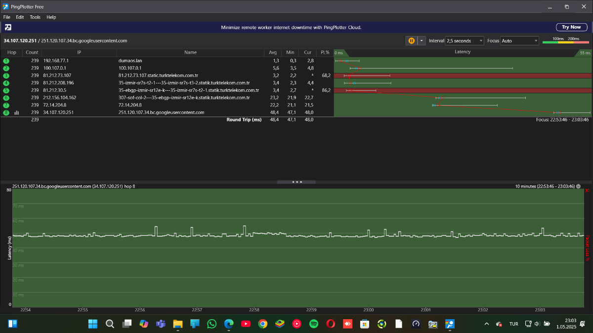

Hello, i'm using netduma r3 and duma os version v4.402 which is i tried thousands times fit with my internet, i'm mostly playing e football, i'm from turkey and here has no server for this game, i want to attach some pictures, while i am playing game i am going to insane, no stabilizasyon or never felt comfartable, my ping is not too bad , i have package lost many, maybe i dont know what is the most effective configuration or something, please give me many idea to fix something a little , thank you ...

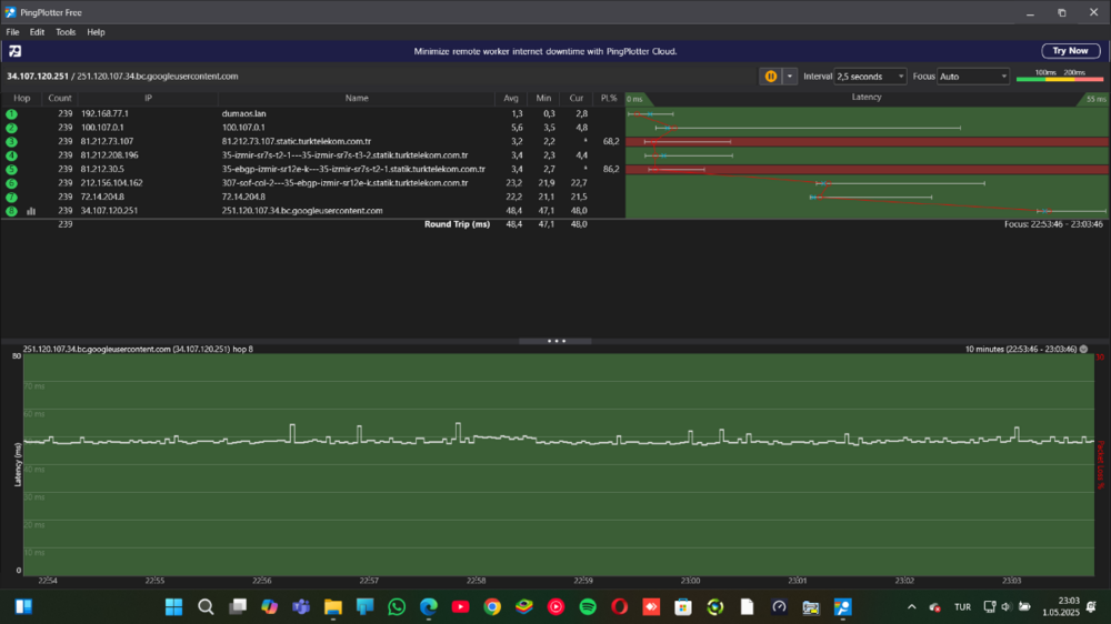

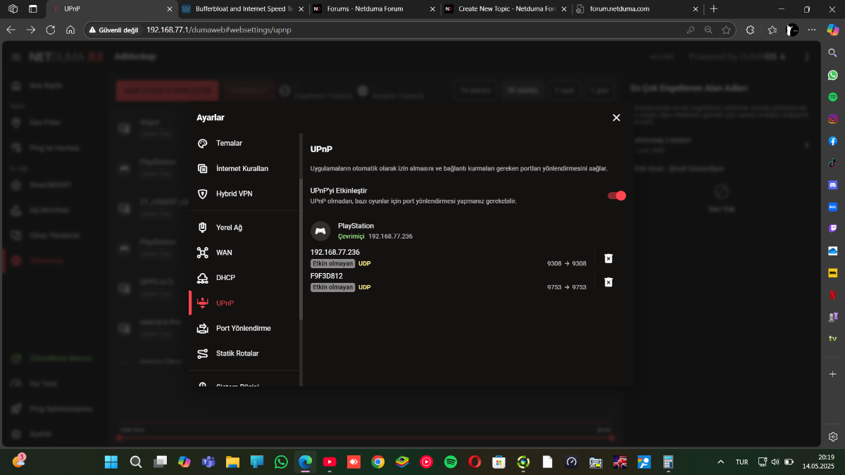

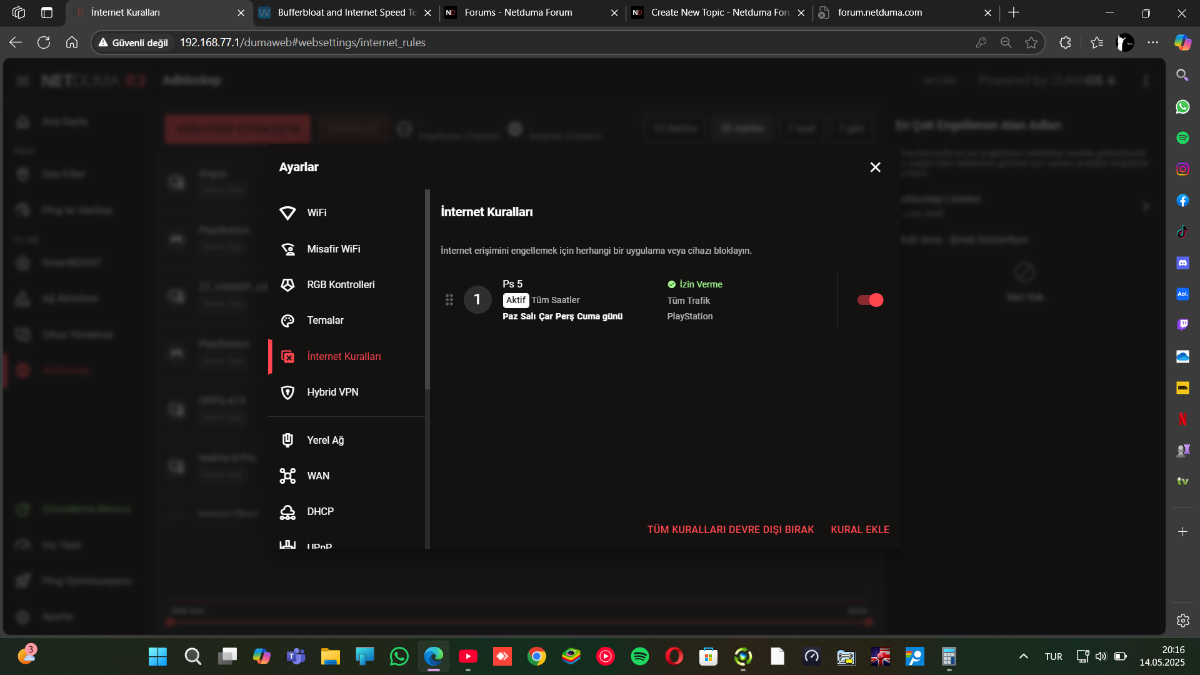

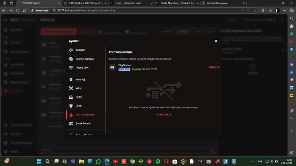

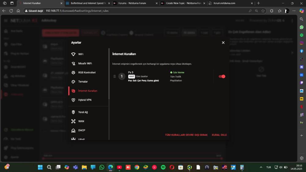

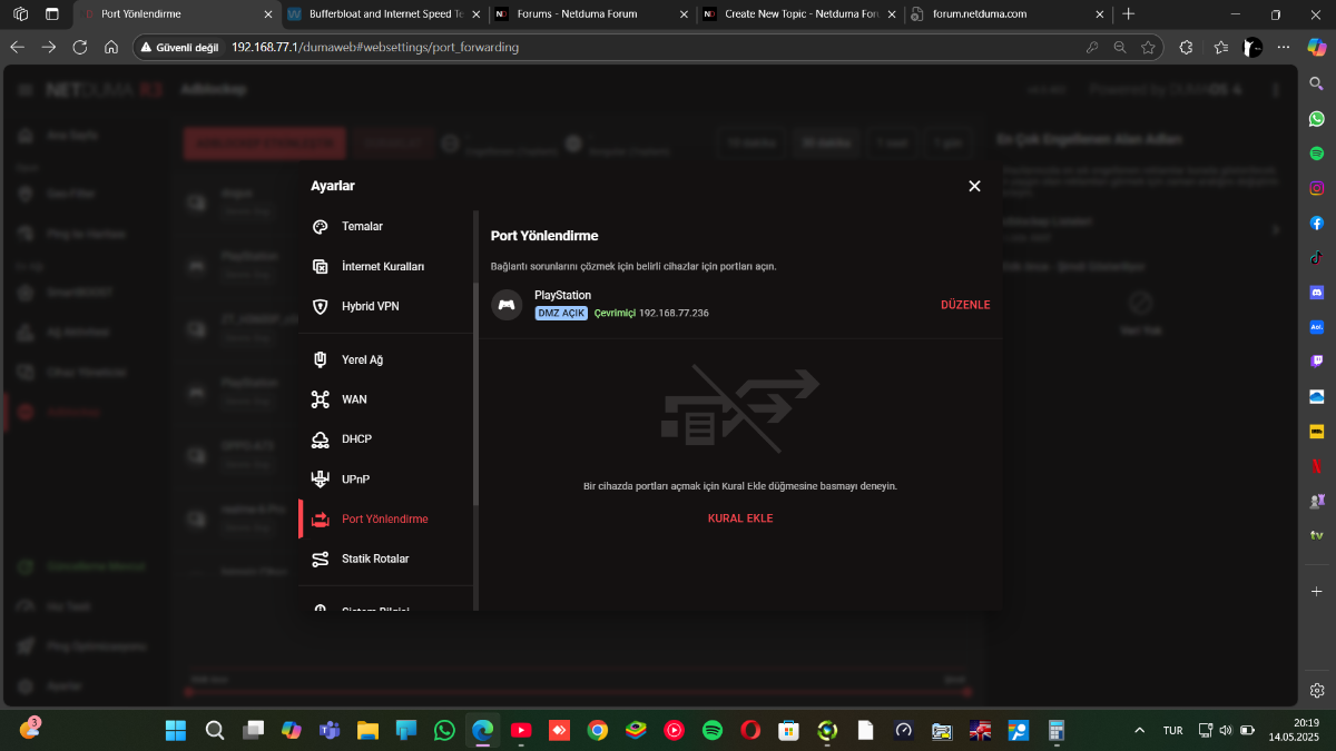

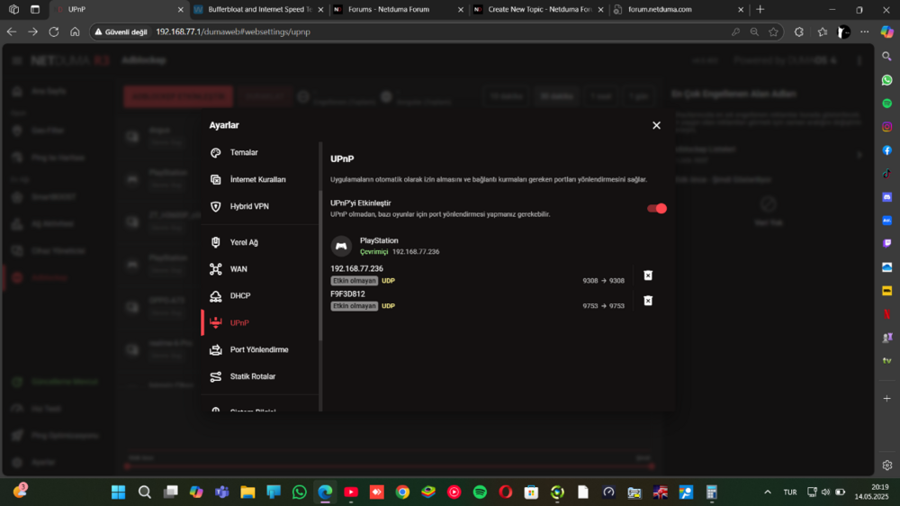

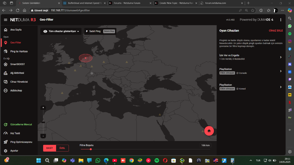

You don't need to port forward, use UPnP and the DMZ all at the same time, that could cause some conflicts, disable port forwarding. Also remove the internet rule you've made for the console. It looks like you've changed Geo-Filter settings while on the game, make your changes before you launch the game, then if you need to make a change restart the game afterwards.

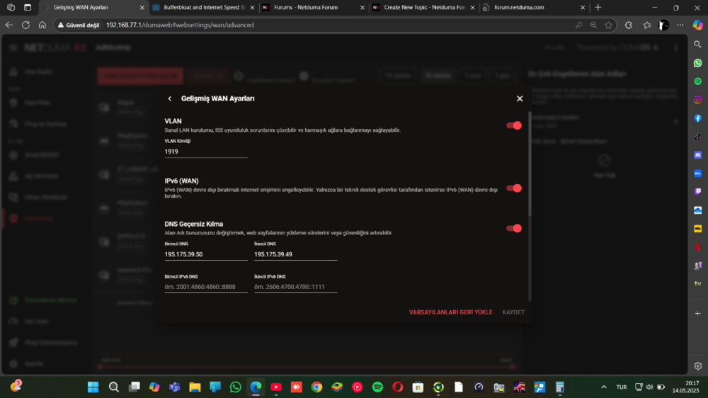

i did not make anything about port forward i was thinking, i did what you said now, by the way i have ethernet fiber connection as you saw at the pictures i'm connecting directly to netduma with wan ethernet port not another iss modem or bridge mode or something else , just with cable and with vlan id, is there any problem with that ? and my other questions are

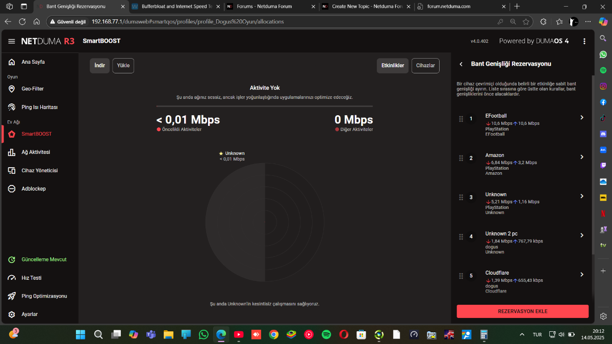

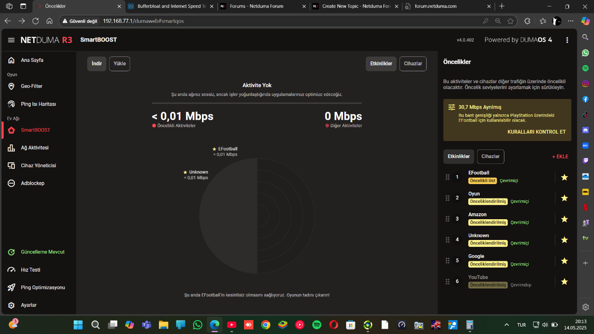

1- at the smart boost menu i made something on my own to give down / up values to the games or programme or the other , is there any logical way to give the mgbte value to the programme or games in this menu ?
2- and in this smart boost menu there is a place : smart statistics, in smart statistics there are automatic allocation point, this one is changing whichever i put some value to someting?

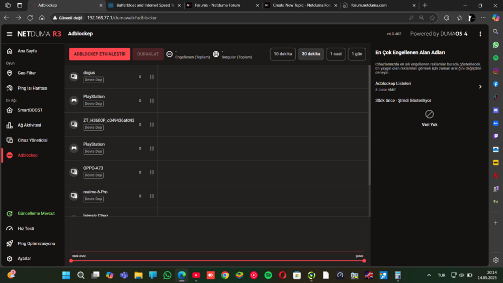

3-what should i do at adblocker menu? block something or ?

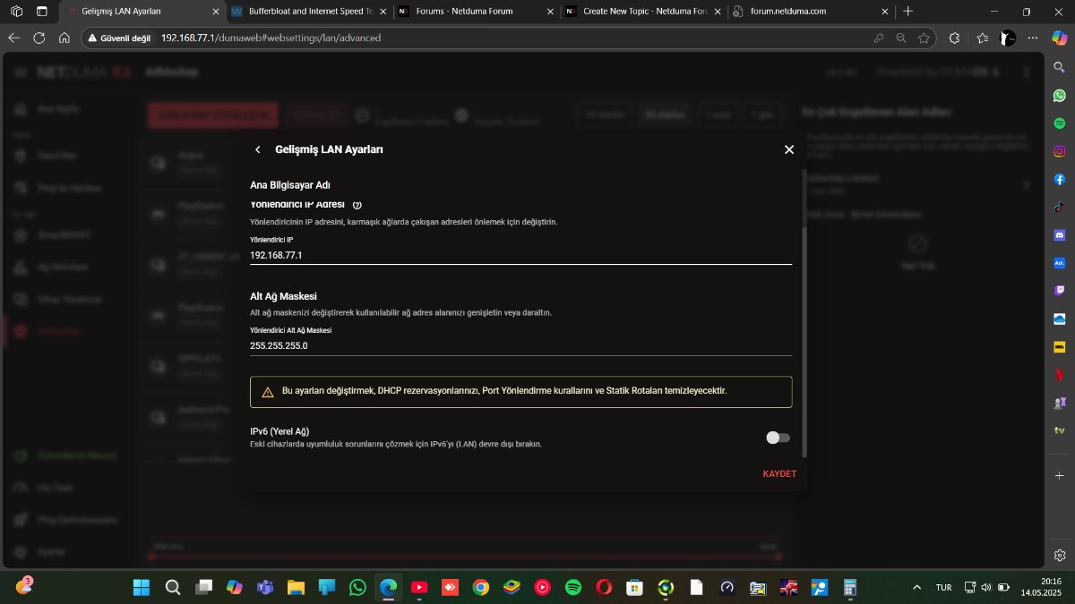

4- settings->local area->advanced menu ipv6 bar, i closed it , what i need to do, closed or opened ?

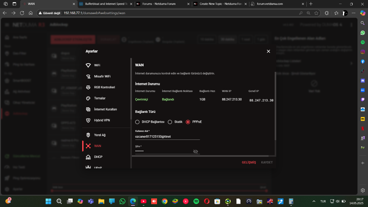

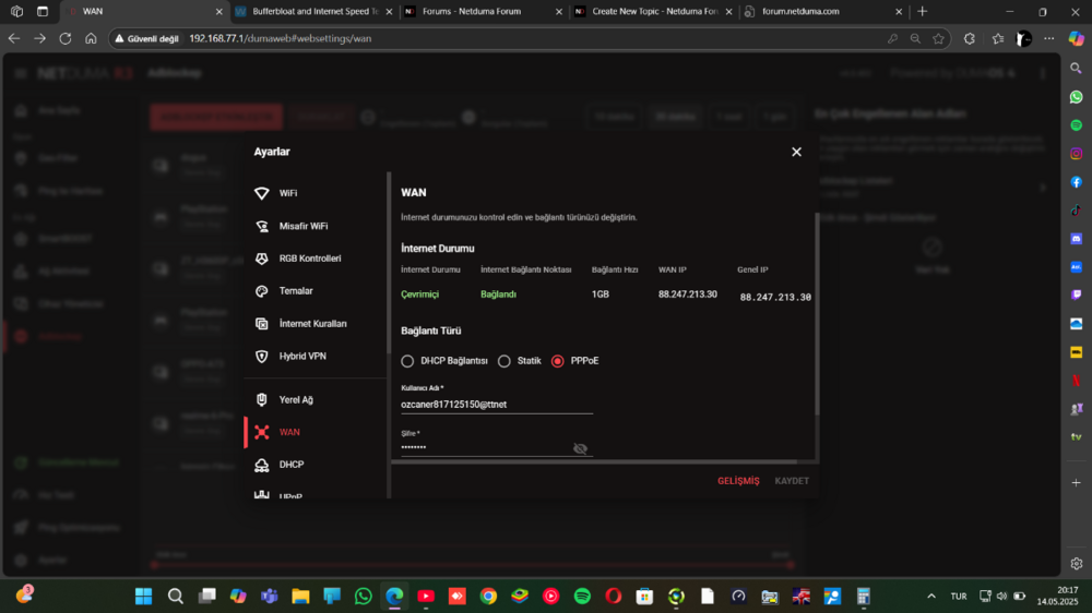

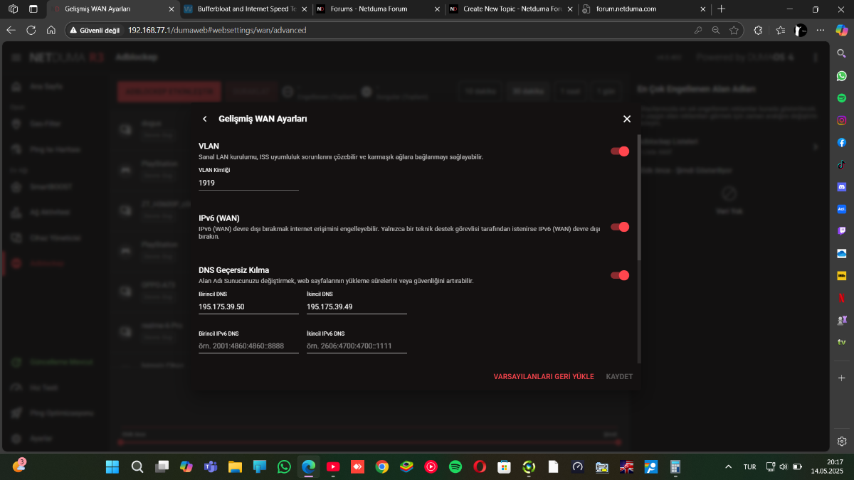

5- in the wan menu , you can see at picture my public ip and wan ip it looks same ip which is my static ip that i get it from my iss , is that normal ?
6- in dns menu i put my iss dns's , i got dnss from iss modem , is that ok or i need to change them ?

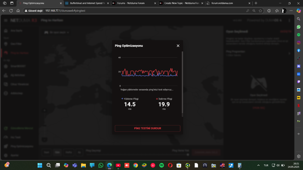

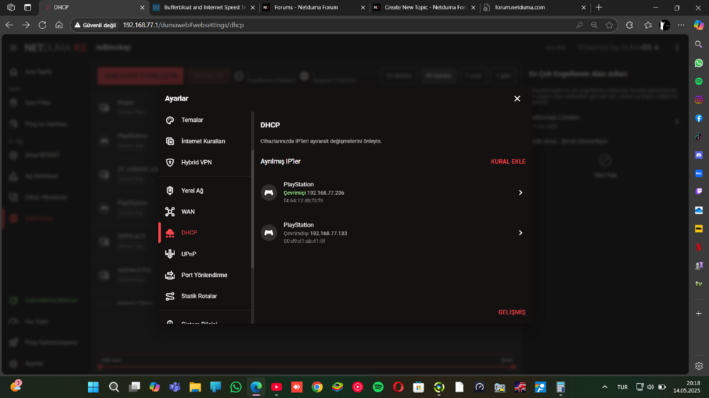

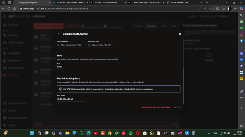

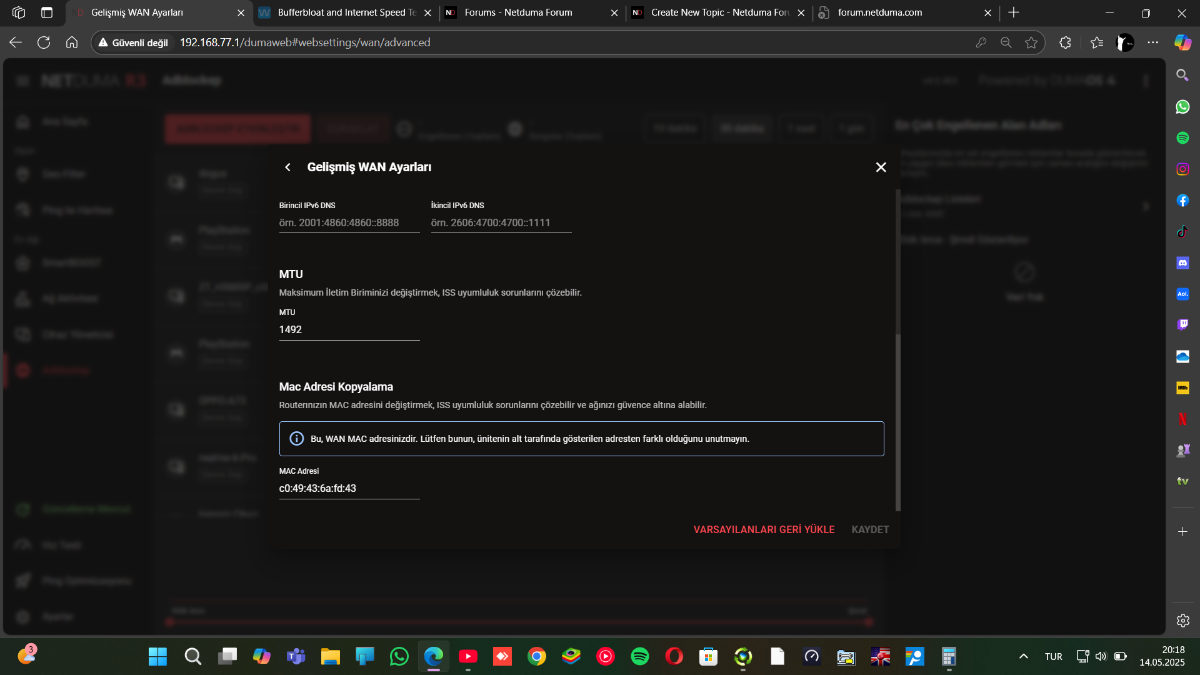

7-and mtu value, i found it with different ways on youtube videos, i put that value on all mtu places , modem, pc modem preferences or anything, it was 1500 before and i have some packet lost which you can see ping plotter test on my picture, i dont know what to do about packet lost and i wondered if it about mtu value or not , what should i do ?

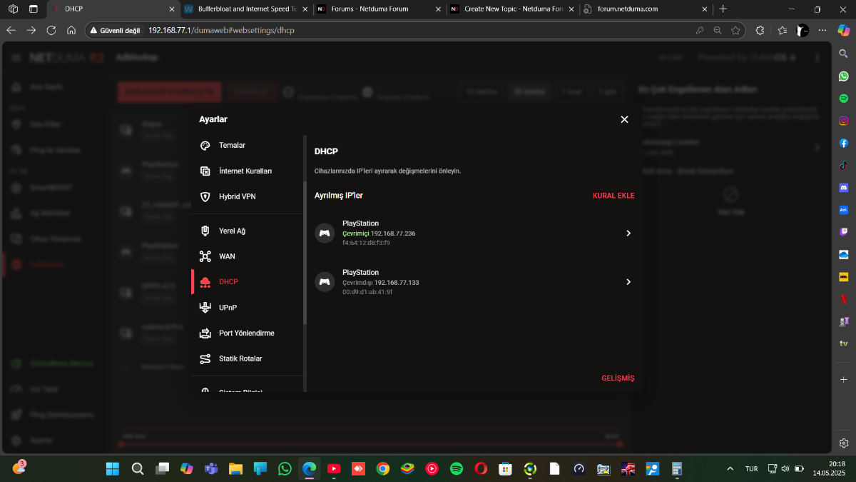

8-what is dhcp leasing time , i wrote there 1440 and i found it on this forum or i learned it or i want to try, what should i wrote there  ?

  1. I'm not sure what you mean exactly but allocating bandwidth to gaming won't do much, games barely use 1Mbps.
  2. Not sure what you mean
  3. Adblocker is for Advertisements, it makes no difference to gaming, it's personal preference
  4. You can keep it disabled
  5. Yes its normal
  6. That's fine
  7. You can ignore the packet loss from Ping Plotter, you don't actually have any (it would show on the bottom graph if you did). I'd keep MTU at the default or make sure the value you've set isn't fragmenting, either way it won't impact gaming either.
  8. This won't impact gaming either but put in 10000. It determines how often your local IP addresses change for the devices
