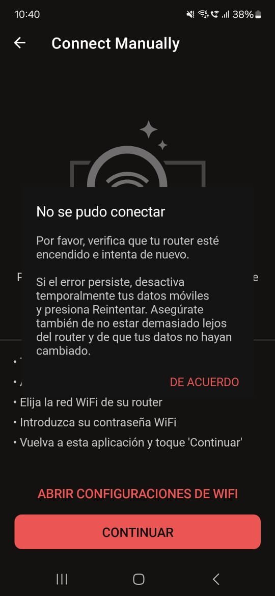

I'm having trouble connecting to the router with DumaOS Android.
Netgear XR1000 - XR1000 1.0.0.74_1.0.63
DumaOS Version 3.1.2
Android DumaOS version: 1.3.15
I tried from the app:
- Configure by selecting Nighthawk Pro Gaming XR1000, following the prompts (no result)
- Manual configuration, entering the IP or http://www.routerlogin.net/ following the prompts (no result)
- Uninstall and install the app (no result)
- My router doesn't have the default configuration. I changed the LAN and WAN IPs, trying to connect to both (no result)
- I restarted the router and waited 5 minutes (no result)
- I disconnected the LAN INTERNET cable (no result)

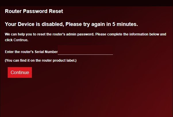

Something strange that happens is that when I try to configure it in the app, the router freezes for 5 minutes.

When I go into the logs, I can see that it's trying to connect but is giving an authentication error and the router is immediately blocked via the web.

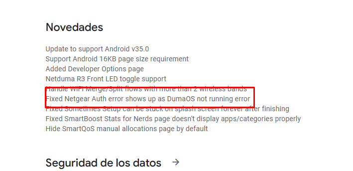

Potentially it's due to the DumaOS app being much further ahead in terms of the firmware it usually supports, do you get the same issue if you try logging in with the Nighthawk mobile app?

It would be a version not available on the XR1000 currently - once it's updated to 3.3 it should work better. Okay that's good you can use that app so it probably is what I mentioned then. I believe it's somewhere in the administration settings.

Buenos dias Fraser, sigo con el mismo problema, aun no he podido conectar la aplicacion de DumaOS con mi router XR1000, actualicé la aplicacion pensando que con esto se arreglaria pero ha sido imposible, la APP no encuentra mi router.
La ip esta por defecto.
Estoy conectado a la red de router.
Y esto solo me pasa con el XR1000, con el R2 lo dectecta instantaneamente.
Que puedo hacer?
