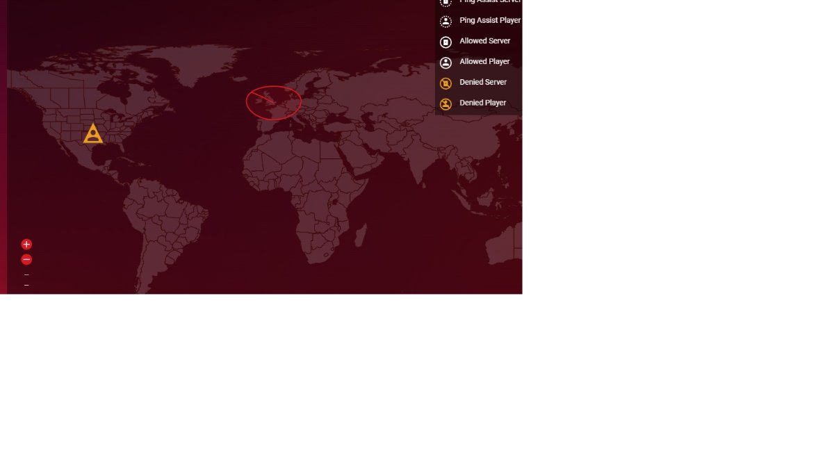

Kenny_123 Posted May 6, 2025 Posted May 6, 2025 Hi, I've set up a Geo filter on my PS5. When searching for a game on FC25 the filter shows me as connecting to a player from the United States. When I turn the filter off it still shows me as connecting to a player from the States, but they are not from the States. The ping is usually between 15-25 ms and i have message oppenents to confirm this. Im using the Xr500 on the latest firmware any help would be appreciated.
Administrators Netduma Fraser Posted May 6, 2025 Administrators Posted May 6, 2025 It'll be a mislocated server on the map, add it to your allow list for the moment so you can connect to it and if you could provide us with the ID we can correct its location
