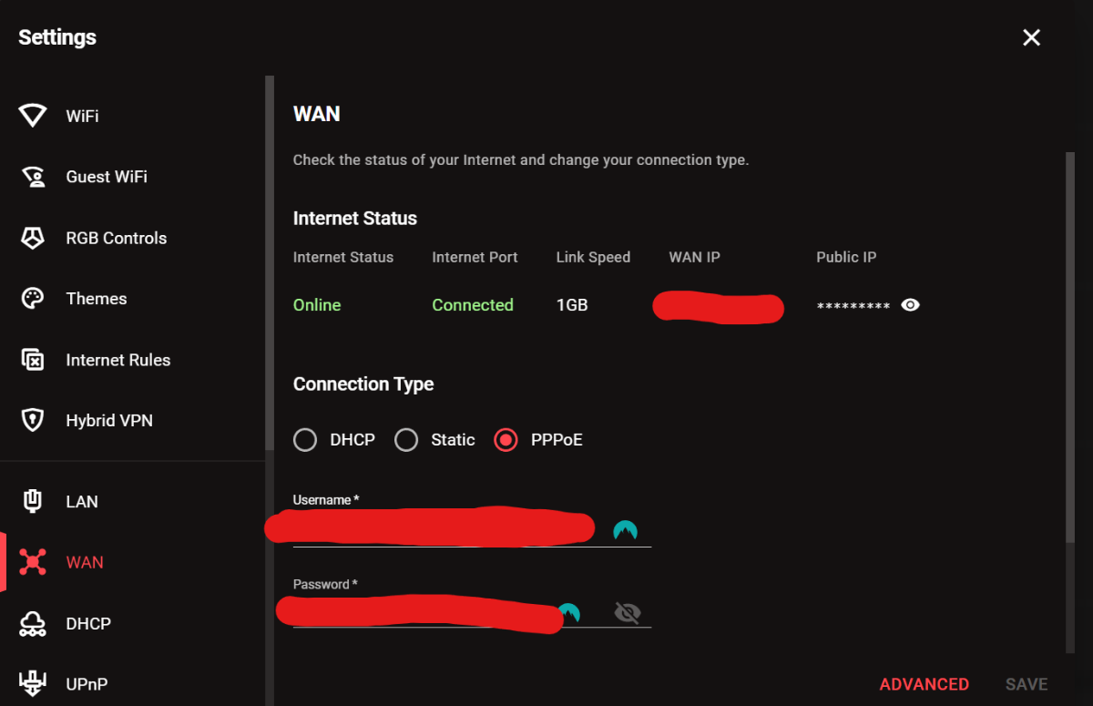

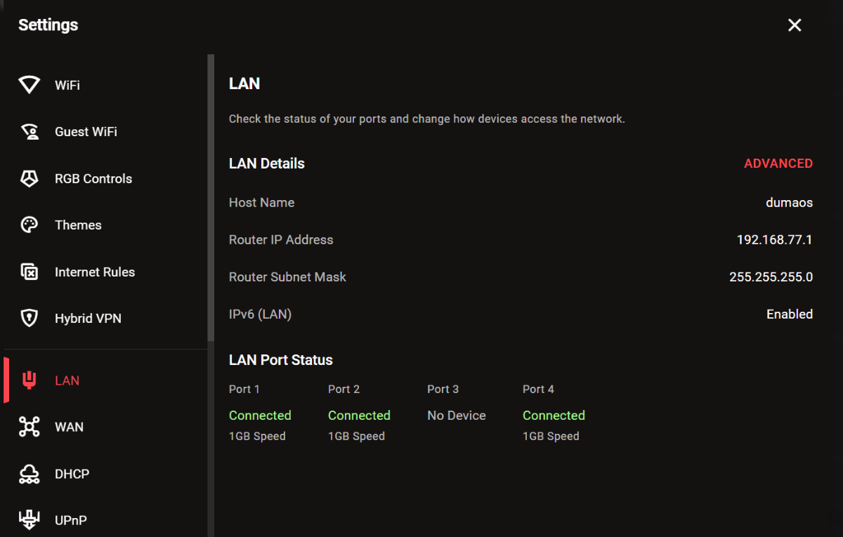

Administrators Netduma Fraser Posted May 6, 2025 Administrators Posted May 6, 2025 Can you provide a screenshot of the WAN & LAN pages please?
Ragnarok96 Posted May 7, 2025 Author Posted May 7, 2025 LAN and WAN attached as requested, just redacted login information and public IP
Administrators Netduma Fraser Posted May 8, 2025 Administrators Posted May 8, 2025 I believe it'll be due to you using PPPoE, we are aware the speeds through the router when using PPPoE can be reduced. If you have your ISP modem/router handle PPPoE instead do you then get better speeds through the R3?
