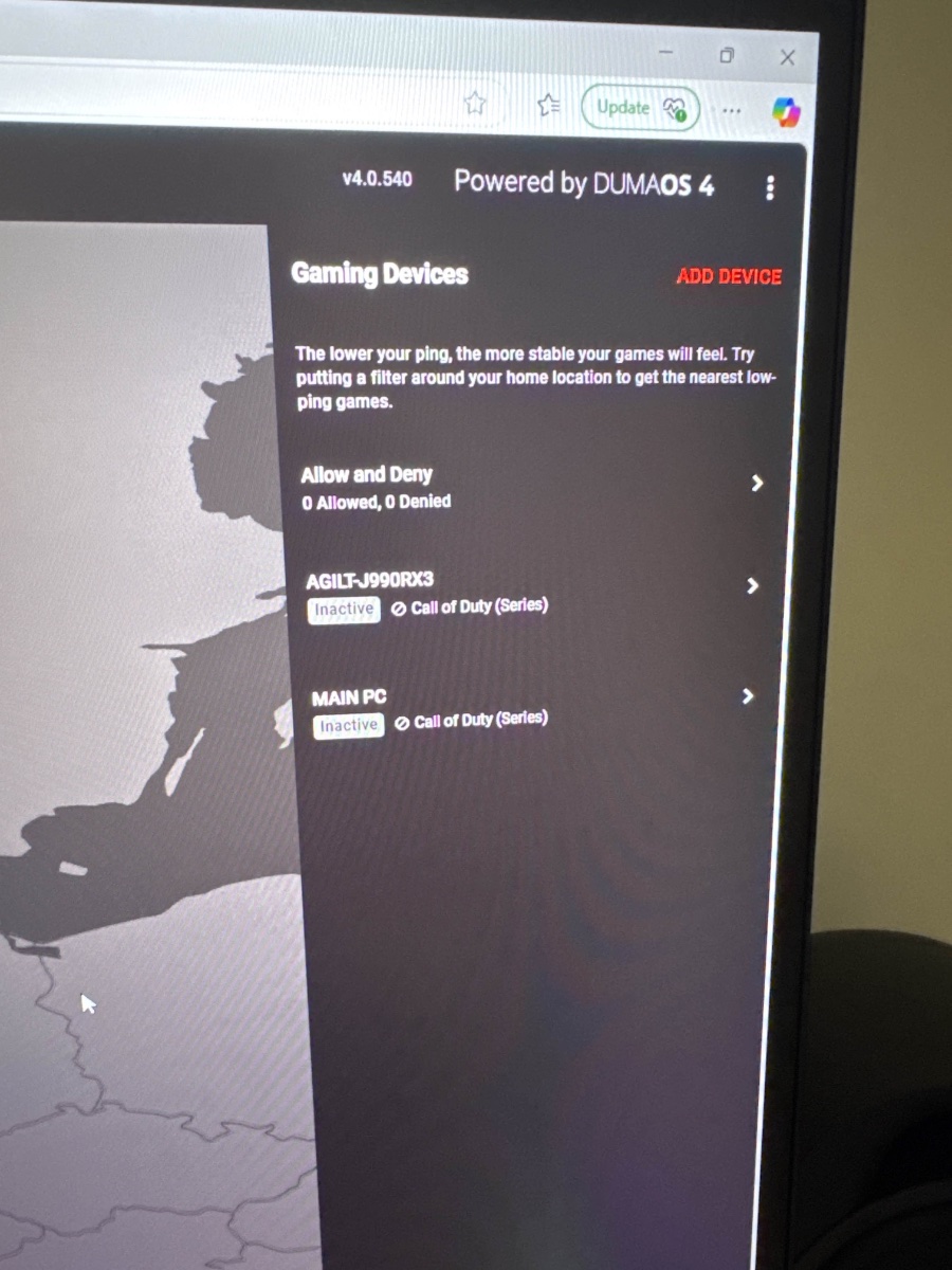

doddsbrah Posted May 2, 2025 Author Posted May 2, 2025 I’ve managed to get in now and set everything up. One thing I can’t get to change is where the gaming devices show as ‘inactive’ even when I’m playing call of duty bo6 is that right?
Administrators Netduma Fraser Posted May 2, 2025 Administrators Posted May 2, 2025 The services have become out of date as they change the game often, to counteract this and so you don't need to worry about it again: Quit the application/game/client completely Remove device from the Geo-Filter Give PC PlayStation Device Type in the Device Manager Resync from the Geo-Filter Map menu Re-add the device to the Geo-Filter Set up the Geo-Filter how you like Wait 2 minutes Boot up application/game/client

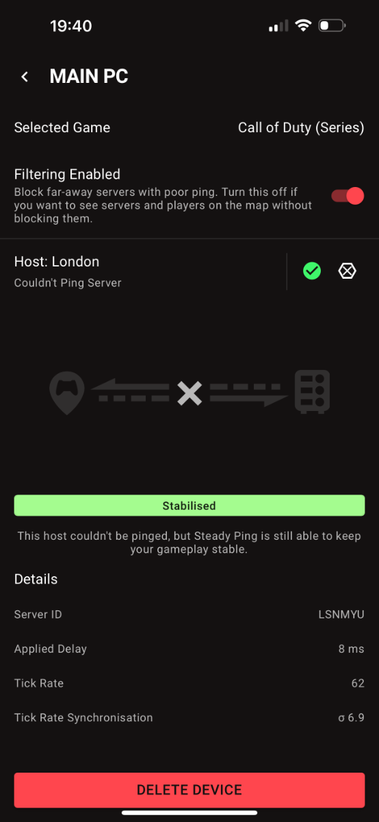

doddsbrah Posted May 2, 2025 Author Posted May 2, 2025 Great that seemed to work now when I play call of duty. The only thing it says is ‘couldn’t ping server’ is that ok as you can see it below?
Administrators Netduma Fraser Posted May 2, 2025 Administrators Posted May 2, 2025 1 hour ago, doddsbrah said: Great that seemed to work now when I play call of duty. The only thing it says is ‘couldn’t ping server’ is that ok as you can see it below? Looks like you have Call of Duty series still selected, it should say console but if it's working that's fine for now. Game servers, at the very least the CoD servers block pings so we're not always able to get a ping reading
