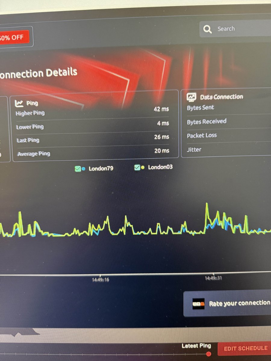

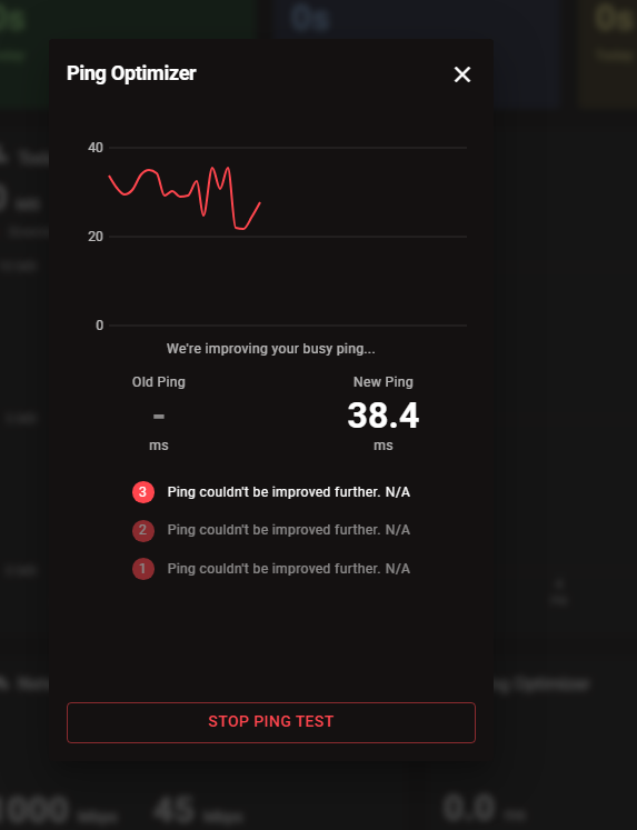

TheRealQM Posted May 2 Posted May 2 I have tried rebooting both my R3 and Modem digitally and physically. For a very long time now my ping has been raised more than normal even without the R3 and I have provided an attached image of what happens when I try to use the ping optimizer. I am starting to think the ping optimizer is a joke and scandal because it has rarely worked. When I first purchased the R3 it was flawless. This has been a continuous issue and has messed up work meetings. NetDuma support help me with this to resolve it or so help me God.

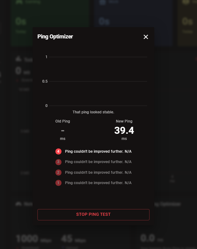

TheRealQM Posted May 2 Author Posted May 2 Oh and it only shows the download speed and not the upload speed when it does the test. I have provided an image which captures that.

Administrators Netduma Fraser Posted May 2 Administrators Posted May 2 We're aware Ping Optimizer/Speed test isn't 100% reliable at the moment and we're looking into it. In the meantime setting/testing speeds manually and adjusting Congestion Control manually will be needed to achieve the same effects. Your ping is raised where exactly? Where are you testing this ping? A higher ping wouldn't necessarily impact voip too much unless it's quite high. What is the model of the modem/router the R3 is connected to and how have you set that to ensure all traffic flows to the R3? E.g R3 in its DMZ, modem/bridge mode Are ALL devices connected to the R3? What are the speeds you pay for/receive? Have you entered those speeds into the router? How have you setup Congestion Control? How have you setup SmartBOOST?
18RayF Posted May 9 Posted May 9 Also having same issue ping can be low as 4ms and then spikes to around 40, running full fibre 1 gig up and down , speeds have been entered I use smart boost etc , when optimiser was working me ping used to very consistent in the 5ms.
