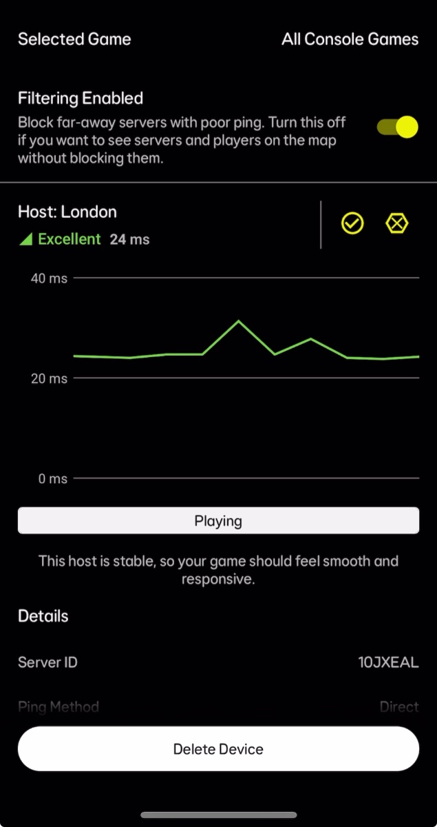

Dane Posted May 2 Posted May 2 Hi , I have an issue where my ping is 50-60ms on Fortnite to London servers from uk . to router it says 6ms but on the geo filter screen you can see what server you are connected to and it says 25-30 ms ping London , then Fortnite says 50-60ms . Take filtering off and bam normal ping but tossed around Europe so get high ping for them countries ( Paris , Frankfurt etc) hence why I would like less then 10ms ping which should be achieved. Any help would be appreciated.
Administrators Netduma Fraser Posted May 2 Administrators Posted May 2 Just to clarify, what is the 6ms ping to exactly? What is the 'normal' ping you're getting to the London server without the Geo-Filter enabled? Are you confirming you are actually getting the London server in that scenario with the Geo-Filter just with filtering disabled? Have you enabled Game Mode/activated boost? Have you done the ping optimizer feature? Dane 1
Dane Posted May 2 Author Posted May 2 Ping optimiser is the 6ms ping figure and Geo Filtering ON - Country - UK -London servers = that picture . Geo Filtering ON - SIMPLe- Radius whole of Europe - ping London 9-12ms Fance 12-17 Frankfurt 17-23ms so I know it can be done just does not like UK only …
Dane Posted May 2 Author Posted May 2 Yes I activated it and I even done a full factory reset and just connected my PS5 pro and still same , got a brand new cat 8( overkill I know) cable and still same .. EE test to router and reading shows it’s fine so won’t or can’t help .
Administrators Netduma Fraser Posted May 2 Administrators Posted May 2 The ping you see on Ping Optimiser is the ping you're receiving from the test server it's using, connecting to other servers, e.g. game servers won't necessarily mean you get a ping that low. Thanks for the screenshot of the server, so now this makes sense, that server is actually in Germany so it is mislocated on the map. We'll correct it. If you could: Copy/paste any server IDs you get when just covering the UK that get a higher ping like that Copy/paste any servers IDs you get when covering Europe that have a lower ping like you would expect being connected to a UK server Then we can correct them all to prevent it happening. In the meantime you can block any of the higher ping servers you see and allow any of the lower ping servers you see and it will start to improve. Dane 1

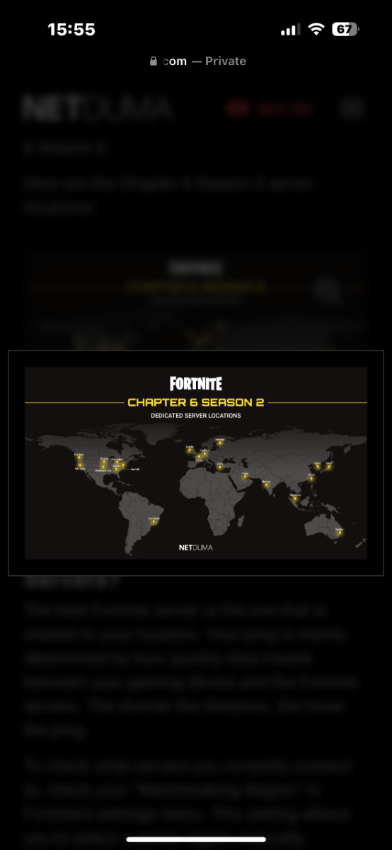

Dane Posted May 6 Author Posted May 6 Hi Sir hope you are well, i have some more servers I found with issues I will post them after this post . can I ask , on your website it says Fortnite servers are in Dublin Paris Frankfurt but not London. Is Fortnite not using London servers?

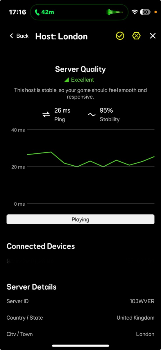

Dane Posted May 6 Author Posted May 6 10JWU46 - 25-35ms on app 50-60ms on Fortnite 85-95% Stability average 90% (all same from now ) . 10JWV70 , I am assuming it’s all servers beginning with 10.. so far ones working do not start with a 10 . hope this helps
Administrators Netduma Fraser Posted May 6 Administrators Posted May 6 As far as what we've seen it doesn't appear so but they could have been offline at the time we checked, best to check the Geo-Filter for more accuracy when playing. Thank you, we'll look into those
Dane Posted May 6 Author Posted May 6 (edited) Hi thank you for the reply , if Fortnite are not using London servers and on the geo filter it says I am on a London server , maybe all them servers are not London and elsewhere like we have discovered. ? Edited May 6 by Dane Forgot question mark
Administrators Netduma Fraser Posted May 6 Administrators Posted May 6 They could be London servers or they could be mislocated, provide an ID for one and I can check
