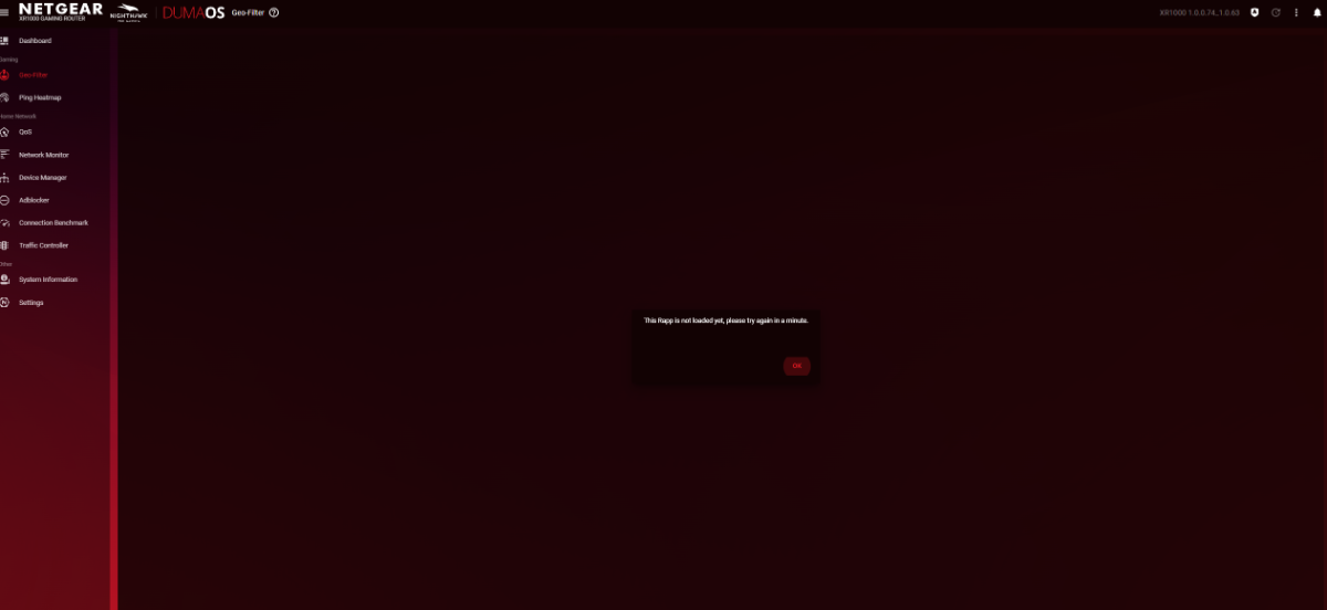

Croocodillul Posted April 28 Share Posted April 28 I receive each time I try to acces the GEO filter or ping heatmap the erorrs: [url=https://ibb.co/RTJgWyCc][img]https://i.ibb.co/k2PGF1hX/Screenshot-2025-04-28-194940.png[/img][/url] I'm an infinite loop of errors: uncaught error, rapp not loaded yet. etc. I did tried all the solutions that were on forrums before writing here. It is doing this with every firmware. I'm on chrome, but is doing the same thing on my macbook with safari. Link to comment Share on other sites More sharing options...
Administrators Netduma Fraser Posted April 28 Administrators Share Posted April 28 On the System Information page go to the Rapp panel, click the 3 lines option menu and change the retries to 5, reboot the router from the interface, wait 4 minutes then access and see if it loads please. Also: Disable Armor Ensure the browser isn't forcing HTTPS for the interface Link to comment Share on other sites More sharing options...

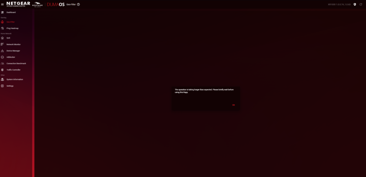

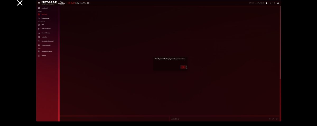

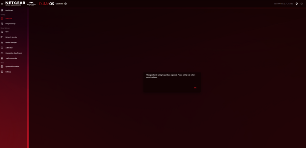

r99evo Posted May 18 Share Posted May 18 Tried everything you mentioned. Updated to 5 tries, disabled any ad bockers, rebooted. Same result. Screenshots attached. Link to comment Share on other sites More sharing options...
Administrators Netduma Fraser Posted May 18 Administrators Share Posted May 18 28 minutes ago, r99evo said: Tried everything you mentioned. Updated to 5 tries, disabled any ad bockers, rebooted. Same result. Screenshots attached. Did this only happening after upgrading? If so downgrade to the previous version and see if it loads correctly then Link to comment Share on other sites More sharing options...
