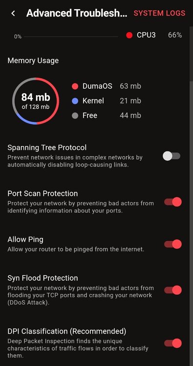

NetTech Posted May 4, 2025 Posted May 4, 2025 On 4/18/2025 at 7:28 AM, Netduma Fraser said: If this is a DPI issue which it sounds like it could be if disabling prevents the issue for you then this has been fixed with the DumaOS 4 Early Access firmware so if you update to that the issue should stop Quick update. The issue has not returned since "The solution at the moment is to disable QoS and DPI." Additionally, I left the dpi and qos disabled with version 3.3.280 and upgraded to the version 4 beta. Since then the issue has not returned. In the past I had tried version 4 but it had its own dns issues. Not sure how those issues are no longer present since the beta version has not changed? Maybe some of the dpi disable settings linger after the update? Fairypusher 1
rhart1982 Posted May 4, 2025 Posted May 4, 2025 7 minutes ago, NetTech said: Quick update. The issue has not returned since "The solution at the moment is to disable QoS and DPI." Additionally, I left the dpi and qos disabled with version 3.3.280 and upgraded to the version 4 beta. Since then the issue has not returned. In the past I had tried version 4 but it had its own dns issues. Not sure how those issues are no longer present since the beta version has not changed? Maybe some of the dpi disable settings linger after the update? So far with QOS disabled as you mentioned, it seems to work as it should. However, this should not be the longterm work around.
Administrators Netduma Fraser Posted May 4, 2025 Administrators Posted May 4, 2025 59 minutes ago, rhart1982 said: when, I factory reset friday and it's still doing it. It does depend when you did a factory reset (early morning BST would be too early). Thanks for letting us know, I'll pass it onto the team. I've given you Early Access in the meantime to try the above https://forum.netduma.com/forum/144-netduma-r2-early-access/ 26 minutes ago, NetTech said: Quick update. The issue has not returned since "The solution at the moment is to disable QoS and DPI." Additionally, I left the dpi and qos disabled with version 3.3.280 and upgraded to the version 4 beta. Since then the issue has not returned. In the past I had tried version 4 but it had its own dns issues. Not sure how those issues are no longer present since the beta version has not changed? Maybe some of the dpi disable settings linger after the update? Just to double check, are you now using SmartBOOST/Congestion Control with DPI enabled in Settings > Troubleshooting and you're not encountering the issue now?
NetTech Posted May 6, 2025 Posted May 6, 2025 On 5/4/2025 at 12:00 PM, Netduma Fraser said: It does depend when you did a factory reset (early morning BST would be too early). Thanks for letting us know, I'll pass it onto the team. I've given you Early Access in the meantime to try the above https://forum.netduma.com/forum/144-netduma-r2-early-access/ Just to double check, are you now using SmartBOOST/Congestion Control with DPI enabled in Settings > Troubleshooting and you're not encountering the issue now? Does this show the information that you are requesting?
Administrators Netduma Fraser Posted May 6, 2025 Administrators Posted May 6, 2025 7 hours ago, NetTech said: Does this show the information that you are requesting? Yes it does, thanks for the update!
