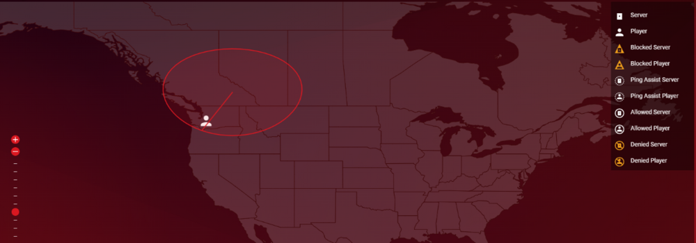

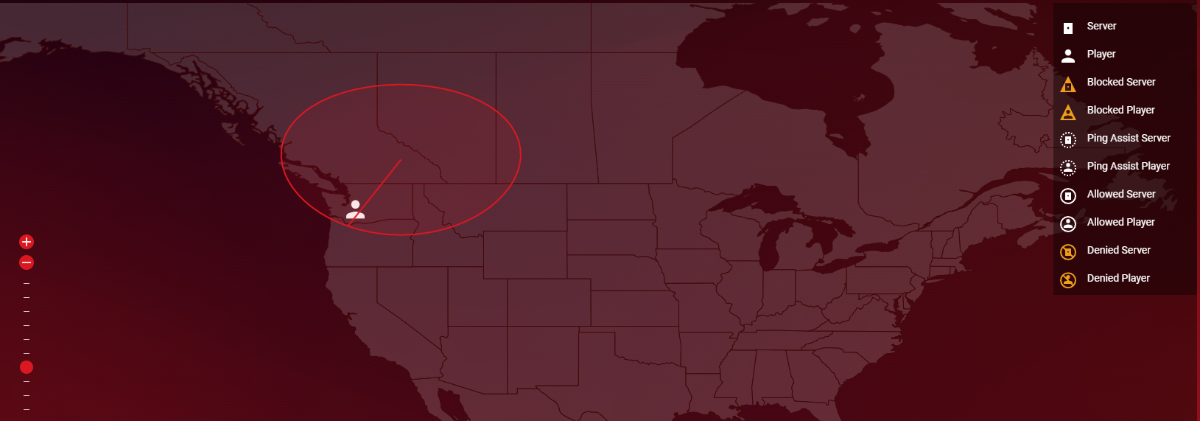

zeeymg Posted April 8, 2025 Posted April 8, 2025 I am turning on Geo-filter but I am still being connected to games outside of my specified zone. Additionaly, when it puts me into a game it does not show any of the servers or other icons on the map.

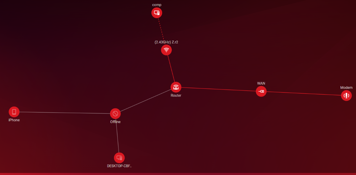

Administrators Netduma Fraser Posted April 8, 2025 Administrators Posted April 8, 2025 How have you added your device to the Geo-Filter exactly? What is the model of the modem/router the R2 is connected to and how have you set that to ensure all traffic flows to the R2? E.g R2 in its DMZ, modem/bridge mode What platform are you playing on and how is it connected, via ethernet or WiFi?

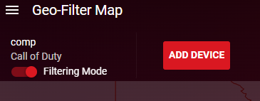

zeeymg Posted April 8, 2025 Author Posted April 8, 2025 @Netduma Fraser i went to device manager --> selected my computer --> named it --> in geo-filter I added that device. My modem is a B20T and I have tried connecting it via wifi and ethernet. I'm on my PC. I reset the device selected in geo-filter and now I am just stuck searching for a game

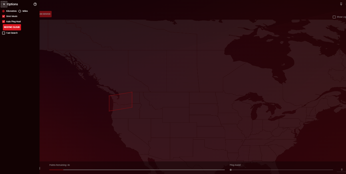

Administrators Netduma Fraser Posted April 10, 2025 Administrators Posted April 10, 2025 Do this: Quit the application/game/client completely Remove device from the Geo-Filter Give PC PlayStation Device Type in the Device Manager Resync from the Geo-Filter Map menu Re-add the device to the Geo-Filter Set up the Geo-Filter how you like Wait 2 minutes Boot up application/game/client It should work better then
zeeymg Posted April 10, 2025 Author Posted April 10, 2025 @Netduma Fraser Still does not work. Just stuck searching for a game
Administrators Netduma Fraser Posted April 10, 2025 Administrators Posted April 10, 2025 Are you seeing any servers blocked outside your radius when this happens?
