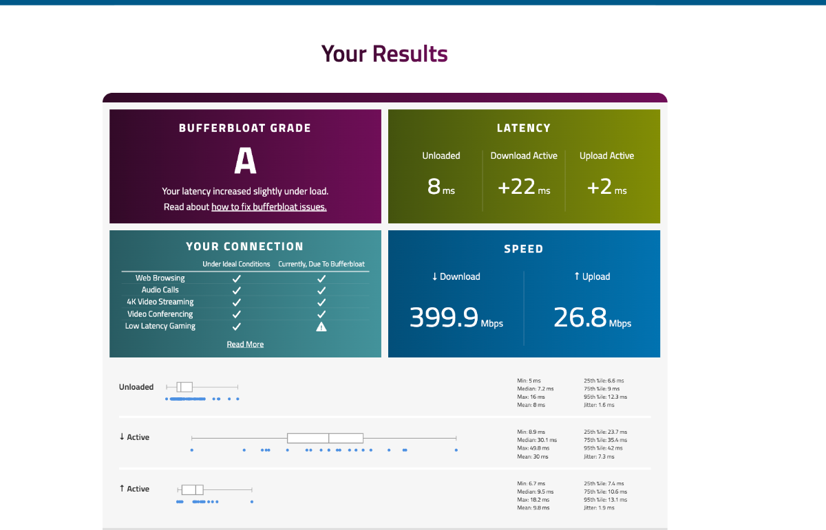

pdoidy30 Posted March 28 Posted March 28 I just swapped my XR1000 for the R3 Router and the speed has dropped from the Almost 750-800mbps on Wifi to 350mbps. Attached is the latest screenshot from bufferbloat. The router went through an upgrade to the latest firmware when i was first setting it up. Additionally, connection is based in PPoE and internet plan is a1GB Fibre plan. Any suggestions on getting this fixed ?
Administrators Netduma Fraser Posted March 28 Administrators Posted March 28 It's likely due to PPPoE, what speeds are you getting over ethernet? Also try these suggestions: Disable Mirror Mode, give 2.4/5GHz different names and apply - you'll want to connect to 5GHz specifically for speeds Use a WiFi analyzer to find the least congested channel and change to that Experiment with the widths to see what gives better results Ensure it's in an elevated position - not on a metal surface Ensure there aren't any electrical / wireless devices e.g headphones etc within close proximity ~3 feet if possible Set the antennae to this position _ | | _ Behringer-93 1
pdoidy30 Posted March 29 Author Posted March 29 Thanks. I have the 2.4/5GHz split with different names and everything. Ethernet test on the router is around 450/460mbps but on the XR1000 is was 950/980mbps.
Administrators Netduma Fraser Posted March 29 Administrators Posted March 29 It's definitely due to PPPoE, if you can have another router/your ISP router handle PPPoE instead your speeds will increase. If possible we will improve the speeds with PPPoE. Behringer-93 1
