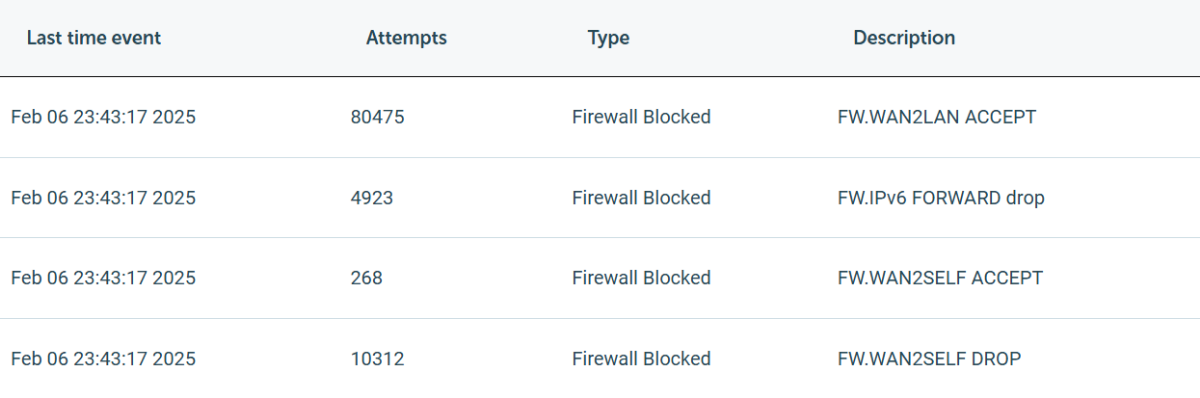

I've already checked, and no events are shown during the disconnection. However, I found log entries from my ISP's main router that coincide with the disconnection, but similar entries also appear when everything is working fine. here they are

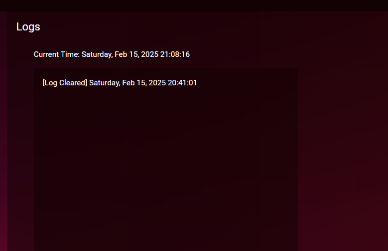

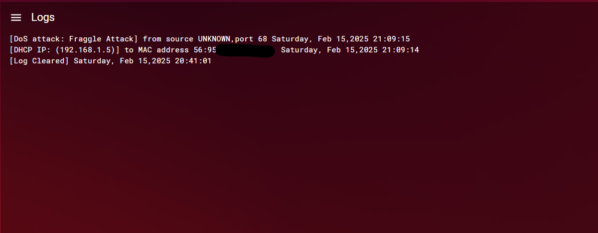

One disconnection occurred from 21:06 to 21:08. Here are the logs after I cleared them at 20:41:01. Should I try to roll back to a previous update? Before I updated to the latest version, I was on V1.1.0.16, and I also had those disconnections, so maybe I should try one version before that.

That's the only thing the log indicates, just to double check, if you try to connect a new device to the router/one you haven't reserved an IP for does it connect and use the internet normally?
