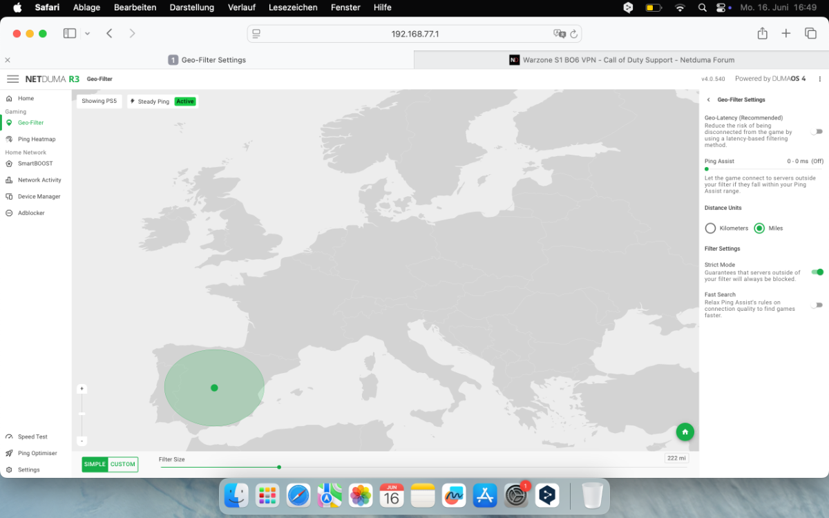

Administrators Netduma Fraser Posted June 12 Administrators Share Posted June 12 Please provide a screenshot of the VPN page & a zoomed out screenshot of the Geo-Filter page showing when you get a game in the EU setup like that. Switching the PS5 to a PC would make it worse, should only be done the other way around. Do this: Quit the application/game/client completely Remove device from the Geo-Filter Resync from the Geo-Filter Map menu Re-add the device to the Geo-Filter Set up the Geo-Filter how you like Wait 2 minutes Boot up application/game/client Make sure Ping Assist and Geo-Latency are disabled. Link to comment Share on other sites More sharing options...
VeniVidiVici Posted June 12 Author Share Posted June 12 I have the new beta version for the netdumaR2. What is Make sure Ping Assist and Geo-Latency are disabled. Ping assist is always off, which option should be geo-lantency ? Can you send me a picture of which function this is? I will send the picture of the provider of VPN and geofilter later. Link to comment Share on other sites More sharing options...
Administrators Netduma Fraser Posted June 12 Administrators Share Posted June 12 Click the icon top right on the Geo-Filter page and go to settings, you can see it there to disable it Link to comment Share on other sites More sharing options...

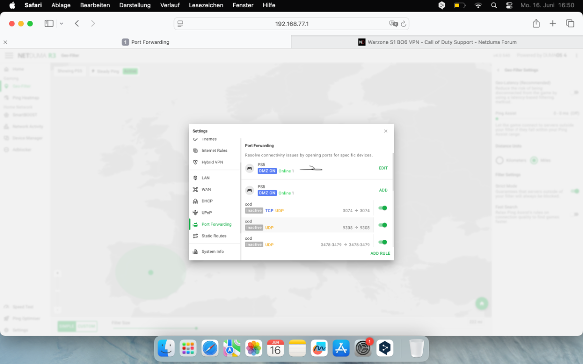

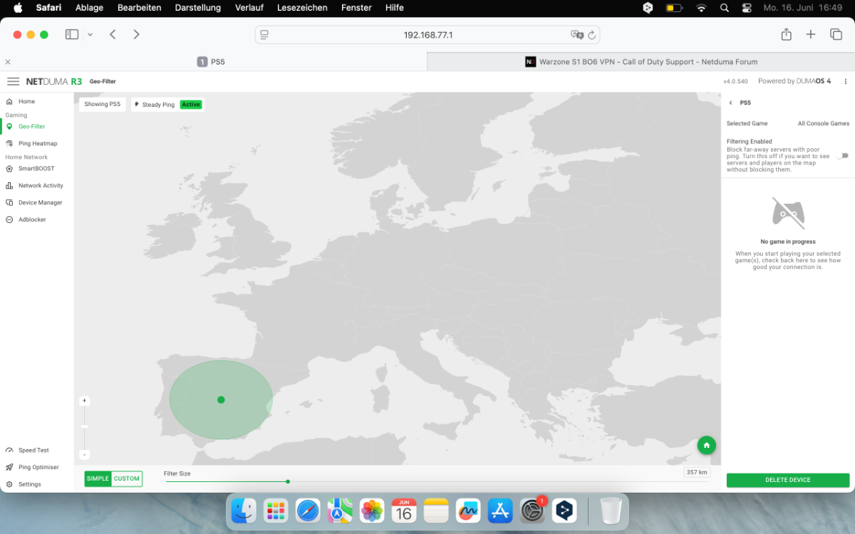

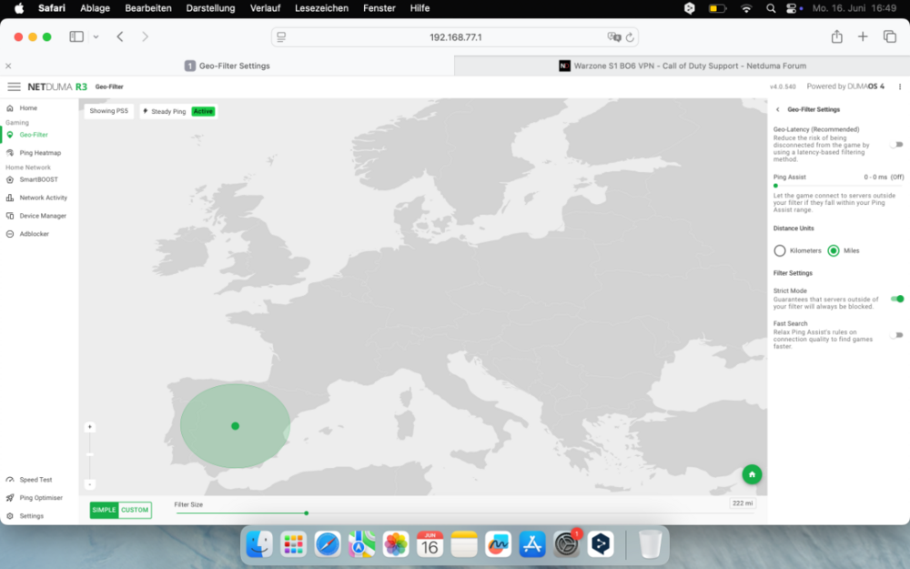

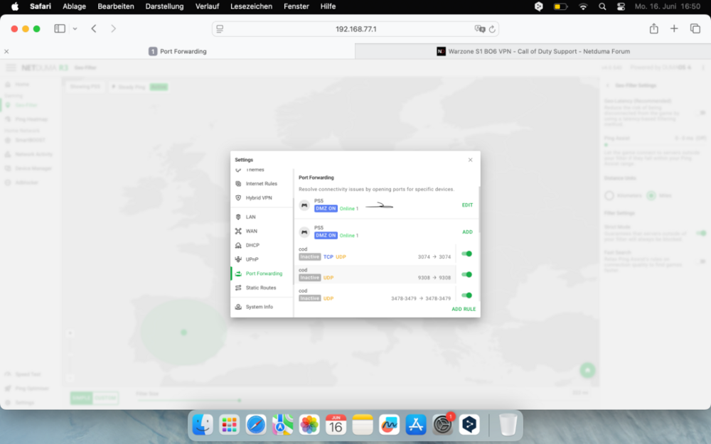

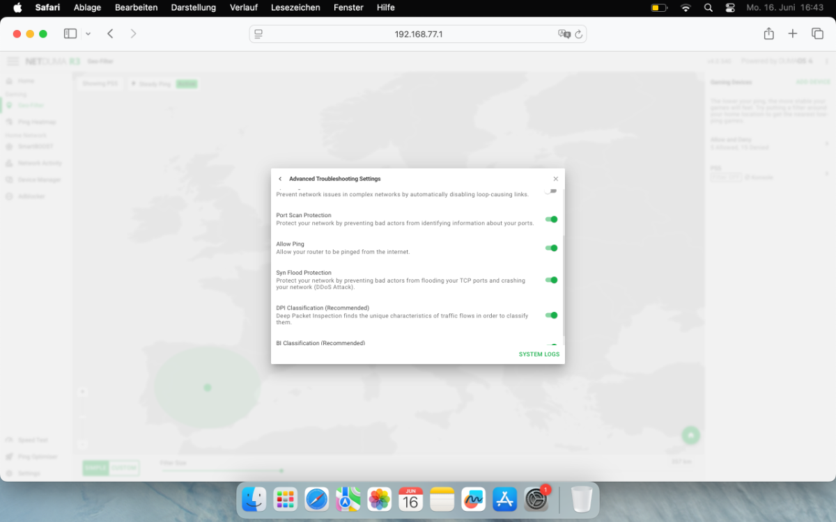

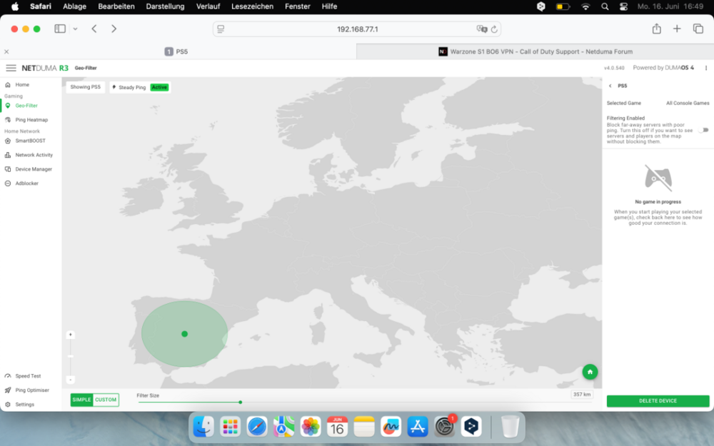

VeniVidiVici Posted June 16 Author Share Posted June 16 i got a netduma r3 today. i set it up the same way as netduma r2. my question would be did i set ports for cod manually and put my ps5 in dmz mode. i turned off geo lantency in geofilter and set ping assist to 0. have circled spain with the simple method and strict mode activated. have only the filter mode off. does it make sense to have these options activated for online shooters, see picture below. can i turn off allow ping and the others too? to what extent does it make sense to activate steady ping? i play with vpn provider ProtonVPN. Translated with DeepL.com (free version) Link to comment Share on other sites More sharing options...
Administrators Netduma Fraser Posted June 16 Administrators Share Posted June 16 19 minutes ago, VeniVidiVici said: i got a netduma r3 today. i set it up the same way as netduma r2. my question would be did i set ports for cod manually and put my ps5 in dmz mode. i turned off geo lantency in geofilter and set ping assist to 0. have circled spain with the simple method and strict mode activated. have only the filter mode off. does it make sense to have these options activated for online shooters, see picture below. can i turn off allow ping and the others too? to what extent does it make sense to activate steady ping? i play with vpn provider ProtonVPN. Use the DMZ or Port Forwarding, not both Having Filter Mode Off means you will not be Geo-Filtering, it will not impact what servers you get connected to You can disable Allow Ping if you like but you don't need to disable any of those options to improve your game experience Steady Ping stabilizes the ping so it doesn't fluctuate and you have a smoother experience, it adds ping so some people like using it, others don't, best to find what your experience is like with it enabled/disabled and decide from there I wouldn't suggest using a VPN when playing, your ping will be higher Link to comment Share on other sites More sharing options...
