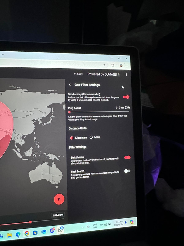

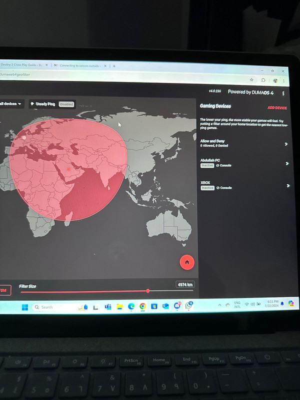

Administrators Netduma Fraser Posted July 22, 2024 Administrators Share Posted July 22, 2024 As far as they can tell it is working, they were able to force a server in a different country just using Geo-Latency. Can you provide a screenshot of your Geo-Filter page please? Link to comment Share on other sites More sharing options...
thahyp Posted July 22, 2024 Author Share Posted July 22, 2024 12 minutes ago, Netduma Fraser said: As far as they can tell it is working, they were able to force a server in a different country just using Geo-Latency. Can you provide a screenshot of your Geo-Filter page please? Link to comment Share on other sites More sharing options...
Administrators Netduma Fraser Posted July 22, 2024 Administrators Share Posted July 22, 2024 Make the radius smaller and move the location so you're covering yourself and Europe and try again Link to comment Share on other sites More sharing options...
thahyp Posted July 22, 2024 Author Share Posted July 22, 2024 6 minutes ago, Netduma Fraser said: Make the radius smaller and move the location so you're covering yourself and Europe and try again This is as small as possible to include all the EU servers, which is the best for me and what I'm trying to play on. Link to comment Share on other sites More sharing options...
Administrators Netduma Fraser Posted July 22, 2024 Administrators Share Posted July 22, 2024 You could do this instead: Link to comment Share on other sites More sharing options...
thahyp Posted July 22, 2024 Author Share Posted July 22, 2024 2 hours ago, Netduma Fraser said: You could do this instead: What does that picture entail exactly? Elaborate please because I didn't understand what needs to be done there. Link to comment Share on other sites More sharing options...
Administrators Netduma Fraser Posted July 22, 2024 Administrators Share Posted July 22, 2024 I've moved the location further north and reduced the radius by ~1000km but it still covers all the areas you wanted Link to comment Share on other sites More sharing options...
thahyp Posted July 24, 2024 Author Share Posted July 24, 2024 What does that change? The geofilter does in fact work on another game so it's not about the radius... Link to comment Share on other sites More sharing options...
