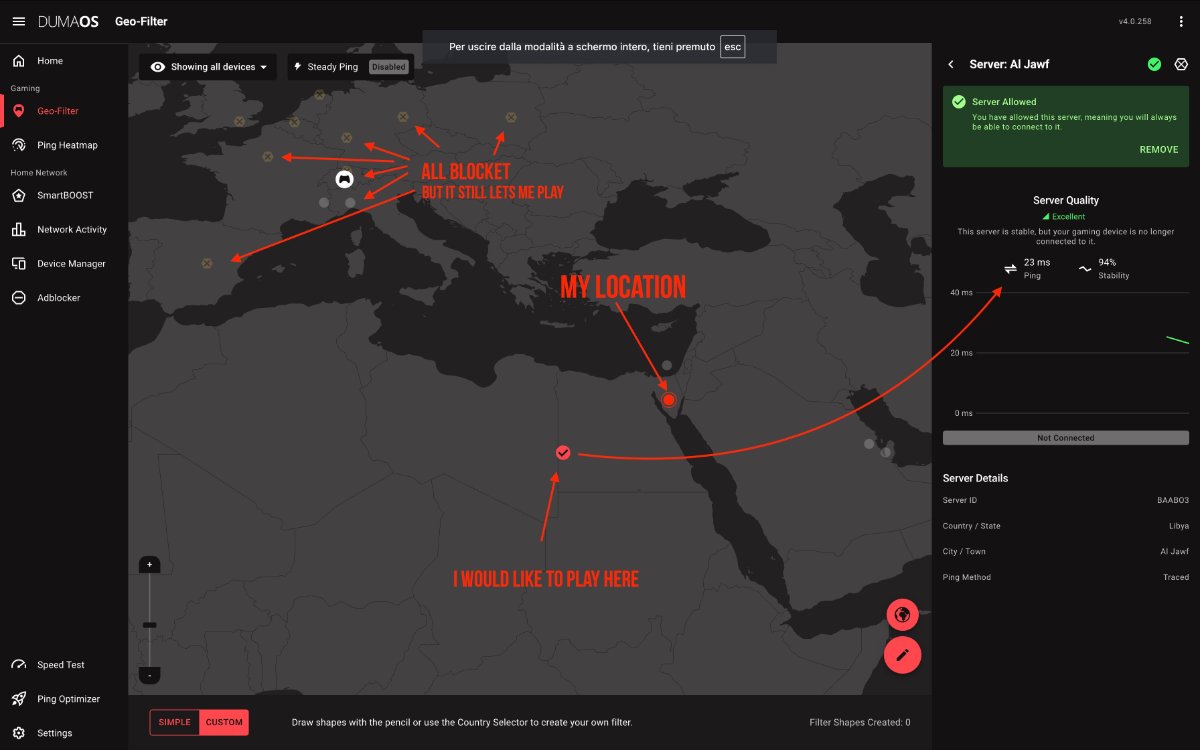

Scaramanga Posted April 30, 2025 Posted April 30, 2025 @Netduma Fraser This is the situation now, I am using NETDUMA R2 with software 4.0.258 and as you can see it is not possible to block servers far from my location. I blocked all the European servers but still the game goes to look for the match in Europe. I have two very good locations near my position but I can never play them. It's still the game's fault (eFootball) or what? Thanks for your help.
Administrators Netduma Fraser Posted May 1, 2025 Administrators Posted May 1, 2025 22 hours ago, Scaramanga said: @Netduma Fraser This is the situation now, I am using NETDUMA R2 with software 4.0.258 and as you can see it is not possible to block servers far from my location. I blocked all the European servers but still the game goes to look for the match in Europe. I have two very good locations near my position but I can never play them. It's still the game's fault (eFootball) or what? Thanks for your help. Based on how you have your Geo-Filter set, you're on the custom mode but haven't drawn any areas to have allowed servers so you're essentially not filtering currently, filter and then it should work.

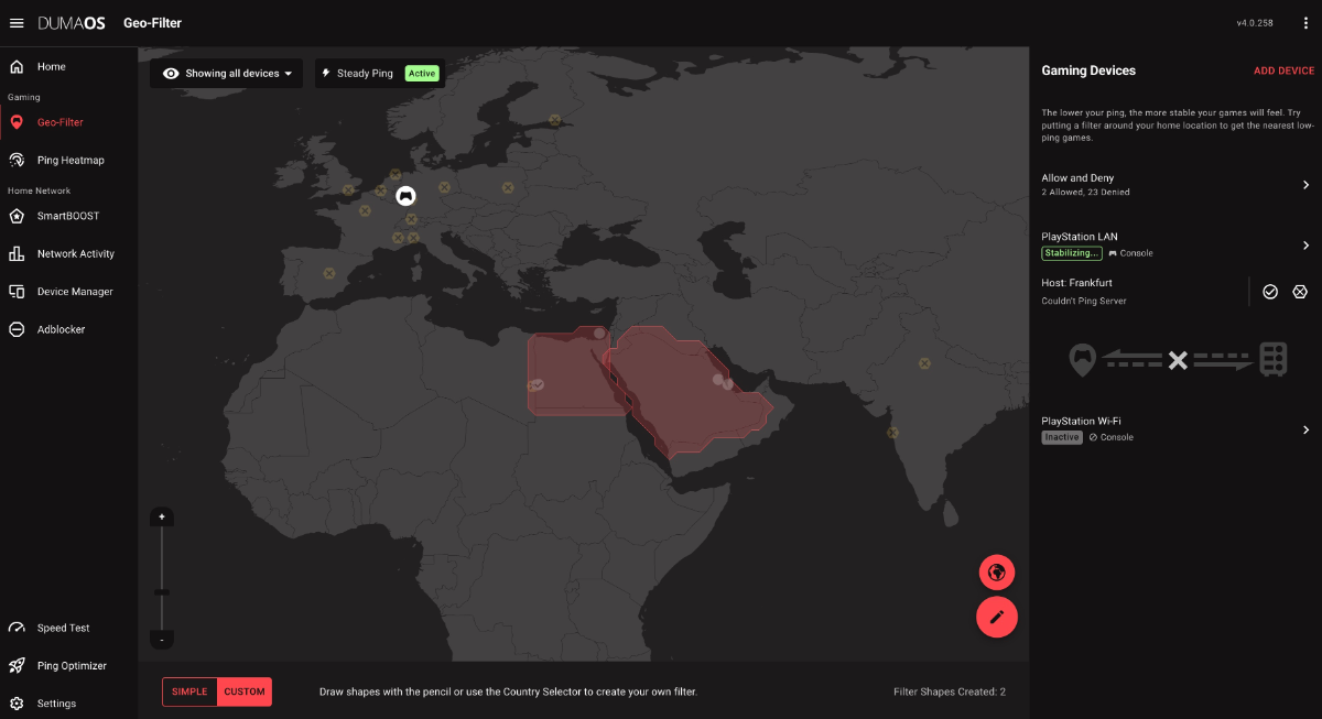

Scaramanga Posted May 1, 2025 Posted May 1, 2025 1 hour ago, Netduma Fraser said: Based on how you have your Geo-Filter set, you're on the custom mode but haven't drawn any areas to have allowed servers so you're essentially not filtering currently, filter and then it should work. @Netduma Fraser Obviously I tried drawing my area but it still doesn't work, however I'll send you another screen shot as proof that it doesn't work, thanks. Netduma Fraser 1
Scaramanga Posted May 1, 2025 Posted May 1, 2025 6 hours ago, Netduma Fraser said: Based on how you have your Geo-Filter set, you're on the custom mode but haven't drawn any areas to have allowed servers so you're essentially not filtering currently, filter and then it should work. @Netduma Fraser Unfortunately as I told you Netduma does not block servers outside the filter.
Administrators Netduma Fraser Posted May 1, 2025 Administrators Posted May 1, 2025 2 minutes ago, Scaramanga said: @Netduma Fraser Unfortunately as I told you Netduma does not block servers outside the filter. Is Geo-Latency or Ping Assist enabled?
Scaramanga Posted May 1, 2025 Posted May 1, 2025 1 minute ago, Netduma Fraser said: Is Geo-Latency or Ping Assist enabled? yes I tried with both, nothing changes
Administrators Netduma Fraser Posted May 1, 2025 Administrators Posted May 1, 2025 51 minutes ago, Scaramanga said: yes I tried with both, nothing changes Are you enabling the Geo-Filter before you boot up the console/game? Are you making changes to the Geo-Filter while you're on the game? This could be them using the relay servers, in which case some mentioned covering Japan made it adhere better to their Geo-Filter settings
Scaramanga Posted May 2, 2025 Posted May 2, 2025 14 hours ago, Netduma Fraser said: Are you enabling the Geo-Filter before you boot up the console/game? Are you making changes to the Geo-Filter while you're on the game? Always before boot console/game
Administrators Netduma Fraser Posted May 2, 2025 Administrators Posted May 2, 2025 1 hour ago, Scaramanga said: Always before boot console/game Cover Japan then and see if it prevents that happening please
Scaramanga Posted May 2, 2025 Posted May 2, 2025 1 hour ago, Netduma Fraser said: Cover Japan then and see if it prevents that happening please Ok, I'll try, 👍🏼 Netduma Fraser 1
