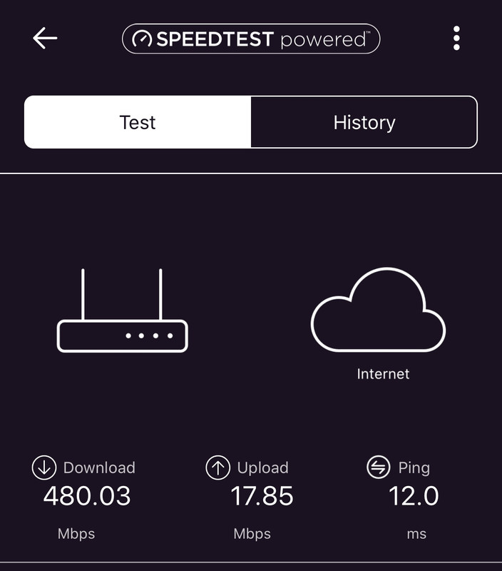

Administrators Netduma Fraser Posted April 21, 2020 Administrators Posted April 21, 2020 What is your base ping? - Do a speedtest.net test when there is nothing using the internet, what ping do you get? That will tell you whether its possible to get that low a ping. Usually you can add ~10-20 ping on top to determine what kind of game ping is possible (exception is when you live extremely close to the server). Are you using QoS at all?
Ernie Posted April 22, 2020 Author Posted April 22, 2020 5 hours ago, Netduma Fraser said: What is your base ping? - Do a speedtest.net test when there is nothing using the internet, what ping do you get? That will tell you whether its possible to get that low a ping. Usually you can add ~10-20 ping on top to determine what kind of game ping is possible (exception is when you live extremely close to the server). Are you using QoS at all?
Ernie Posted April 22, 2020 Author Posted April 22, 2020 Usually this is the lowest but mostly around 500-530down. I used QoS a bit. Did some common things most do. Made the PS4 get more on the chart and made it priority. Other than that not much more.
