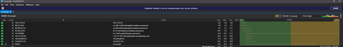

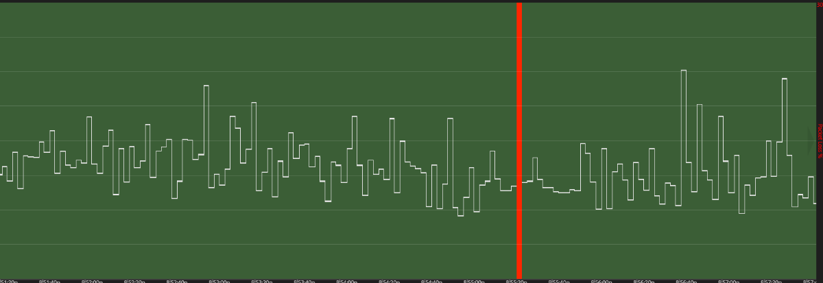

@Netduma FraserYes same behavior. @DARKNESS Current firmware is the beta version v4.0.645. @Krush Tried X, google.com, pingplotter.com, cloudflare.com. I wasn't getting this last week. Also noticed when playing BO6, it starts at trying to find a game STARTING at 200 ms ping while hooked up to the R3. Directly into the modem, pings and searches normally. (Starts around 23 ms ping) Very weird..
For some odd reason, I'm experiencing packet loss when connected to the R3 (hard wired) but not when I'm connected directly to my modem. (CM3000) Any suggestions on what I should do? (First two pics are connected to the R3, the third is connected to the modem)
