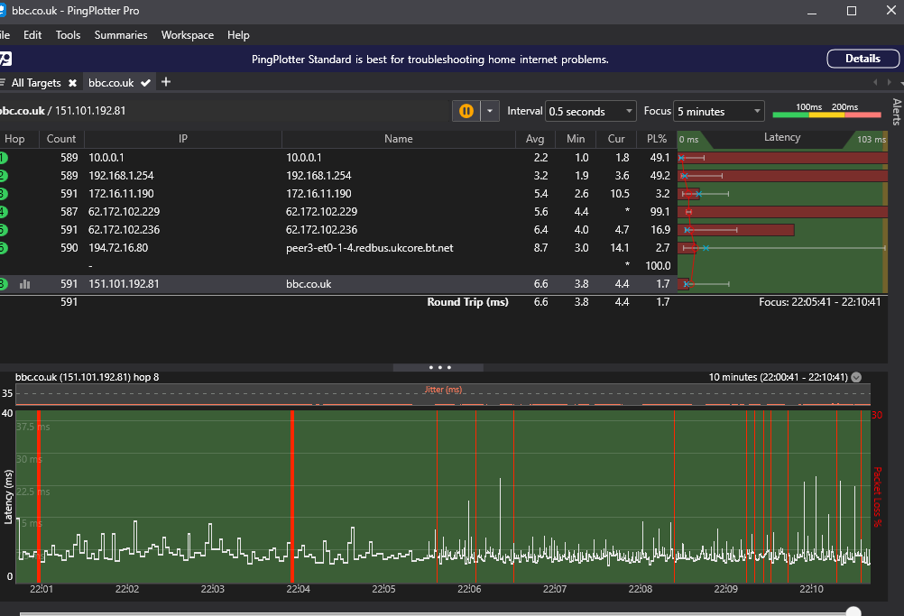

Ive connected my laptop directly into the XR1000 for testing i get 0 packet loss when playing games, it must be a wifi issue? i still can't connect to the network via wifi i did switch the mide to 2400, Update: managed to connect to the xr1000s wifi i had to be right next to it to connect to it, i can confirm it is the wifi that is causing the packet loss issue, tested on the game, tested on speed test running a ping plotter test now.

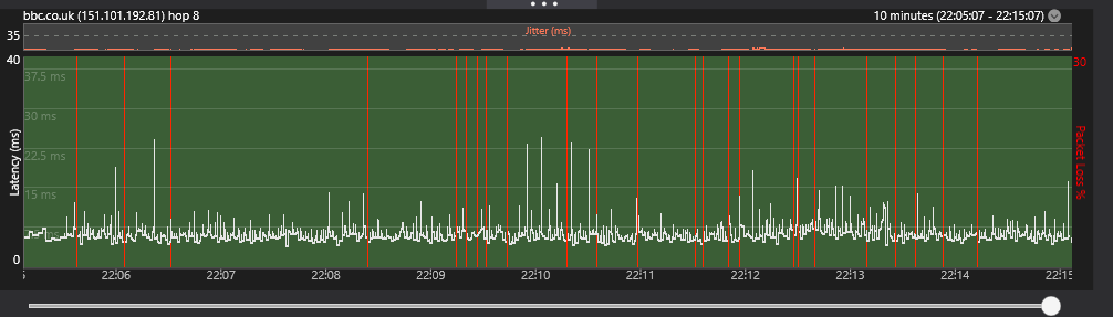

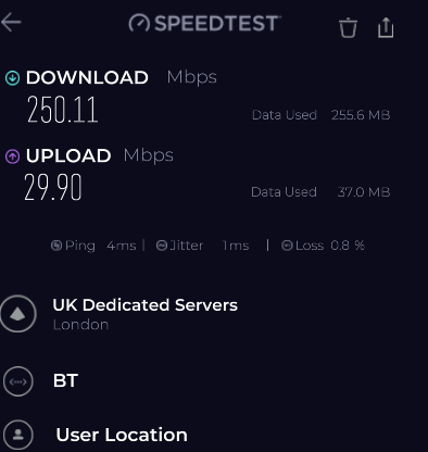

Packet loss persists, adjusted CC again, 98% up and 34% down. there is packet loss basically every single hop shown in top right ish . Even in speed test it says i get packet loss, can vary from 0.2 to 5 %

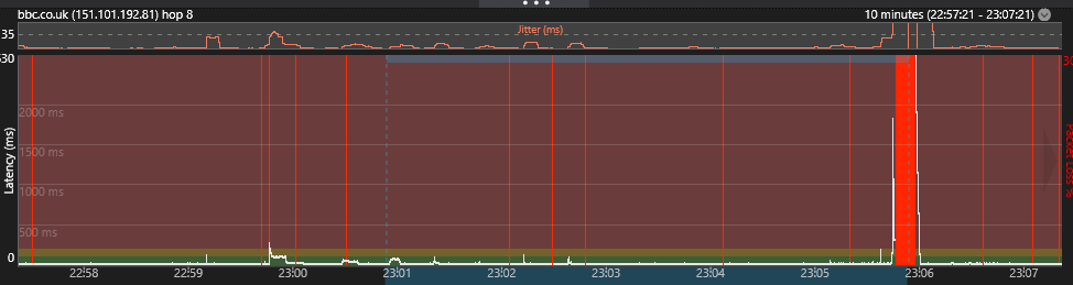

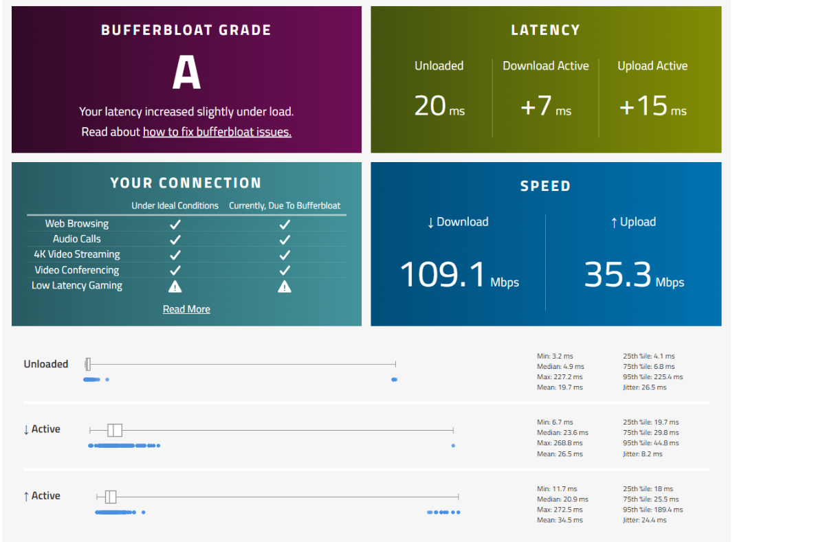

Test conducted for 10 Min, with congestion control turned on , using automatic settings, with insane Ping spikes and packet loss , also shown on buffer bloat test

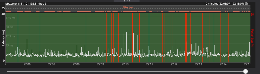

It spikes up to 15-20% packet loss sometimes, i dont play casually, i play competitively so this is a big deal for me, this is just a website i found online by Looking up "fortnite packet loss test" but my main source os measurement is in game stats whjere every second i am getting packet loss it is NEVER on 0 i usually get 4% -5% rarely under 3 and sometimes over 10. Nothing is happening on the network, I am the only one connected to it. Media bridge mode is when traffic is directly forwarded to the xr, the extender doesn't create a separate network. Yes my setup is ee router, xr1000, asus extender via bridge mode, then pc by Ethernet. The extender is connected to xr via wifi 6. I have put the xr1000 in dmz mode on the EE. Most of my devices are connected to EE router so xr is not congested. i pay for 300 up and 45 down, i have set those speeds on my router, i have set up congestion control that is working fine. i dont touch bandwith allocation as i had some problems with that in the past
Insane packet loss when playing any game. I mostly play Fortnite. This started last month. I tried resetting the route, but nothing worked. I tried different cables. I do have an Asus extender connected to the xr1000 via bridge mode my pc is fed into the port on the extender. Note this has never happened before and just occurred on its own. I have also tried flashing update and rollin g back to a different update. i also get a higher ping on average compared to connecting to my EE router's Wi-Fi.
