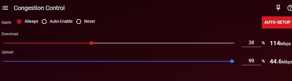

  8. Packet loss persists, adjusted CC again, 98% up and 34% down. there is packet loss basically every single hop shown in top right ish . Even in speed test it says i get packet loss, can vary from 0.2 to 5 %

  11. yes i mean auto set up. I have tested a range of settings for congestion control from 95% down to 30% for both upload and download. The auto settings are by far the best settings for me, yes, I have all devices connected to XR. With other settings, I got 20ms plus for both down and up. I have smart wifi off, never used it, I will try what you have recommended

  14. Test conducted for 10 Min, with congestion control turned on , using automatic settings, with insane Ping spikes and packet loss , also shown on buffer bloat test

  16. i have connected most of my devices to the EE router. The congestion control is on, I have tried using traffic prioritisation, which did not change anything, i am still getting huge spikes in game.
  17. i doubt not using congestion control or traffic prioritisation would be causing the issue because everything was the way it was before the packet loss issue started.

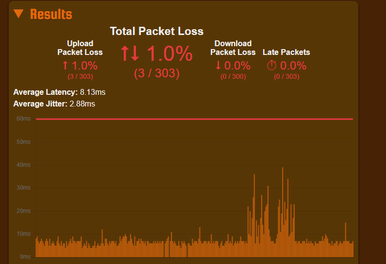

  21. It spikes up to 15-20% packet loss sometimes, i dont play casually, i play competitively so this is a big deal for me, this is just a website i found online by Looking up "fortnite packet loss test" but my main source os measurement is in game stats whjere every second i am getting packet loss it is NEVER on 0 i usually get 4% -5% rarely under 3 and sometimes over 10. Nothing is happening on the network, I am the only one connected to it. Media bridge mode is when traffic is directly forwarded to the xr, the extender doesn't create a separate network. Yes my setup is ee router, xr1000, asus extender via bridge mode, then pc by Ethernet. The extender is connected to xr via wifi 6. I have put the xr1000 in dmz mode on the EE. Most of my devices are connected to EE router so xr is not congested. i pay for 300 up and 45 down, i have set those speeds on my router, i have set up congestion control that is working fine. i dont touch bandwith allocation as i had some problems with that in the past
